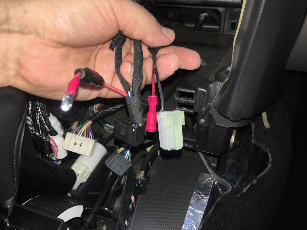

06RTCharger Posted June 16, 2018 Author Report Posted June 16, 2018 Went with ur idea @Broke_Audio_Addict Because i dont wanna wait for a new pac. Removed the PAC completly. Just the headunit is wired, only wire i had to splice into was for the ACC signal. Checked my ciglighter with the dmm to see if its constant or switched, its switched so i just tied the headunits redwire into the positive wire of that plug. Worked like a charm. Just gonna run it like that for now till i can get a replacement and talk to pac to figure out what went wrong and assure me i wire the next module correctly.
06RTCharger Posted June 16, 2018 Author Report Posted June 16, 2018 Just used some bullet connectors for this temporary connection. Also not gonna use that ciglighter so im not concerned with that plug. Theres another outlet in the middle console and thats what i use if i need a power outlet. Becuase its constant, not switched power.
