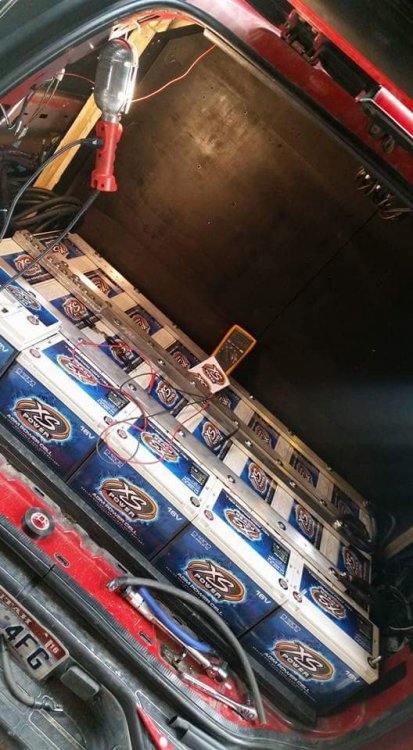

Working on getting my brother's Civic hooked up.  Not sure if the am is going to fit end to end between those hinges mounted vertical which was rather my plan, but I don't think he cares about trunk space here.
I had run some wire from the trunk to the front with the intent of setting up a voltage display up there.  He never ordered one when we did the build and now that we finally got one I can't remember where I left the front end of it so I'll need to do some digging.
Hopefully I have time to wire this all up and mount the amps this weekend.   Winter is coming quick; short days and very soon to be uncomfortable temperatures for working outside.
