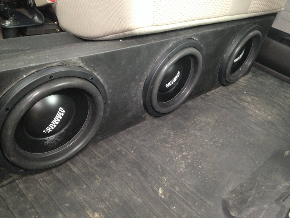

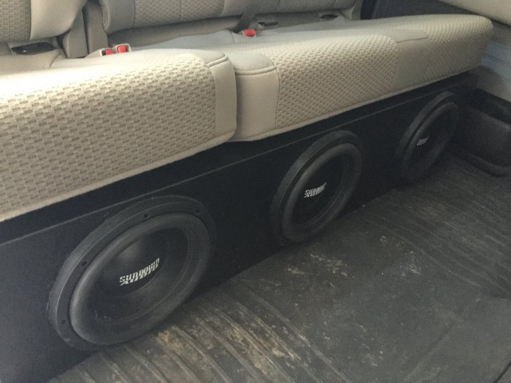

Sundown SA 10’s dual 4ohm, got 3right now in a sealed box thinking about trying 2 ported to take a load of my ALT . My box slams now just thought about trying ported . Max space is 57wide 11deep and frt side 11 to 8inches to rear.
That’s the box now wanted to try ported to see the sound difference. Got pretty much all the supplies laying around but don’t want to waste my time if it’s not worth it. Also got 2 round ports laying around a 4inch by 22 and 6inch by 24

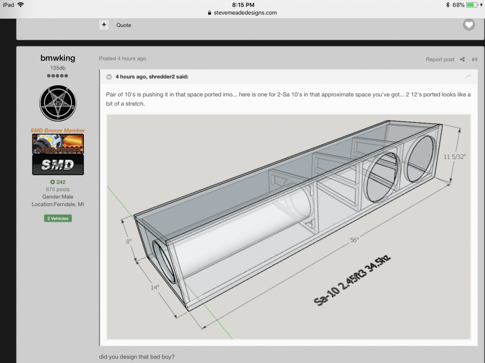

Wanted to kinda steal this idea
I love it but it’s to deep , that box got me horny to try to make it work. Because the box is so small I thought 1/2 might be ok with good bracing to keep flex down or maybe it will just blow apart.
Provide some type of diagram side plan showing what will fit in your vehicle and someone might come up with something... 57" wide huh?

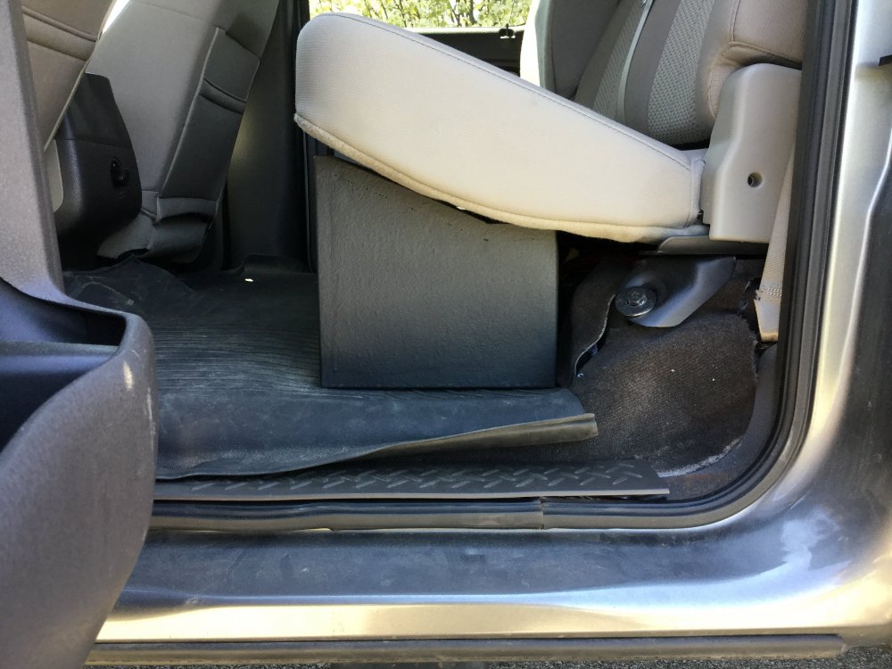

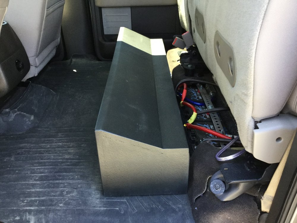

Here are some pics of the sealed box , the new one would have to match but be wider  11inches down to 8 ,depth is also 11inches
