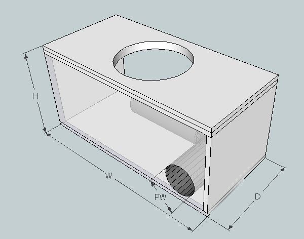

Joe X Posted October 1, 2018 Report Posted October 1, 2018 7 hours ago, Kraken said: Do you think its possible to get 3.5 cubes net with a 8 or 10 inch aeroport tuned to 34-36hz? I dont care about the port coming out of the box some. You can do that, just to give you a quick idea, sub up / port to the side or back if you use an elbow, no need for an partially external port, keep port clearance 8": Enclosure Specifications: Fb = 35 Hz Vb = 3.5 ft^3 External Height = 19 in External Width = 32 in External Depth = 17 in Cut Sheet List: * All Dimensions in Inches. * Wood Thickness is 3/4 for all Parts. External Enclosure Parts: 2 x Top & Bottom (3 parts) = 32 x 17 Left & Right Sides = 15 1/2 x 16 3/4 Front & Back = 32 x 16 3/4 Port Quantity and Dimensions: Number of Ports = 1 Pipe Port Diameter = 8 Pipe Port Length = 25 1/4 Port airspeed @ 3000W would be 26.7 m/s for a 8" round port, if you think you can run that kind of power in a truly safe manner.
Kraken Posted October 2, 2018 Author Report Posted October 2, 2018 3 hours ago, Joe X said: You can do that, just to give you a quick idea, sub up / port to the side or back if you use an elbow, no need for an partially external port, keep port clearance 8": Enclosure Specifications: Fb = 35 Hz Vb = 3.5 ft^3 External Height = 17 in External Width = 35.75 in External Depth = 17 in Cut Sheet List: * All Dimensions in Inches. * Wood Thickness is 3/4 for all Parts. External Enclosure Parts: 2 x Top & Bottom (3 parts) = 35 3/4 x 17 Left & Right Sides = 15 1/2 x 14 3/4 Front & Back = 35 3/4 x 14 3/4 Port Quantity and Dimensions: Number of Ports = 1 Pipe Port Diameter = 8 Pipe Port Length = 25 3/4 Port airspeed @ 3000W would be 26.7 m/s for a 8" round port, if you think you can run that kind of power in a truly safe manner. How would the port mount in this box? Being 25.75 inches long, and the box only 35.75, is that 10 inches enough to clear the motor of the sub? Alpine cde143bt/ Alpine ktp445u (4x45 amp) 2 Crescendo STS 1 (on alpine 4x45 on 2 channel mode) 4 Crescendo pwx 6.5's in front doors (Skar RP150.4) 1 Sundown zv3 12, SAE1500D. Box is 2.5 cubes tuned to 30hz.
Joe X Posted October 2, 2018 Report Posted October 2, 2018 Modified the above an added a figure, this is only an idea of what could be done, by no means finished.
