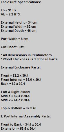

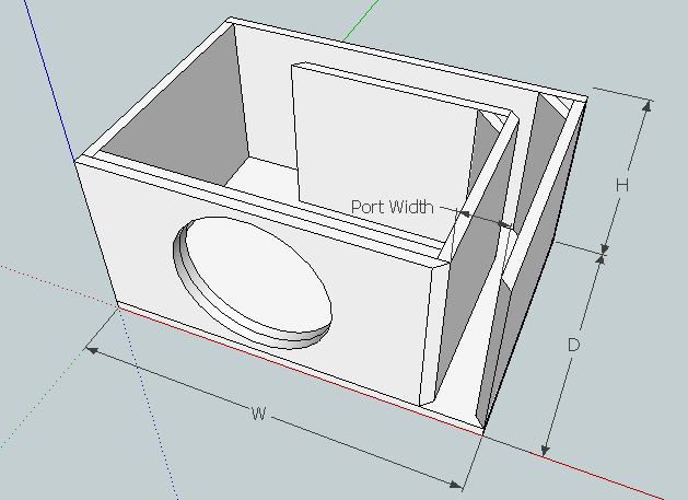

Joe X Posted October 5, 2018 Report Posted October 5, 2018 So here's something I'm sure will get you better results, box dimensions are similar to those of your current box but you need to check. Power: to sub rated, amp subsonic filter to 26Hz, minimum port clearance 8 cm, figure is just an assembly guide: NOTE: If building outside you need to build a cardboard dummy box to test fit in it's way inside.
AlexanderLeet Posted October 5, 2018 Author Report Posted October 5, 2018 Thank you, mate! I will try this enclosure. Hope it’ll do it. One question: low freq. bass takes much more voltage/amperage? Cause when lows are hitting my headlights are dimming...so it means I don’t have enough power. I planned to get another battery anyway so I hope it will do the trick...

slowfkncar Posted October 5, 2018 Report Posted October 5, 2018 16 hours ago, AlexanderLeet said: Port width is 4.7”, I’m from Europe (Romania) so I have a Ford Focus 2 sedan (I uploaded a pic). https://imgur.com/a/E514oLA I don’t know if I measured properly but I will write down in inches, so: Width - 4.7” / height - 12” / depth - 17.5” https://imgur.com/a/Rs4Zgpk So a bigger enclosure with a smaller port will do it? that box is tuned in the 50's with a shit load of port area, stay away from that guy! You should be happy with the design joe posted.
