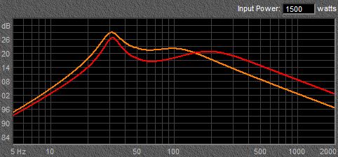

Joe X Posted October 20, 2018 Report Posted October 20, 2018 The 4 E8s should outperform the single E12 in their respective recommended enclosure sizes so 3 net for the E8s, 2 net for the U12 on the same power: * orange plot is for the 4 E8s, red for the single U12. One thing to bear in mind is which option you could overpower the most and what's your maximum box size

Joe X Posted October 20, 2018 Report Posted October 20, 2018 A single U15 would use the same 3 net and would outperform the 4 E8s.
