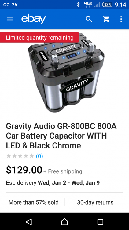

ehall8702 Posted December 29, 2018 Report Posted December 29, 2018 Currently have 2 powerchair batteries and am about ready to upgrade em. Also was.thinking about a big cap since even with 2 extra batteries I get light dim. Should I add a cap to my batteries or get a battery with a cap built in? Saw this one and was looking.for information about.it 2009 Silverado 1500, 7.5" lift, 37x12.50r17s, Built Gen 4 5.3L ( 4.8l flat pistons, decked 243s, SS2 Cam, Pac 1218 springs, ported intake, 120mm TB, Long tubes, 3" duals HP tuner software tuned by me), 4l80e swapped and 4.56 gears. All done by me. stereo is Pioneer avh 600ex, all stinger rca, jp23 v1.5, skar rp150.4, and hertz hpd4. 2 SHCA 6.5 8ohm, 1 SHCA 3.5", and 1 DS18 tw120pro in each door. The 3.5 mid and 3.5" tweeters are powered by the skar rp150.4, the 6.5s are powered by the hertz bridged @4 ohms. Dual runs of 3/0 welding cable, 300a alternator, 2 Vmax AGMs up front. current sub is a AB XR 12 ( dual 2 ohm) with bottom spider cut out in 2.25 cubes at 32hz
bmwking Posted December 29, 2018 Report Posted December 29, 2018 youre pretty much gonna get light dim no matter what. even when running HO alts and multiple batteries. lights are very sensitive to voltage drop. to combat this, the easy and cheap way (as long as your voltage is staying strong ), is replace dash lights and exterior lights with LEDs. LED headlights pretty much eliminate dimming, HIDs completely do. Changing your dash lights for LEDs is pretty simple, there are plenty of guides out there to help too. avoid caps. batteries will out perform them any time. unless youre running a big bank of maxwell caps or something that actually works.
bmwking Posted December 29, 2018 Report Posted December 29, 2018 ps that cap you have pictured is just a cap, not a battery. also, it has pretty horrible reviews: https://www.amazon.com/d/Automotive-Parts-Accessories/GRAVITY-800-BATTERY-CAPACITOR-GR-800BC/B00EUFCHR0 what's your battery budget?

ehall8702 Posted December 29, 2018 Author Report Posted December 29, 2018 I have leds both high and low beams, low beams flicker a bit, dash lights dim a little too, lowest volt drop I've seen is 12.7 with a long beat, I've never been a fan of caps, just was wondering about newer ones. I may grab a pair of group 28 interstate agms since I can get em at cost at work ( close to $130 a piece). Just kind if checking my.options. Was also thinking maybe 4 of these kinetic batteries also I got the room but am unsure of what wattage battery I need or if 4 of this size is better than 2 of the next size up of these batteries. I'm running right about 2800 rms, just ordered CAB 1/0 and will be doing double runs on everything (big 4, front to back, and only single run to my two front stage amps, will be double runs to my sub amp). My 140a alt seems to be holding tough so going to save for a big singer or mechman alt soon. 2009 Silverado 1500, 7.5" lift, 37x12.50r17s, Built Gen 4 5.3L ( 4.8l flat pistons, decked 243s, SS2 Cam, Pac 1218 springs, ported intake, 120mm TB, Long tubes, 3" duals HP tuner software tuned by me), 4l80e swapped and 4.56 gears. All done by me. stereo is Pioneer avh 600ex, all stinger rca, jp23 v1.5, skar rp150.4, and hertz hpd4. 2 SHCA 6.5 8ohm, 1 SHCA 3.5", and 1 DS18 tw120pro in each door. The 3.5 mid and 3.5" tweeters are powered by the skar rp150.4, the 6.5s are powered by the hertz bridged @4 ohms. Dual runs of 3/0 welding cable, 300a alternator, 2 Vmax AGMs up front. current sub is a AB XR 12 ( dual 2 ohm) with bottom spider cut out in 2.25 cubes at 32hz
