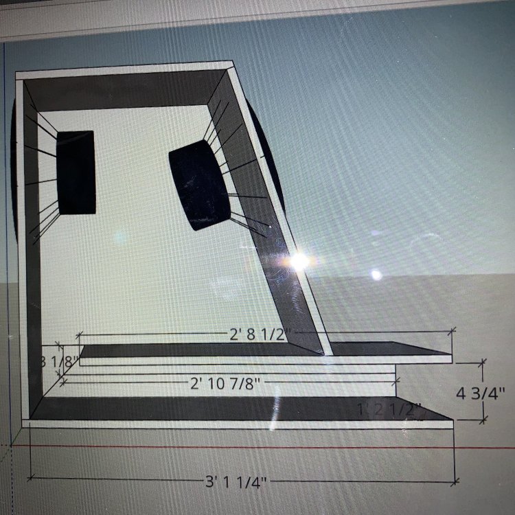

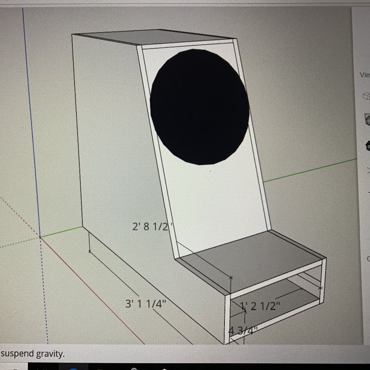

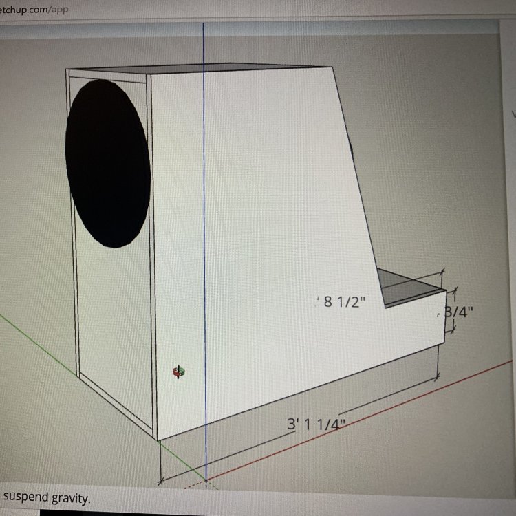

Heres what the plan i made looks like. Used the free sketchup 2018 online app, this is a test box to find how my truck responds to subs.

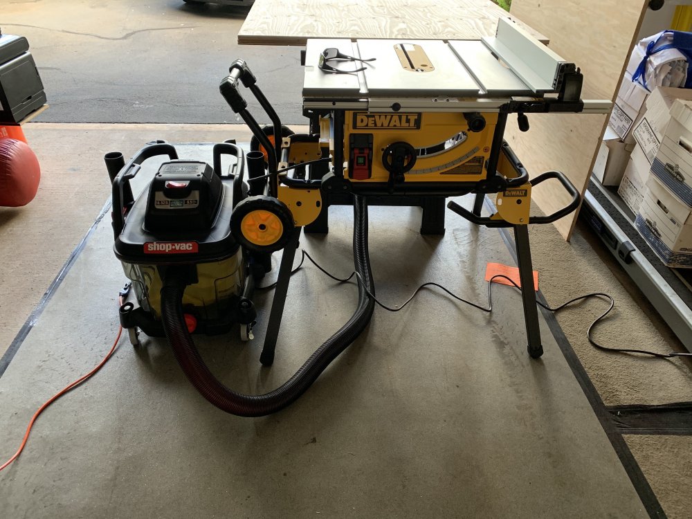

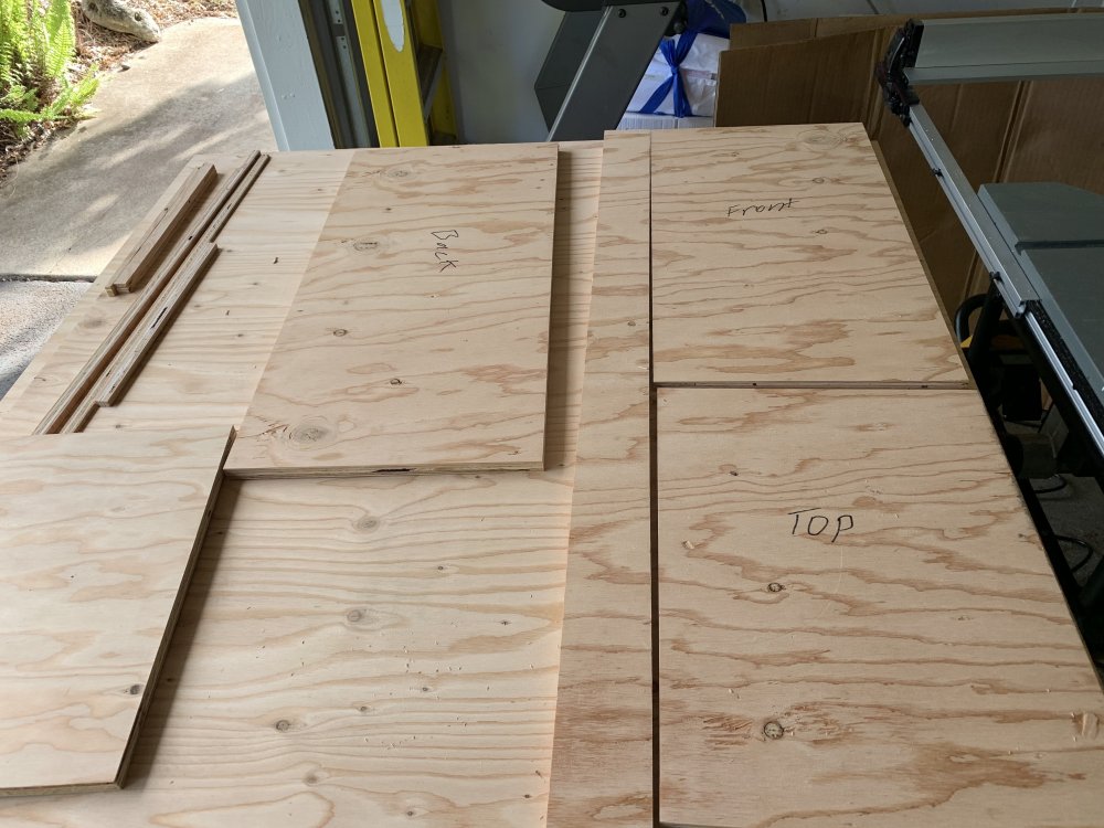

Had to pull the Charger out the garage so i can set up a work area. Got some saw horses and layed my sheets of plywood on it to use as a backfeed support type of thing. So u can push the wood across the saw without it falling off the back end of the table saw.
Also got a new shop vac with more power and bugger tank and bigger hoses 2.5 inch so it fits on tablesaws dust port.

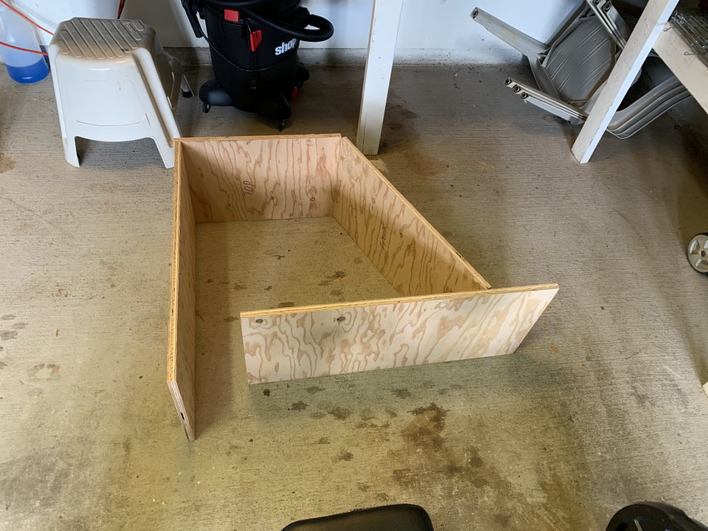

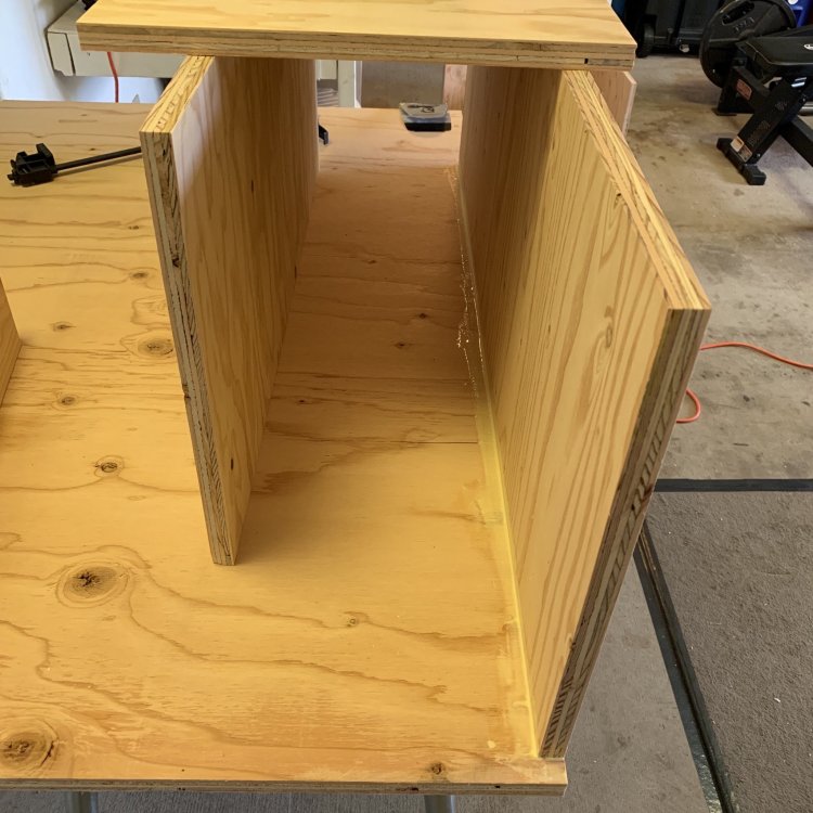

Started glueing. Gonna pause here and go cut out the sub holes with my Jasper Jig. Feelin stoked! Im soooo close to hearing some BAAAAASS! Cant wait, hopefully by tomorrow. Or maybe tonight lol depends how impatient i get.

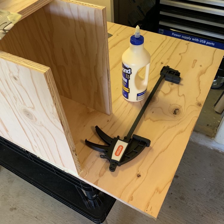

My clamps are too short, where do yall get ur clamps at? Any good online ones? Also looking for like a 90degree clamp type thing?

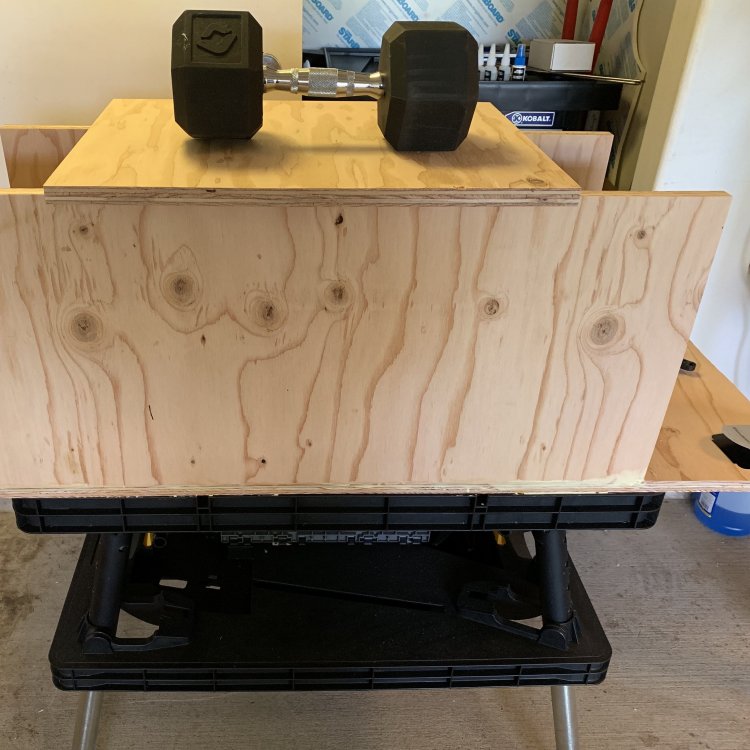

So i used so pieces that had the same width as that bottom peice i glued and put a board with a dumbbell on it to put some pressure on it.
Kinna sucks the wood was slightly bowed, tried manually bending it straight but it didnt work. Fk  it, its good enough for the test box. My baltic birch should be better, hopefully.
