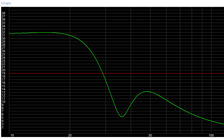

Below the tuning frequency of a ported box, it loses it ability to restrict cone movement, the sub begins to perform like it is in free air.  The larger the box is and/or the more power you run the more quickly cone excursion will increase.  If your cone moves too far bad things will happen (spiders hit top plates, coils hit back plates, etc).
Here is a graph showing the cone excursion of your subs in your box tuned to 36 Hz:
That red line is Xmax, you can exceed that by a bit, but you don't want to push it too far.  As you can see you reach Xmax a little below 30 Hz.  Your subsonic filter, if properly set, will reduce cone excursion and keep you from going way above that red line.
