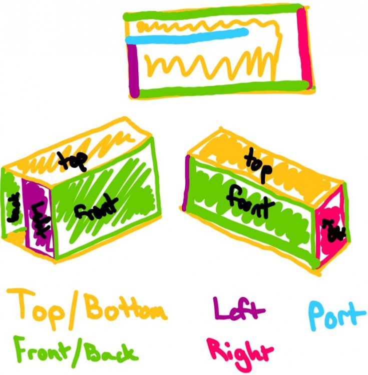

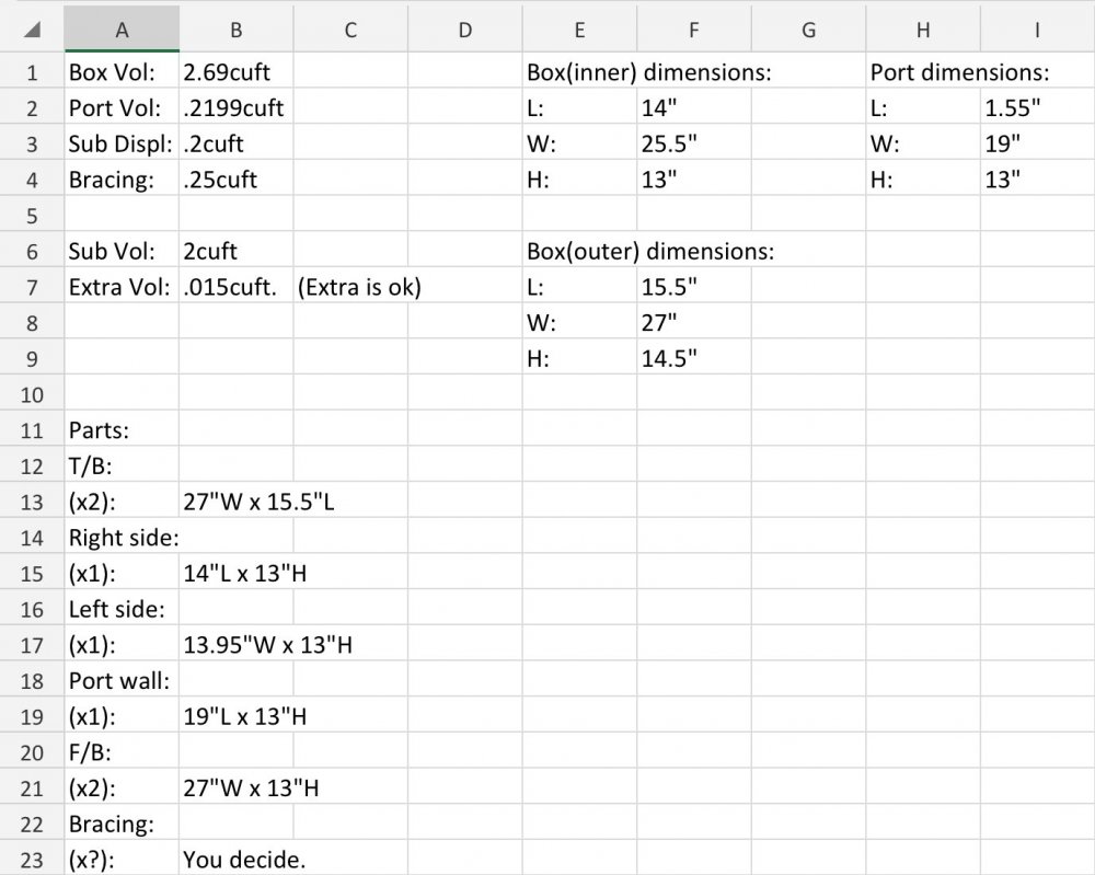

Threw this together in my head in like 10 Min. Ill show a drawn diagram.
Read below in light grey:
Seth Hardin
