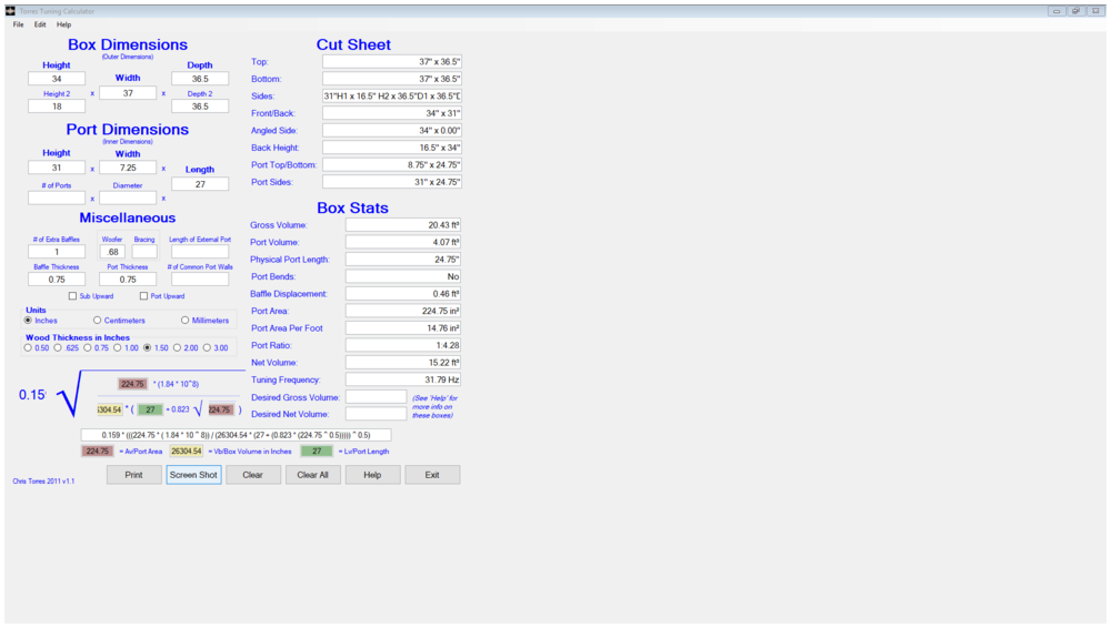

jf1984 Posted February 22, 2019 Report Posted February 22, 2019 Hello everyone. I'm looking to build a wall in the ride soon. I currently have 2 Skar ZVX V.2 12's and want to get some more oomph from the lows. I know absolutely nothing when it comes to tuning and building a box. Wondering if I could be advised by someone with good knowledge on walls in smaller cars. Maybe sell me a cut sheet design? Looking to stay around 32 hz and 4 cubes per woofer. I'm under the understanding I may have to modify the chassis to build a large box. That's fine with me. The space available before chassis modifications are Height-30 Depth-20 Width-40. That gives me 11.75 cu ft before port, sub and bracing. Now I can cut out the rear deck sheet metal to allow the rear of the box to taper along the rear windshield. Which will give me up to around 19 cubes total available. I'm probably gonna get the fifth degree for cutting the inside of the car, but all constructive criticism is welcome.
jf1984 Posted February 23, 2019 Author Report Posted February 23, 2019 I've been working on this for about 8 hours today. It's now a little after 3 am. I messed with Torres calculator, and I think I might have it figured out. Someone correct me if I did this wrong or if any of the data doesn't make any sense.

ckeeler11 Posted February 25, 2019 Report Posted February 25, 2019 4 cubes is a ton for 12's. I would look around 2,5 to maybe 3 at the most per sub. What power you running to them?
jf1984 Posted March 2, 2019 Author Report Posted March 2, 2019 I see that I left out that I have four ZVX V.2 15's. Wow, can't believe I left that out haha. Spec sheet calls for 4 cubes per woofer. I'll be running 2 rp3500s not strapped, 2 woofers per amp. Picked up my alts earlier. The 12s are in a 6 cu ft box currently. Sounds great. Just looking to go to the next level. I mustered up a cut sheet list from an online cut sheet optimizer. Have to piece everything together, section by section in order to maximize box volume. Problem I'm facing is- port length, and tuning. The box isn't perfectly square from baffle area to rear of box. 51 inches wide, 33 inches tall, to about 14 inches deep. And then the box has to taper inward towards the center of the box on all 4 sides. After 14 inches deep- width goes to 37 inches wide, 20 inches tall at the back window. And however deep I need to achieve the specific volume before calculated port volume, sub displacement etc.

jf1984 Posted March 2, 2019 Author Report Posted March 2, 2019 Looks like there's going to be some math involved here. I'm going to have to take in account the port itself is going to shrink, the further inside the box. So, where I'm losing port area in the rear of the box, I can make up in the front. By making the port larger, width times height. So in Torres, for instance, 28 high by 15 wide gives me a port area of 420 sq in. Assuming the entire port is 28x15 for its entire length. BUT the port will taper in HEIGHT as it goes inside the box. Trit's port calc is showing I need 283 sq in total. Does it matter what shape the port is as long as the port walls run parallel? If it doesn't matter, then I'm good to go. Just have to build the box and pay major attention to the baffle/port region. I am in no hurry to complete this. Measure twice, cut once.
