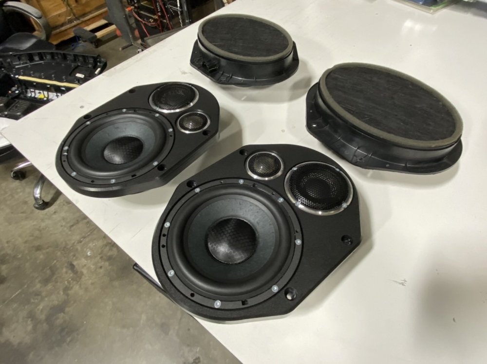

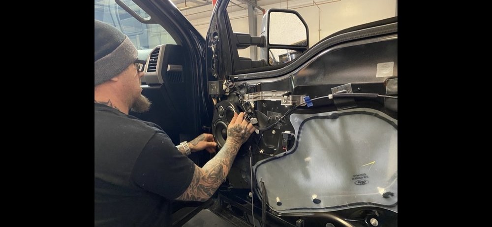

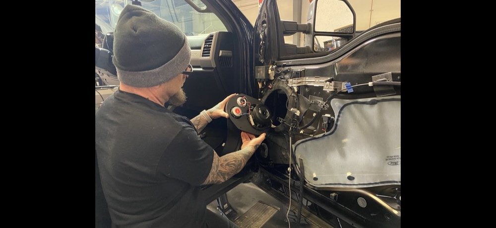

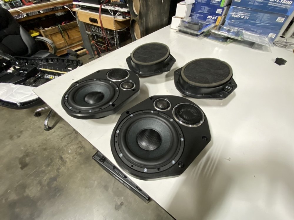

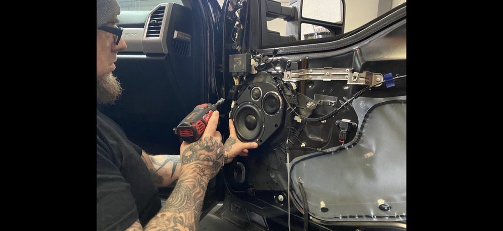

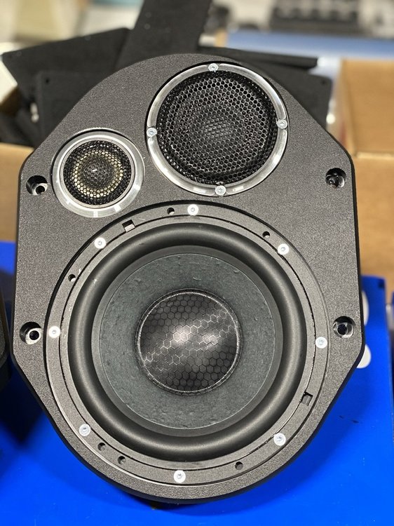

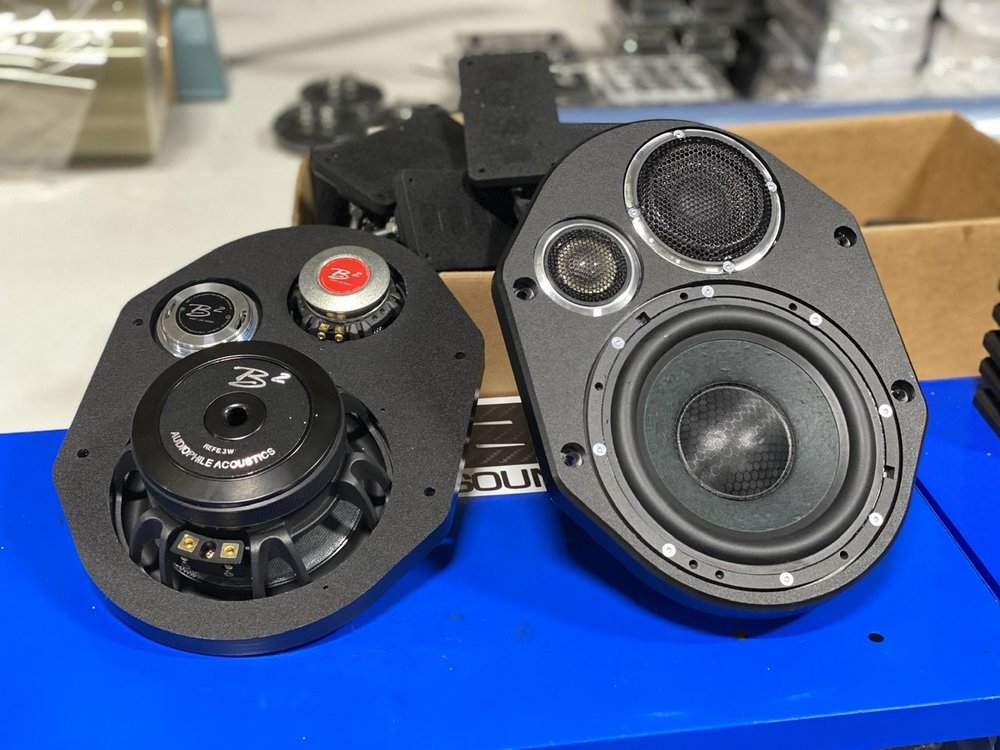

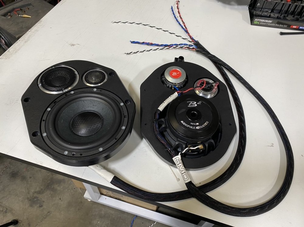

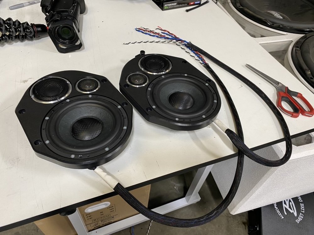

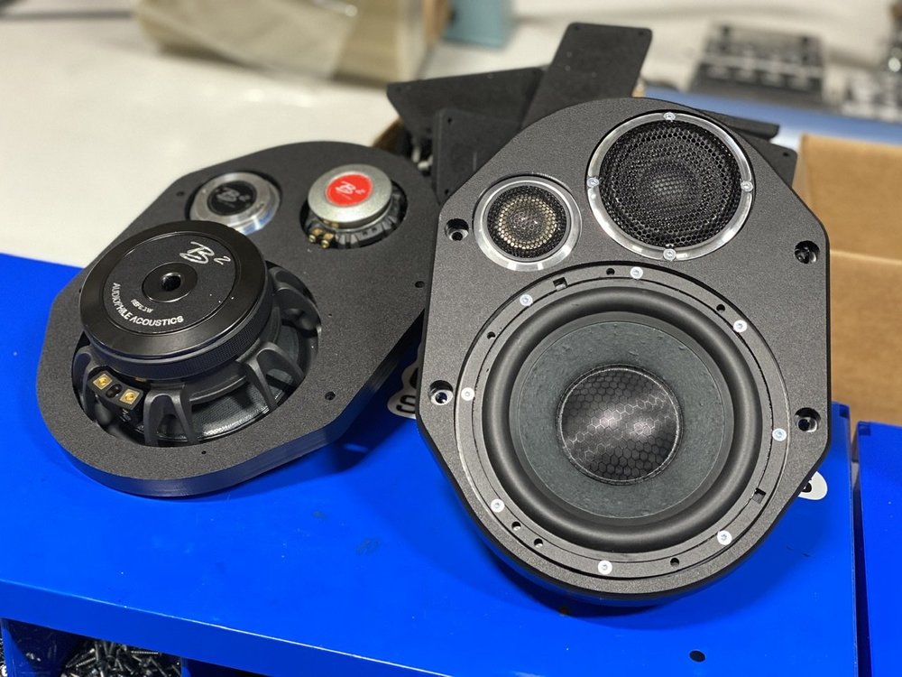

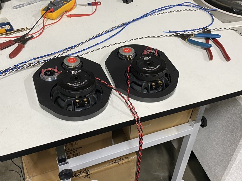

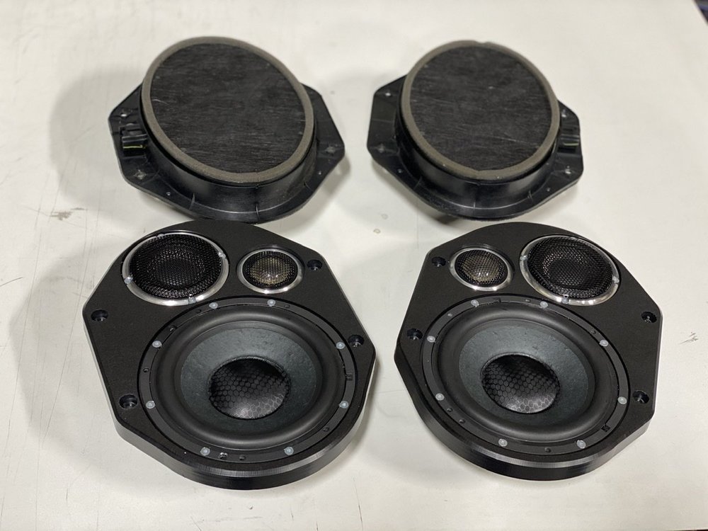

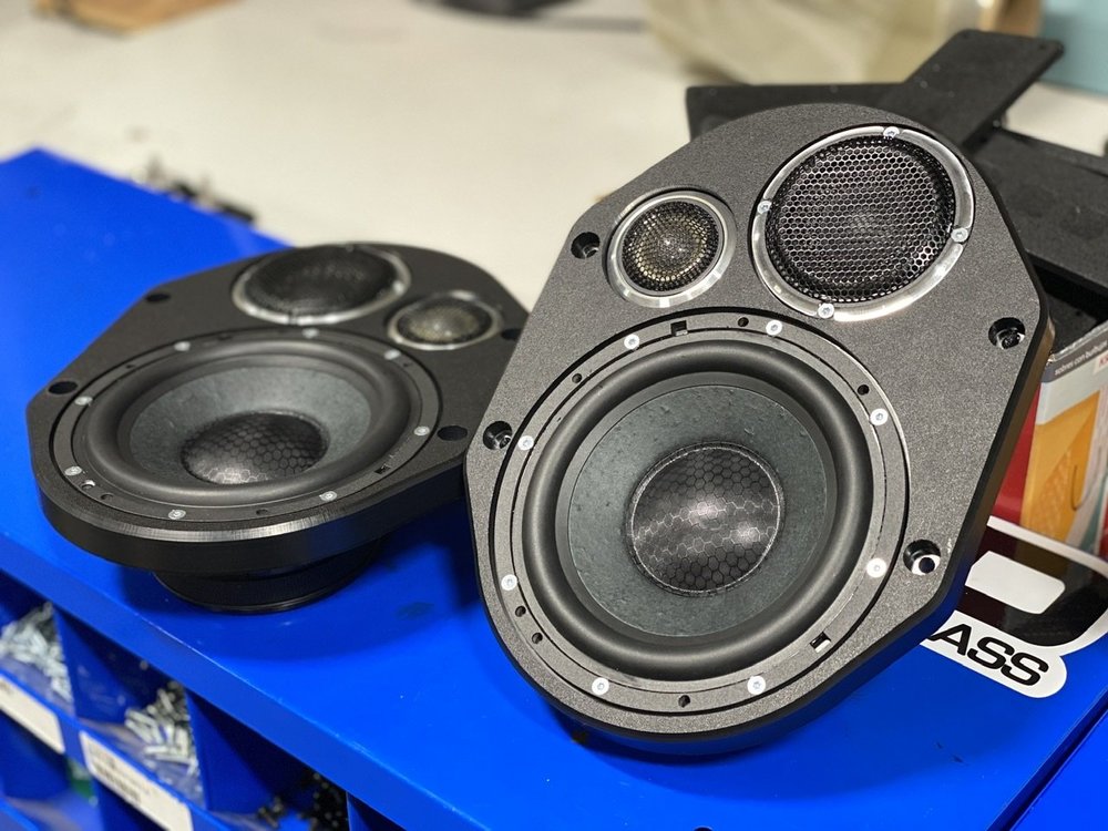

time to mount them into the adapter plate and then wire them up.
The only thing i had that would fit the small holes, especially on the mid, was some small torx screws.  They have a tapered head on them and didn't look very good going onto a flat surface. So i beveled each hole so the screws would sit flush. Now i like them! other than they are not black. But they are flush at least. (i show it in the upcoming youtube video).

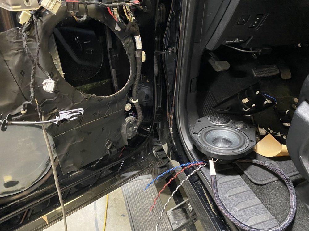

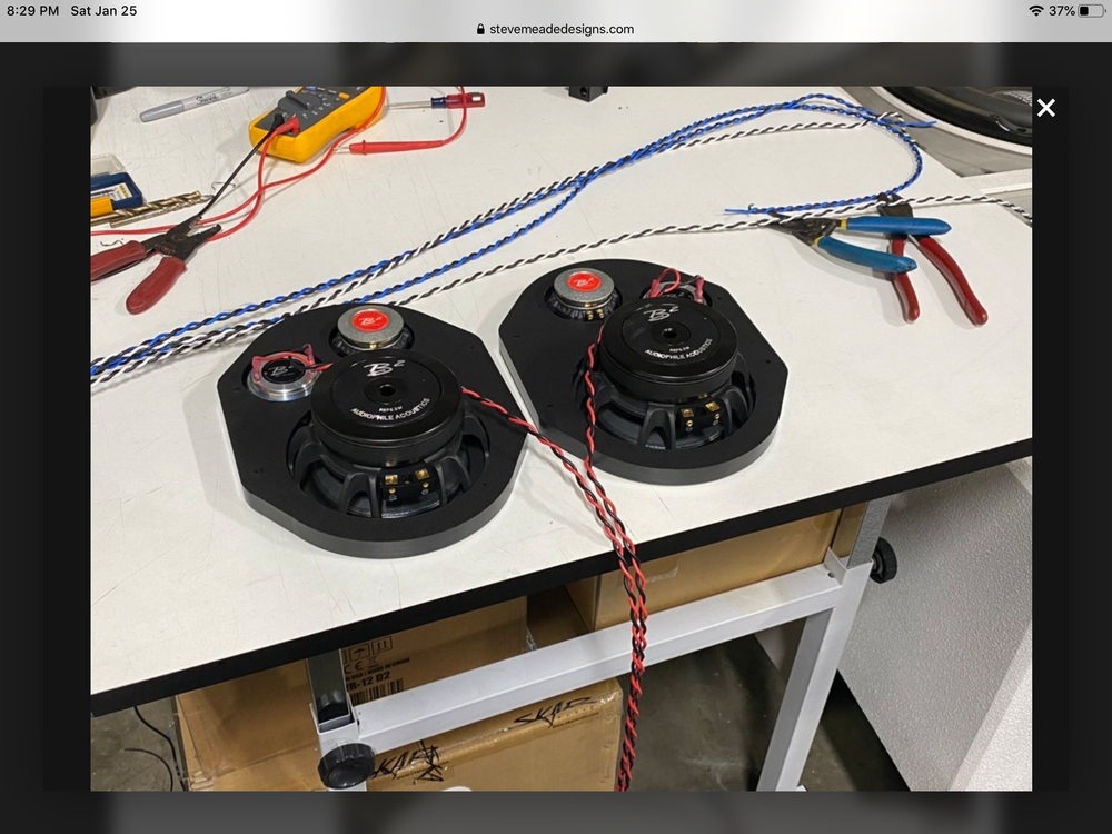

i found a nice little spot for the passive Xover.  I had to make a platform for it to sit on so i could screw it down and not send screws through the panel.  I showed it in the video but i didn't get much pics of it.  I was just trying to make it work.
Follow my Tweet (Twitter)

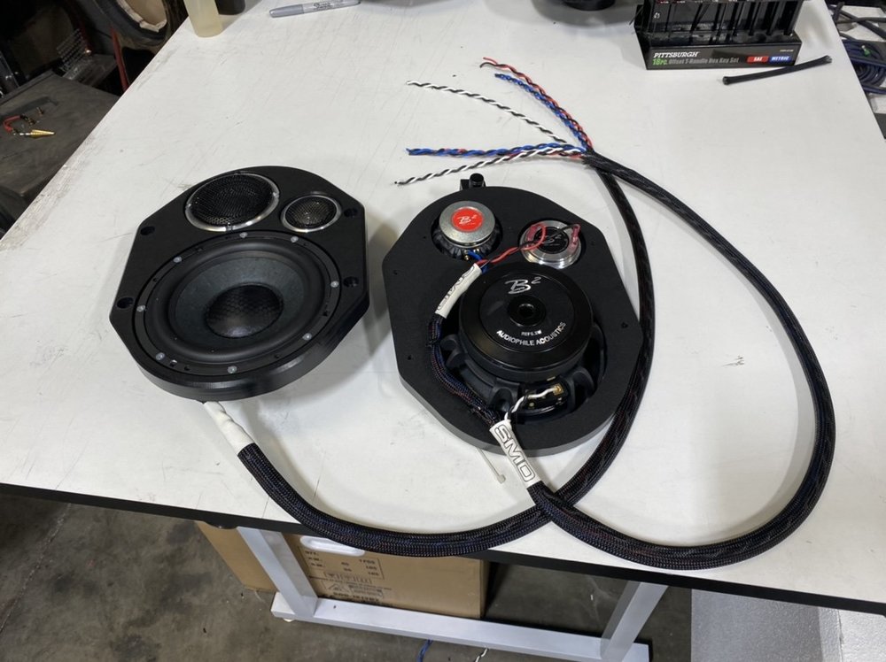

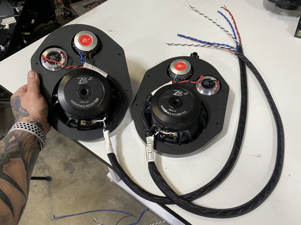

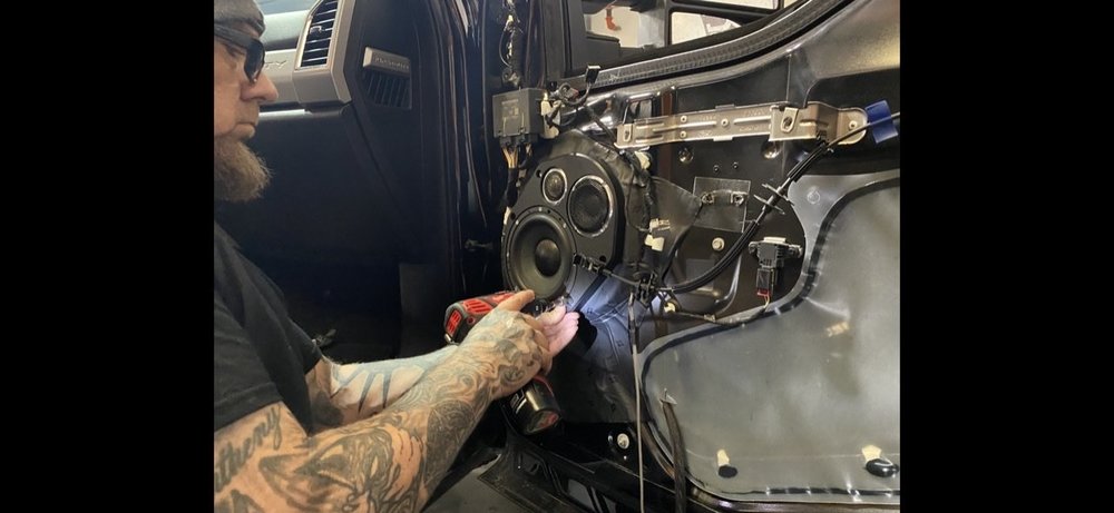

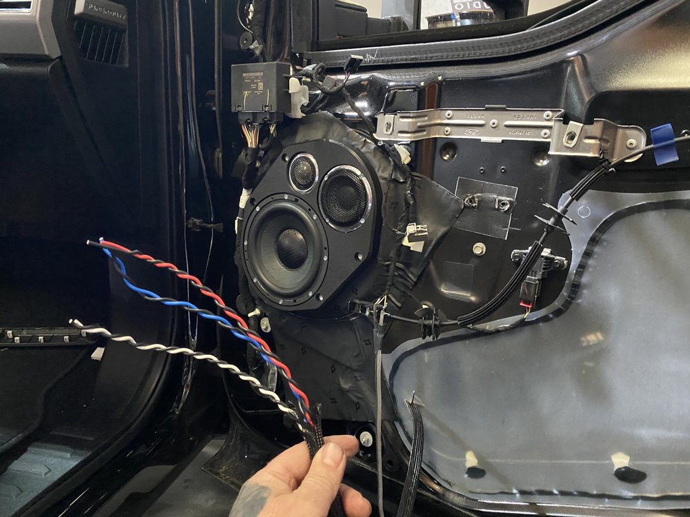

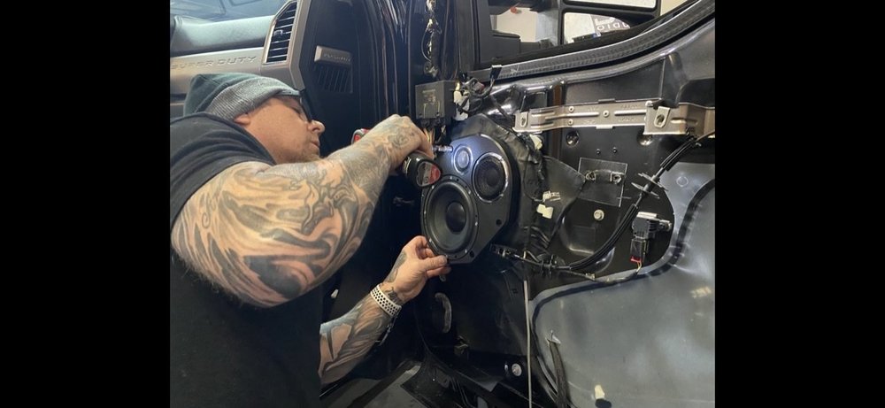

I know it has been a while but i finally got the doors started...and finished.  The system consists of:
Factory Headunit (Sony)
Pac AmpPro AP4-FD21 Interface (Using optical output)
Audiocontrol DM810 DSP (way more than i need now but expandable for later!)
B2 Audio Reference 4 Channel (Class A or AB (Switchable)) on the Mids/Highs
B2 Audio Rage 2500.1 on the Subwoofers
B2 Audio Reference 6.3 Three-Way Components (Custom Starboard HDPE Adapter Plates)
(6) B2 Audio 6.5" Subwoofers in a Gately Audio ported, under seat enclosure.
SMD Quick Release Neo Magnet Terminal (to take box out at night or when space is needed)
SMD Fuses, Fuse Blocks and Power Distritubion
Skyhigh Power Cable
SMD RCA (From DM810 to amps)
NavTV FD 360 Camera Control

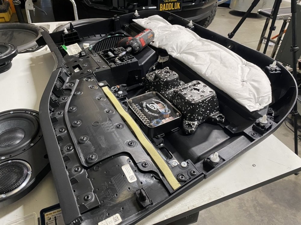

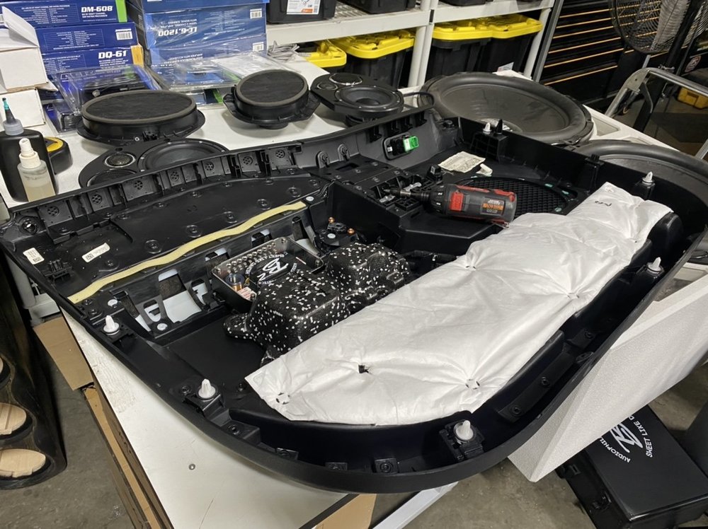

Of course there is some @Second Skin on the doors
after not listening to the truck for a day or 2, i got into it and went out with the wife.  I got a non-ear fatigued taste of how it sounds.  I LOVE IT.  These Reference 6.3's sound AWESOME!! That is STILL with no tuning other than setting the gains. Still completely flat.  I hope to analyze it and do some basic tuning to it soon. It don't need much though.
I HIGHLY recommend this set!  Even the lower, "more affordable" B2 Audio components sound great, that is why i keep using them. But these....WOW! That is all i can say.  Happy so far!
