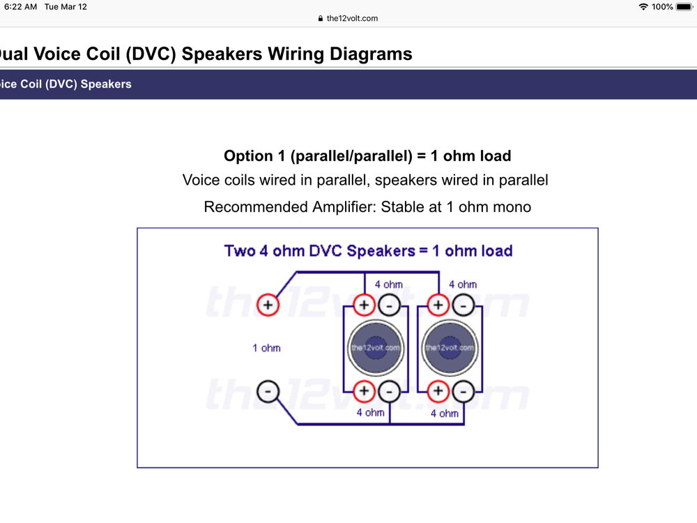

Jdub13 Posted March 2, 2019 Report Posted March 2, 2019 I have 2 15" L7 and im going off the diagram to wire them in series and then parralell them to amp to bring the back to 1 ohm , im running them on a Sundown 1500 scv. Any help on this would be appreciated.
DiBo Posted March 2, 2019 Report Posted March 2, 2019 You're not going to be able to wire 2 L7 15 to 1 ohm in series/parallel. They're either dual 2ohm or dual 4 ohm. If you series/ parallel two d2 woofers you'll be at 2 ohms at the amp. If you series/parallel two dual 4 subs you'll be at 4 ohms. If you have two d4 subs you can parallel them for a 1ohm load. All you have to do is wire all negatives and all positives together.
Jdub13 Posted March 2, 2019 Author Report Posted March 2, 2019 So to get the most out of the speakers ,how should i try to wire them paired with the amp?
