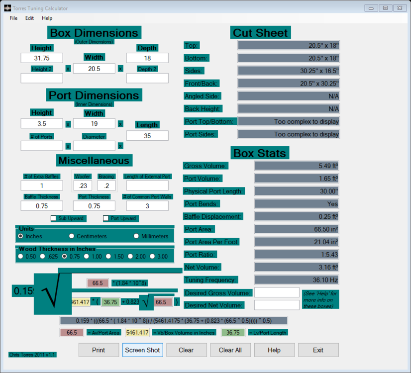

1 Built by me enclosure.  3/4" birch, double baffle, tight bond II, screws, etc.  Herculiner coated.  Stainless terminal bolts.  5.5 cubes total.  3.16 cubes after port/displacement.  3.5x19x35 port tuned to 36hz.  21 sq inches per cubic foot port area.  Box designed by me and a couple buddies with Torres and BassBox Pro 6 and modeled in Fusion 360.

Yah.  The herculiner is nice stuff.  Takes literally days to dry though.  And higher the humidity.  The faster it dries.  Yah that blew my mind when I read that.  30 bucks for a can at auto zone and it will ruffly do 2 Enclosures that size with 2 coats.  Appreciate the compliments.  My old box did a 147.3dB in the kick.  USACI at slamology last year.  The new box modeled 2.5dB more than the old box in Bass Box pro....but I only real world got half a dB more with my Spl Lab meter.  A gain is a gain though!!! My only regret is getting a dual 2ohm sub.  Should of got a dual 1ohm.  I bet even with a dual 1ohm... that amp, after impedance rise, wouldnt even be 1ohm.  🤑🤑🤑
