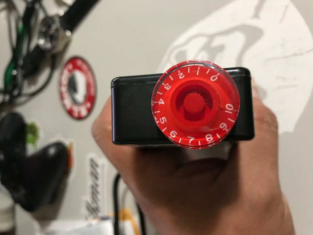

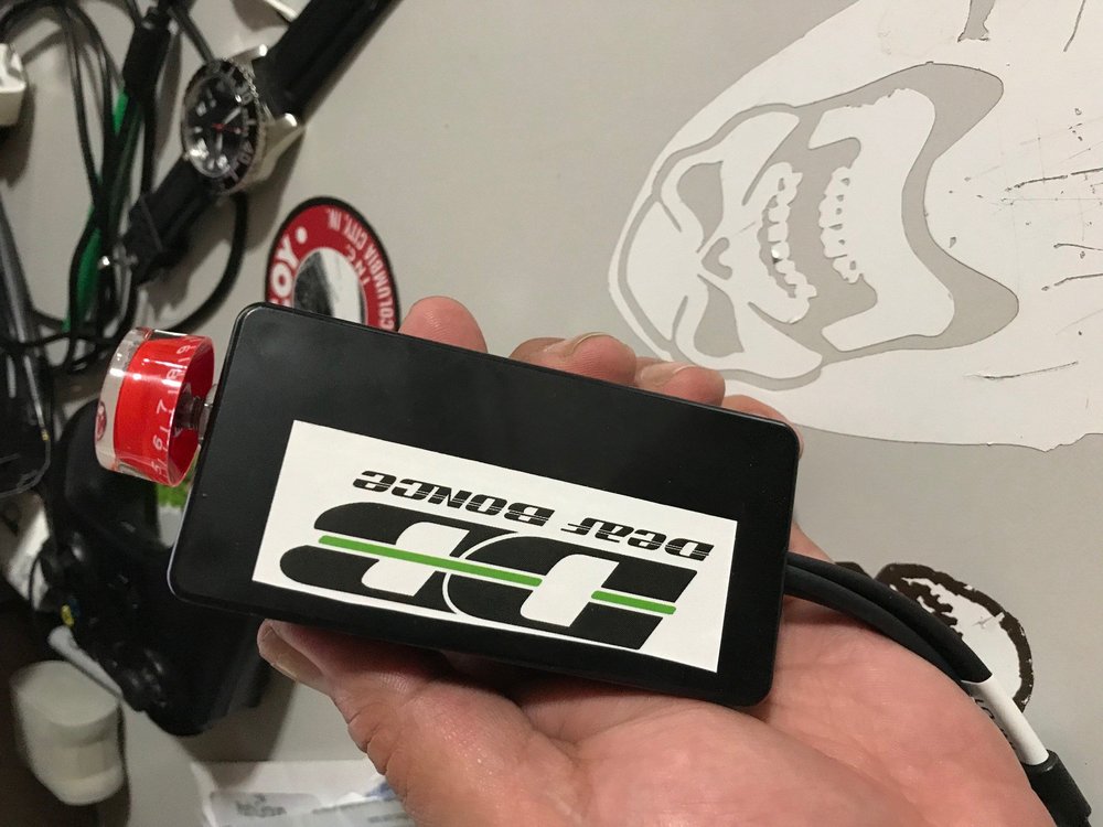

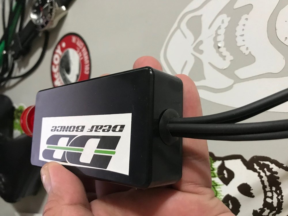

Items came in today so I did it.  I like it. Box is not the same dimensions as yours  but still fits in my hand ok. Definitely  like it better than the Pac 1 original knob housing. I put cheesy stickers  on  it  LOL

I got everything on Amazon. I just went simple black box, which was the smallest plastic one I could find on Amazon. Plastic so I could drill plastic easily. Didn't have to solder anything I just drilled the bottom hole and cut it to the lid side so I could just slide cables and grommet in. With the lid on it tightly fits and looks good.
Knobs: Any speed control knobs for LP (les paul) guitar
Box: Hammond 1591ASBK ABS Project Box Black
Universal Car Amplifier Bass Knob Control Via RCA RCA Audio Interconnect LC-1
f you decide to do it and need a red knob like the one I have I can send it to you, I don't think I have any use for the other 3 I have so If you or anybody wants just let me know.
There are lots of customization options one can do like adding leds, switches for remote, hell I may even try to add one to a funko pop figure !!
