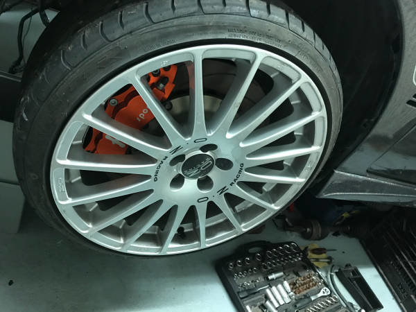

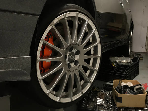

K-Sport 356 mm 8 Pot front brakes

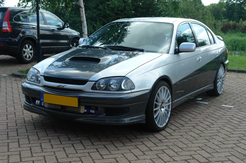

This is what the car looks like today. (Wheels are not alligned on this picture).

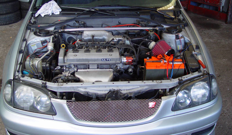

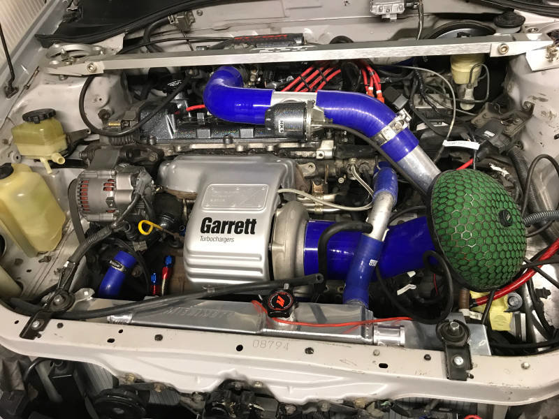

Engine Bay at the moment

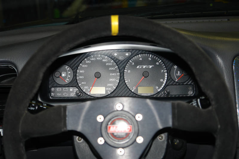

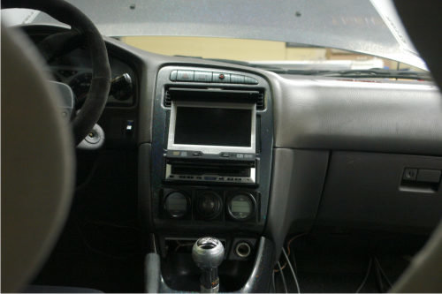

The Kenwood Head unit. Gauges under the unit are moved to the gauge cluster.

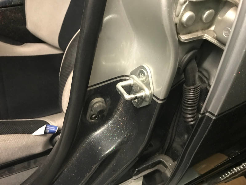

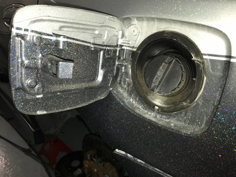

Doorjambs also painted with the 2 tone. All masking done by hand.
Filler panel inside also painted, has to be cleaned properly, there is some dust inside still after sanding and polishing the paint.

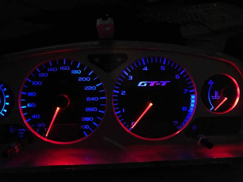

Made new dial plates, that go up to 300 km/h instead of 240, and changed the max rpm from 8 to 9 k.

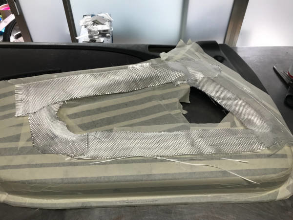

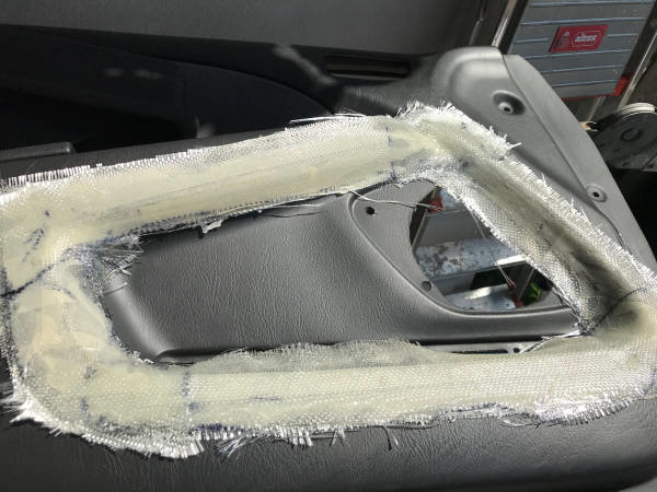

Started with fiber glass to make front door housings for the Boston Z6 speakers.

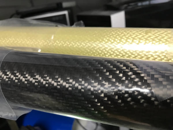

Bought Kevlar and Carbon for the outside finish of the speaker housing. I am working on the design for the speaker housings.

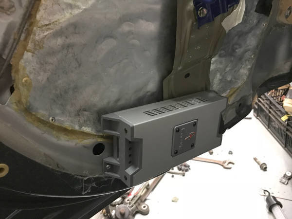

Installing the filters in the doors. There was a plastic bracket inside the doorpanel that i removed so the filter fits exactly in that spot. The filters look really good, but i decided to hide these from sight. Each filter weighs 1 kilogram.filter01.jpg.49e868d8775d9593a97262ac1b7885eb.jpg
Installed the filter on the door, i placed threaded rivet nuts in the door for easy installation and it will not rattle.

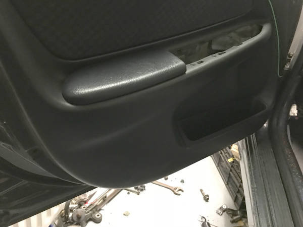

Doorpanel installed

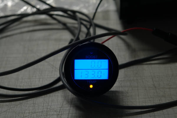

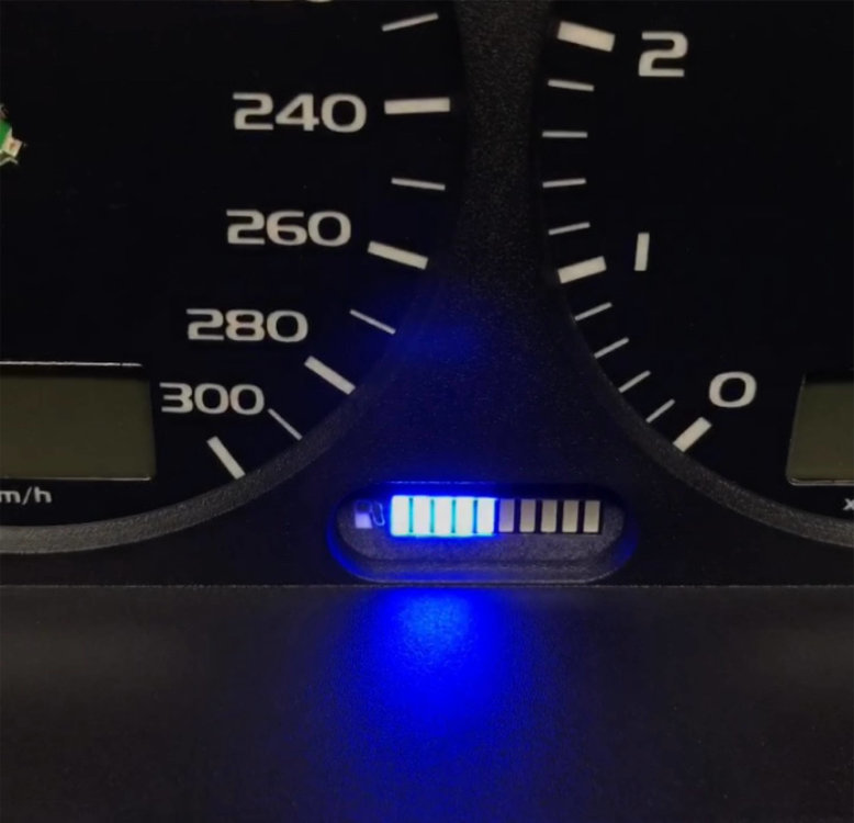

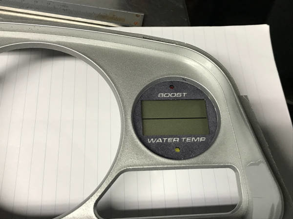

Since i need to install 2 SPA gauges in my gauge cluster the analog fuel gauge will be deleted and this one is changed to digital. I have torn apart the digital gauge and replaced the led bar on it with only blue leds. I ordered a blue one, which had an orange and red led at the lowest position, but they sent me a wrong one with green, orange and red.
The plastic housing inside my avensis did not have a hole on the bottom, but the facelift model has an opening for 2 warning lights, so i swapped this housing and put the led bar on that spot. With the original housing i am keeping an OEM look and at the same time having a custom solution.
I made an adapter plate to fit out the opening nicely with a fuel tank logo on it. This fuel tank logo is made to be lit up, but there is no led there yet. Will be done later...

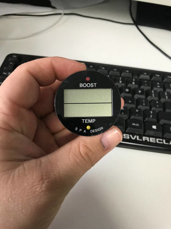

After a deep breath i finally had the guts to dismantle the SPA gauges, this is what it looks like when the housing is removed.
It took an ever deeper breath to take the dremel and start grinding at the back of the electronic board to remove the connector. This one had to go off in order to be able to make room to not hit the electronic board of the gauge cluster itself.
I could not desolder the block because there was not room for the soldering iron to fit in between the board and the lcd display.
I managed to take away the connector block to get it to fit.
Changed the face plate to grey flock with white lettering. The gauge will be installed on an angle in the final result, i can not read the LCD screen properly if i install it flat to the housing.
The digital gauge when lit up (note i made this picture on the wrong angle so lcd text was not showing properly).
