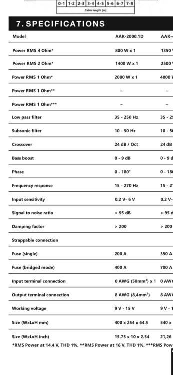

Scotnemily Posted September 8, 2019 Report Posted September 8, 2019 Hi I am trying to figure out the proper way to fuse my new amp. It has a single input but came with a dual input adapter. Here is a screenshot of the manual. it is not internally fused so the 200 amp is to protect it. My question is. When I fuse both leads, do I fuse them each with a 100 amp fuse, or a 200? Or should I just run both leads out of a 200 amp fuse? Thanks
Mike4068 Posted September 8, 2019 Report Posted September 8, 2019 Honestly, you aren't going to gain anything using that dual adapter unless you are trying to gain a tenth of a db for spl competition. If you are going to use it you can either run 100 on each or 200 before the split.

corey0928 Posted September 8, 2019 Report Posted September 8, 2019 It can't hurt using the adapter but you shouldn't need to use it. Also if you are going to fuse and the amp has a chance to draw 200A, and you fuse both wires at 100A, you might pop a fuse because you can't guarantee the current will be divided equally and both wires are exactly the same. Plus like Gunnem said, fusing protects the wire not the module.

Scotnemily Posted September 9, 2019 Author Report Posted September 9, 2019 Thanks for all of the good advice I do appreciate it! I do have a background working with car audio. It has been 20+ years though since I have done much so I will admit I am a little rusty. Mainly I wasn’t sure about rather I should split the 200 amps into 2 100 amp fuses (I am actually using a circuit breaker) or use two 200 amp fuses. I was worried that any one leg might pull over the 100 amps, but I didn’t want it to take more than 200 amps to pop since the amp manual stated 200 amps. I was just trying to go with their spec. Thanks again!
