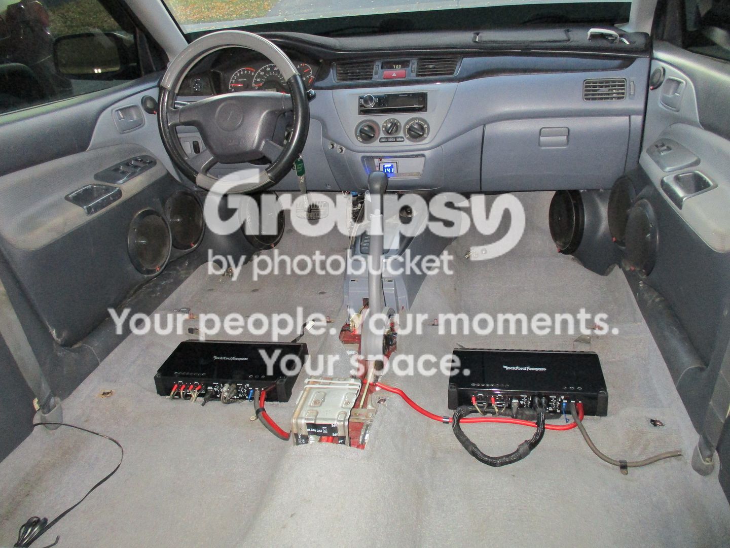

On 11/20/2019 at 5:07 PM, bcbrassard said:
Rear doors of my Lancer.
Front stage.
Mounting of 4 ch amps. Right amp runs front tweeters & rear 6.5".  Left amp runs the 2 sets of  T2 6.5" Stereo Bridged @ 2 ohms , each driver in the doors seeing about 150 watts.  2 amps in the trunk, one runs the mid-bass speaker in the kick panel. Each 8" driver is getting 350 watts. Other amp run 2 10" sub getting 1000+ watts each firing into the cab,
This is my work car and it is very dirty in this pic. It is usually much cleaner than this. I swapped these amp out from the Power series 4 channels i had in here for the Punch series & these are more powerful by at least 25 watts rms.
