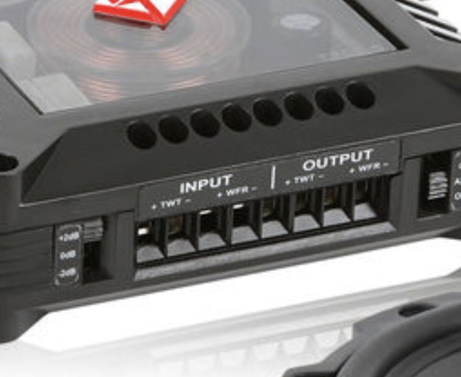

Freddboi Posted December 11, 2019 Report Posted December 11, 2019 I want to run three sets of components on each front door panel. The set that I want have outputs for both tweeter and woofer so I want 4 channels up front front right tweeter and front right woofer and same for the left side. How do I wire components together
slowfkncar Posted December 11, 2019 Report Posted December 11, 2019 If your amp can do 2 ohm stereo just run two sets off the front and one set off the rear, obviously you would need to use a set that comes with 2 way crossovers.
Freddboi Posted December 11, 2019 Author Report Posted December 11, 2019 The sets I want to run have both outputs for the tweeter and the woofer meaning they’ll have to get wired to separate channels, I want front right tweeter as one channel and and the front right mids on another channel. With 2 or 3 sets of these Rockford fosgate t2652 power series check out the picture and you’ll see what I mean

Freddboi Posted December 11, 2019 Author Report Posted December 11, 2019 I have two 4 channel amps On the T.400.4 I want the two rear speakers and two front tweeter channels ran on that and the T.600.4 have the front mids left and right bridged into two channels.

Freddboi Posted December 11, 2019 Author Report Posted December 11, 2019 So how do I wire those together since there’s 3 crossovers
MrSkippyJ Posted December 11, 2019 Report Posted December 11, 2019 Honestly I would find a 2 channel that can handle 1 ohm and keep it simple. F150: Stock 2019 Harley Road Glide: Amp: TM400Xad - 4 channel 400 watt Processor: DSR1 Fairing (Front) 6.5s -MMats PA601cx Lid (Rear) 6x9s - TMS69
