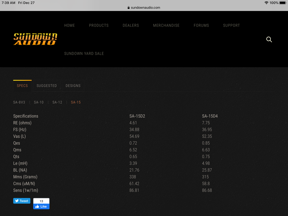

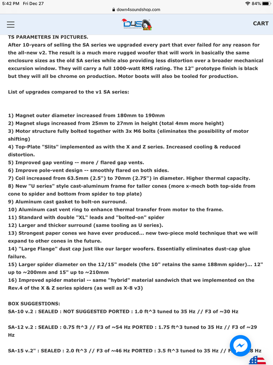

I think all of you are confused. There is sa v1 rev 1 to 3. The one I got is version 2 no revisions yet because it’s newer.
sa v1 rev 2 and 3 is rated 750w
sa v2 is rated 1000w
Down for sounds website has it

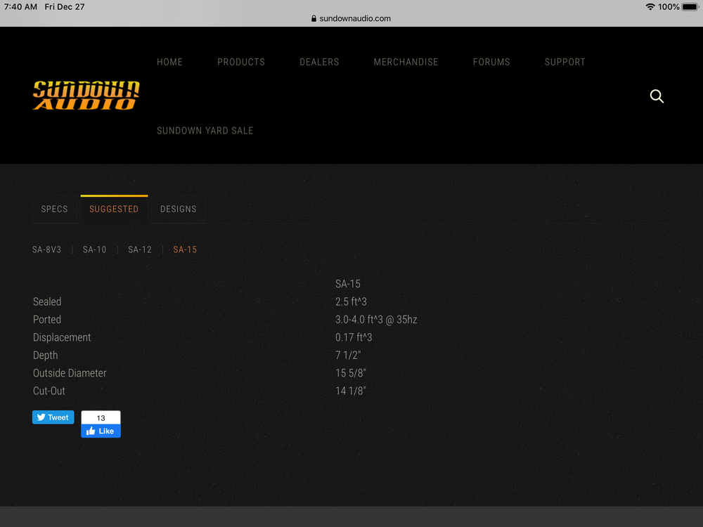

So this is good enough? I’m clueless when it come to building a box. I thought I need to input fs vas and everything else to build a box? Thanks in advance
