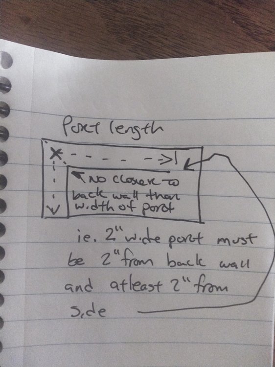

A slot port requires about same port area as a round port , think it's just aeroports u can cheat a little with cause if the flares. Slot port is very very easy. I use Torres ( pm me and I can send u .exe file via email, most links for it don't work or download u bs Instead) . Port length is easy to calculate also. Like I said I use a slot just because it requires nothing extra to buy and adds bracing at same time. Triticums port calculator says optimal slot and aero is same number ( what I sent ya the other day, can't remember now) so it's not like u r losing much, slot may take a little more displacement but about same as would a brace ya know? If you are not familiar with Torres gimme sum max measurements and I'll get ya a design if you are interested.

Thanks M8. I do have torres. Like I said I have just never done it. Probably wouldn’t be all that hard.
