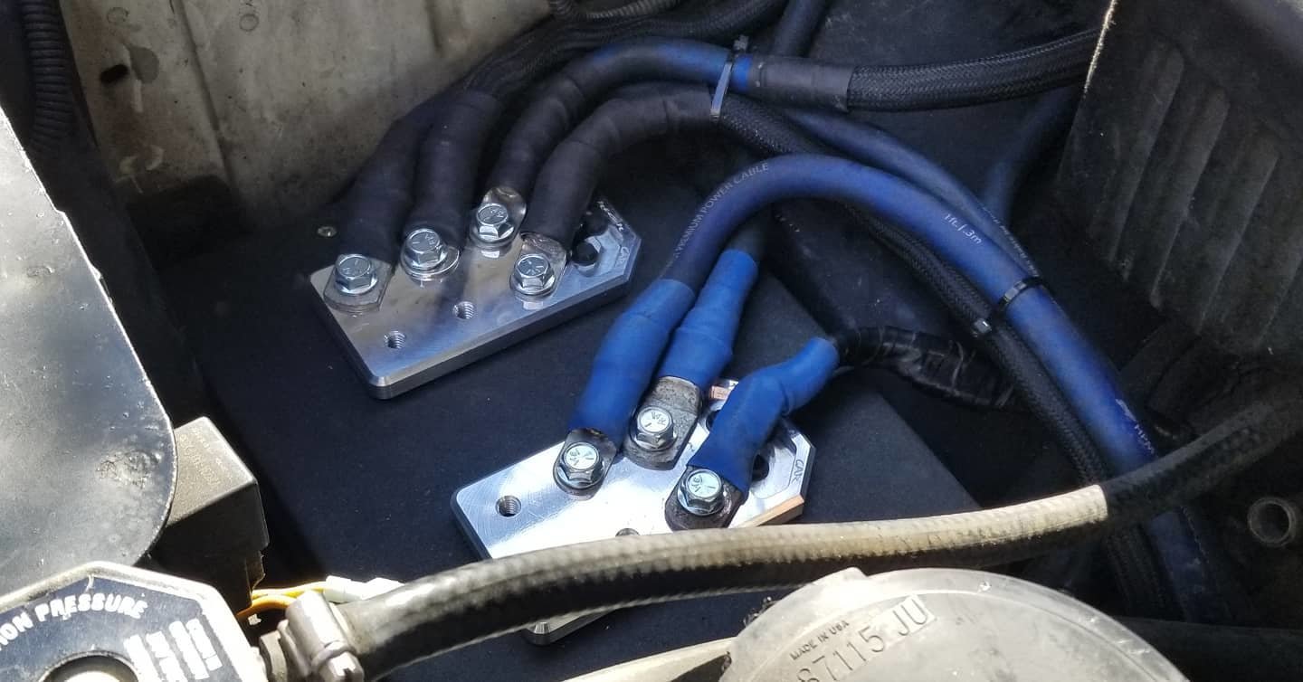

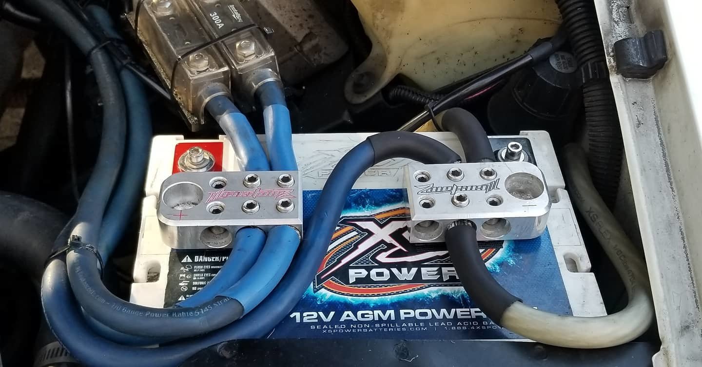

I deleted one of my front batteries and bypassed the other.  I did this by removing the distro blocks from the terminals and velcroing them down to the top of the battery itself.  That way, the AGM isn't connected, and if the lithium gets drawn down too low by some sort of freak parasitic draw, I can move the distro blocks back to the terminals and jump start the truck.

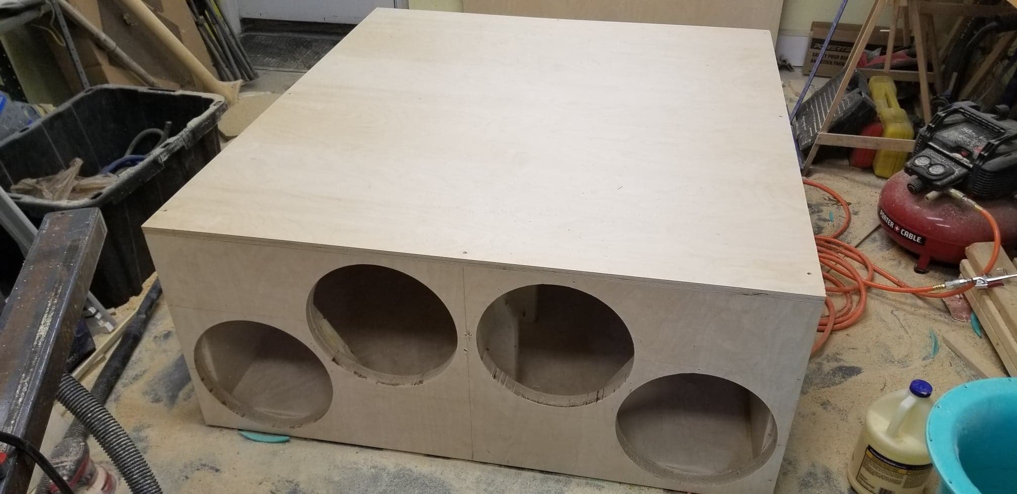

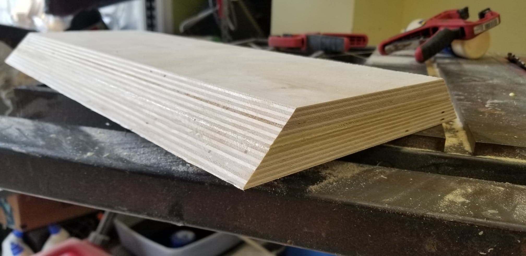

Box progress!
89773891_677314123004084_6734457240649990144_n.thumb.jpg.290721e75f6e5d561221369878db27fc.jpg
89824136_194880278621922_3242564935405797376_n.thumb.jpg.bf3c6a26c782cc8499c1f5c32c6f3602.jpg
90309565_136757057754344_4381470050465349632_n.thumb.jpg.9fd01b104c951a673ef57eed2ebc54ab.jpg
90057638_148831403022451_4282752907226382336_n.thumb.jpg.5b5e5ae407b463200f7111e51fc9ae65.jpg
89903211_616200762554494_4838400733344694272_n.thumb.jpg.e1761fc9cf455b4062faf10523dd0142.jpg
89931185_220411422487799_2937616089816760320_n.thumb.jpg.d7866a958cd641a26fad62f0773bcd61.jpg

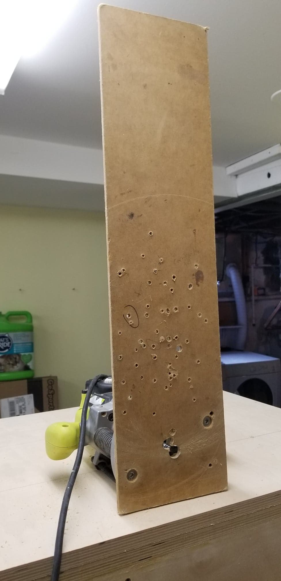

My faithful old homemade jasper jig.  Each one of those screw holes is at least one box :)

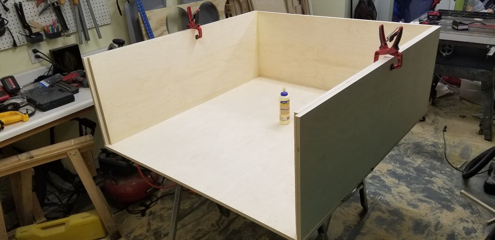

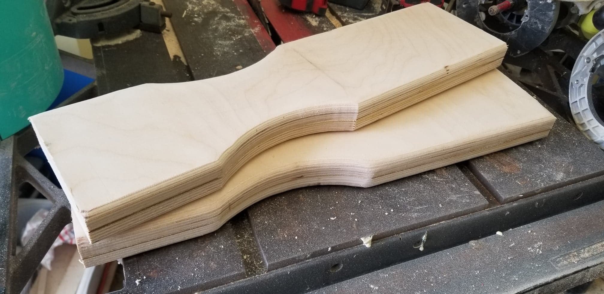

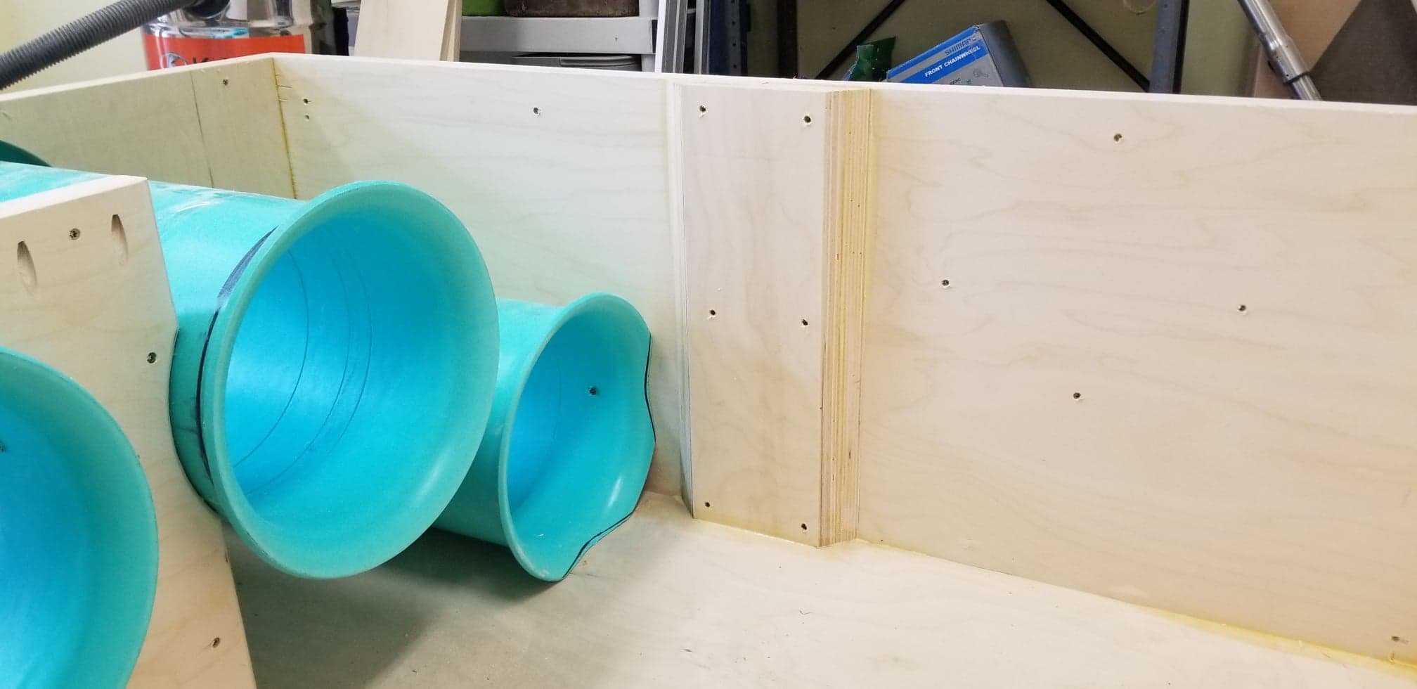

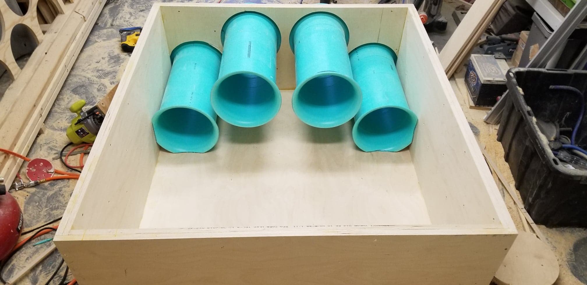

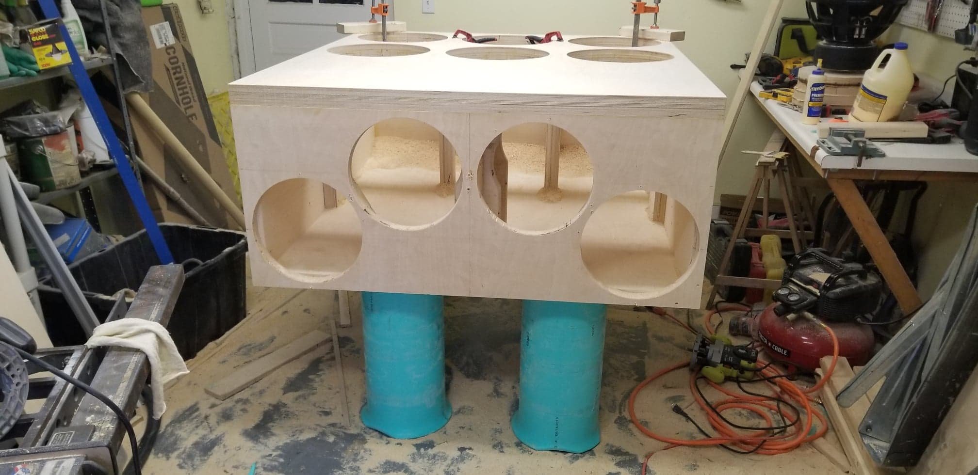

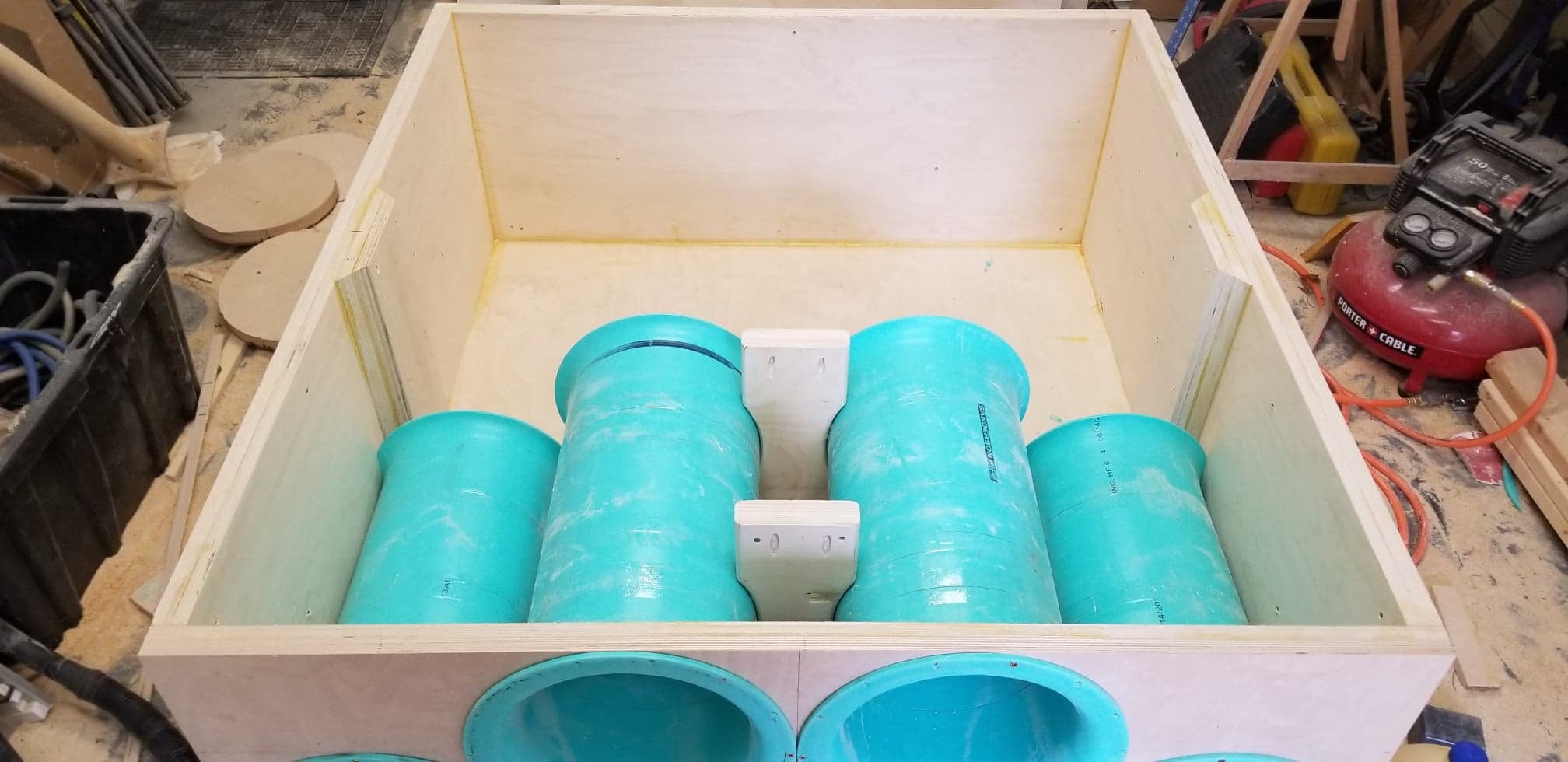

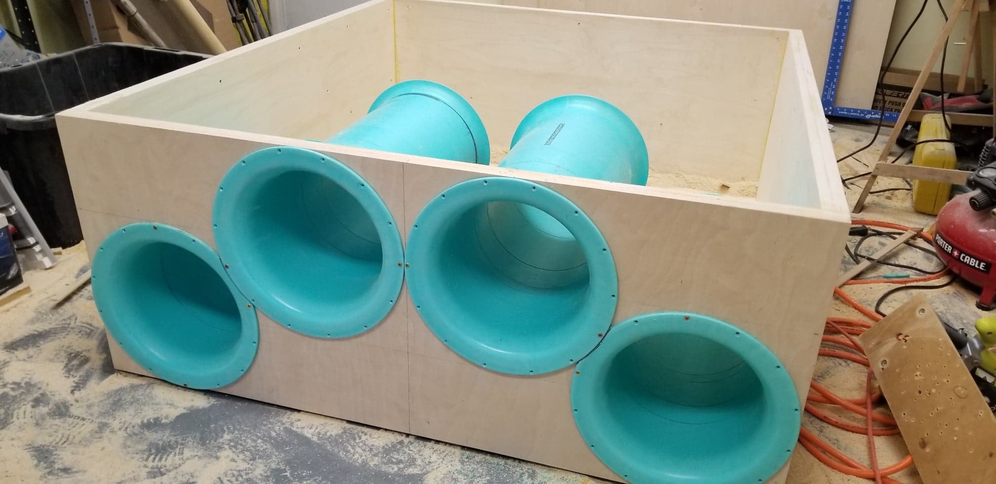

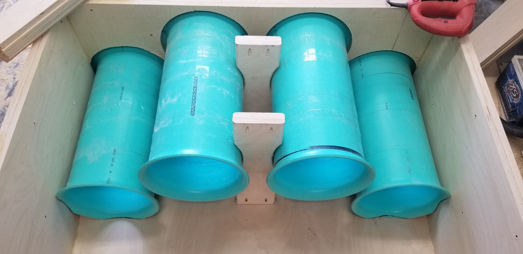

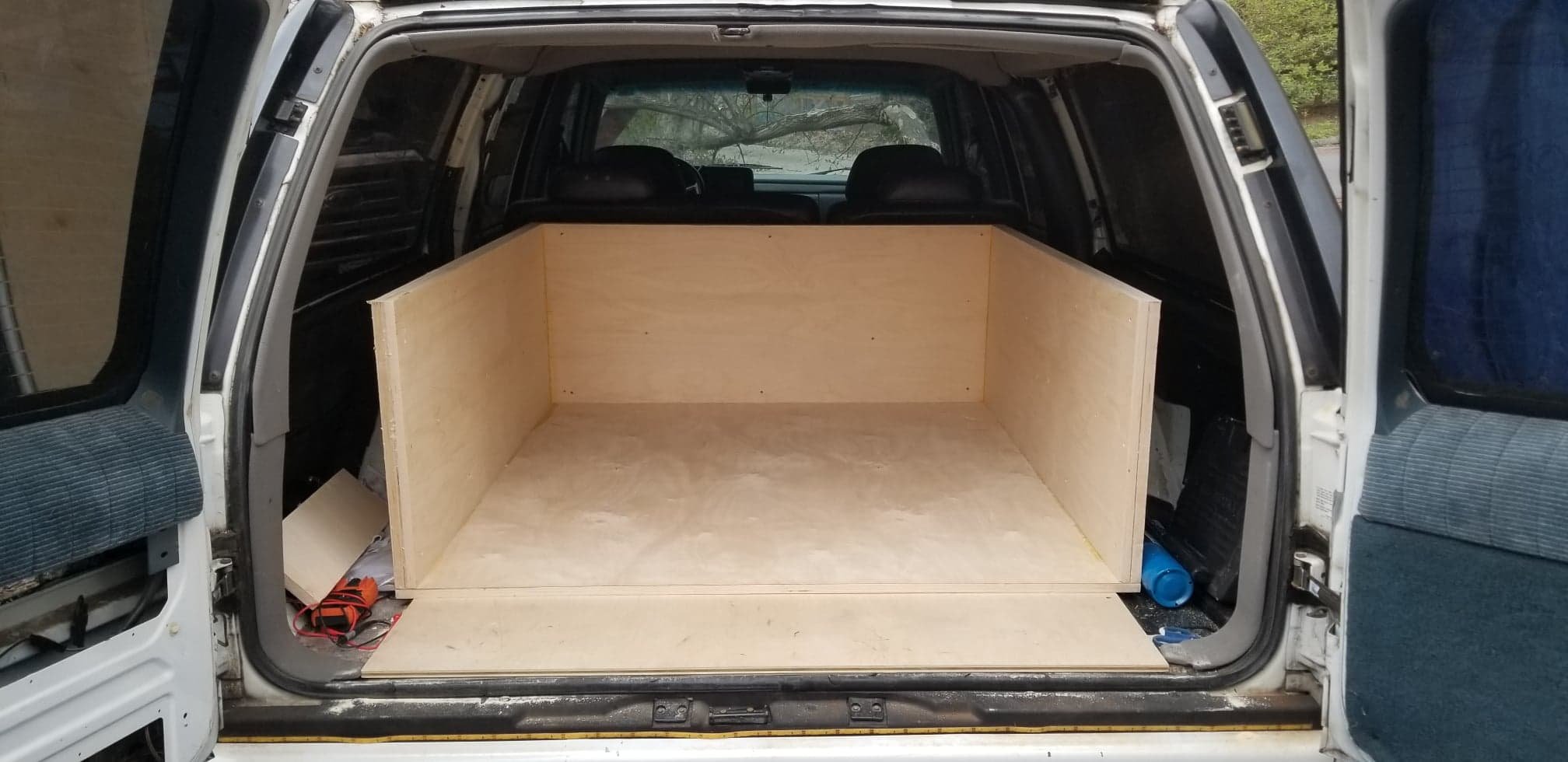

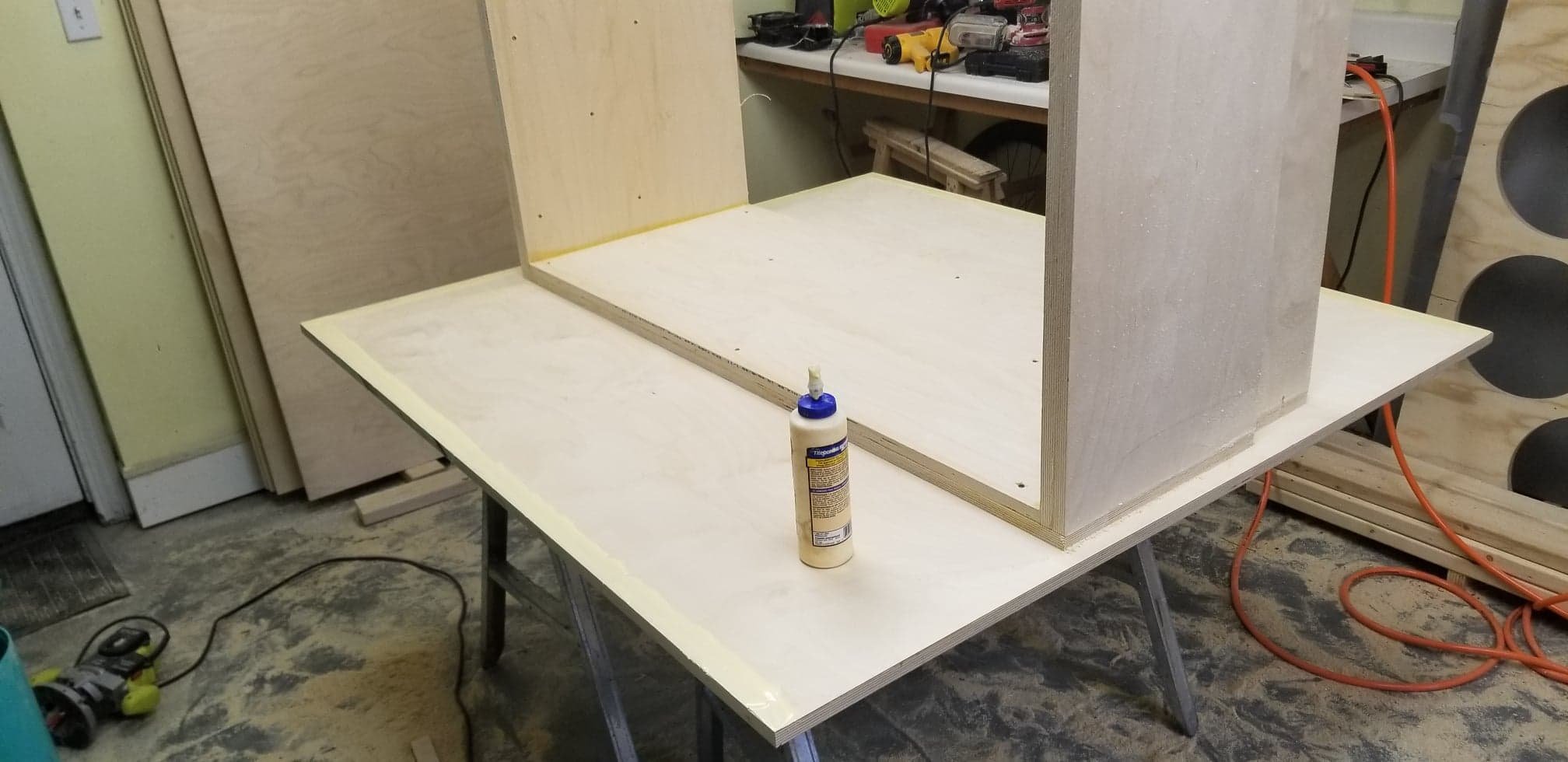

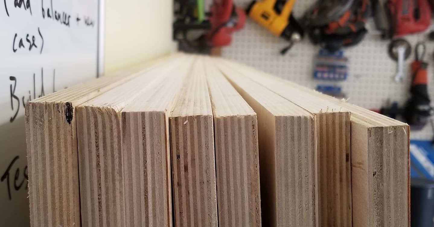

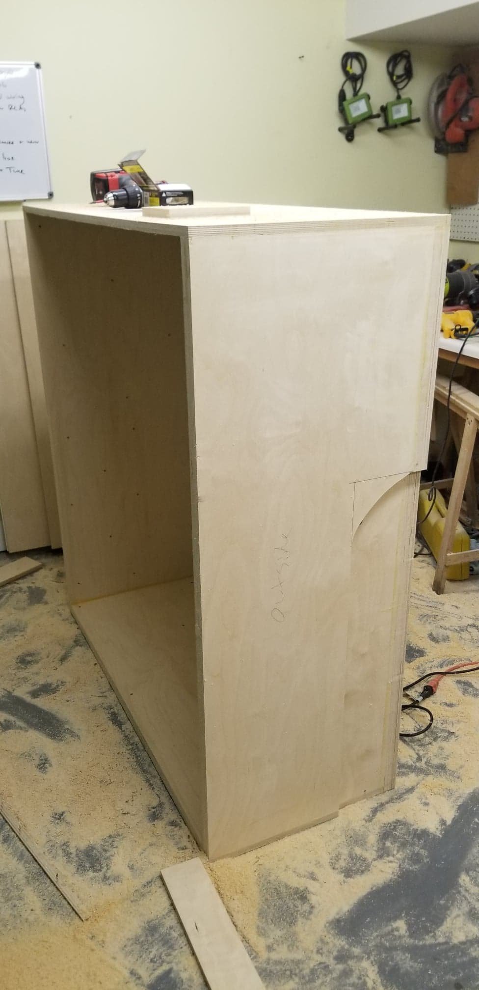

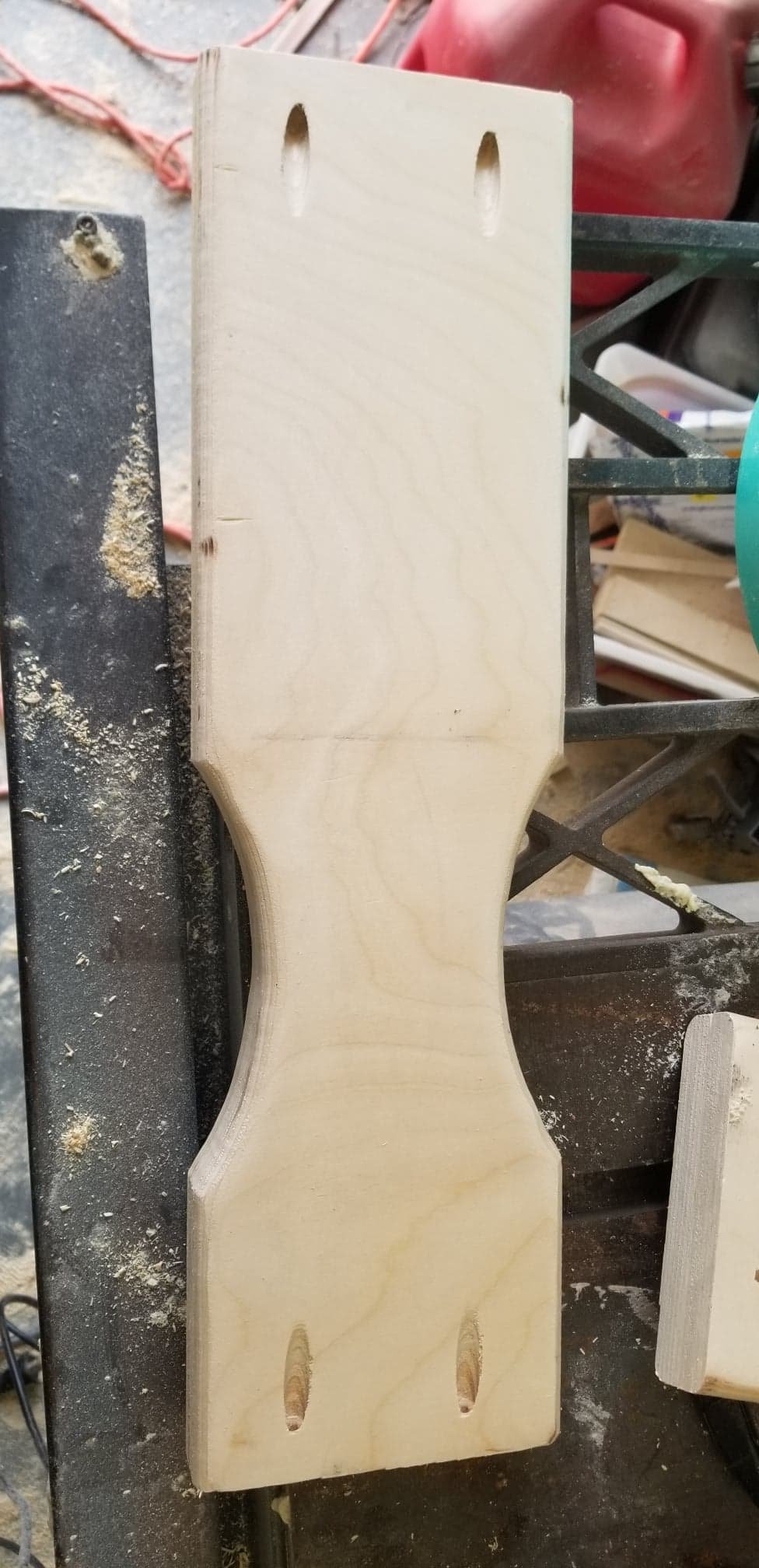

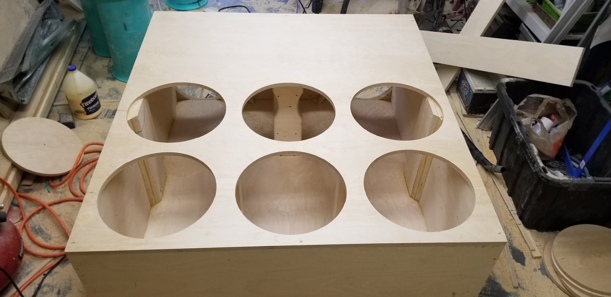

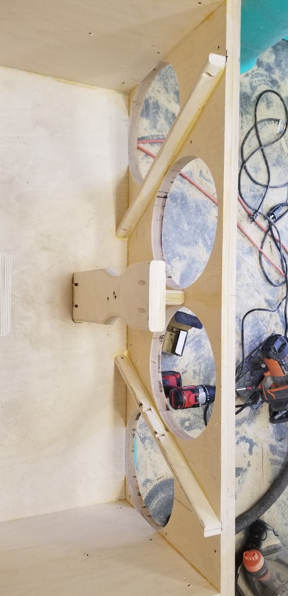

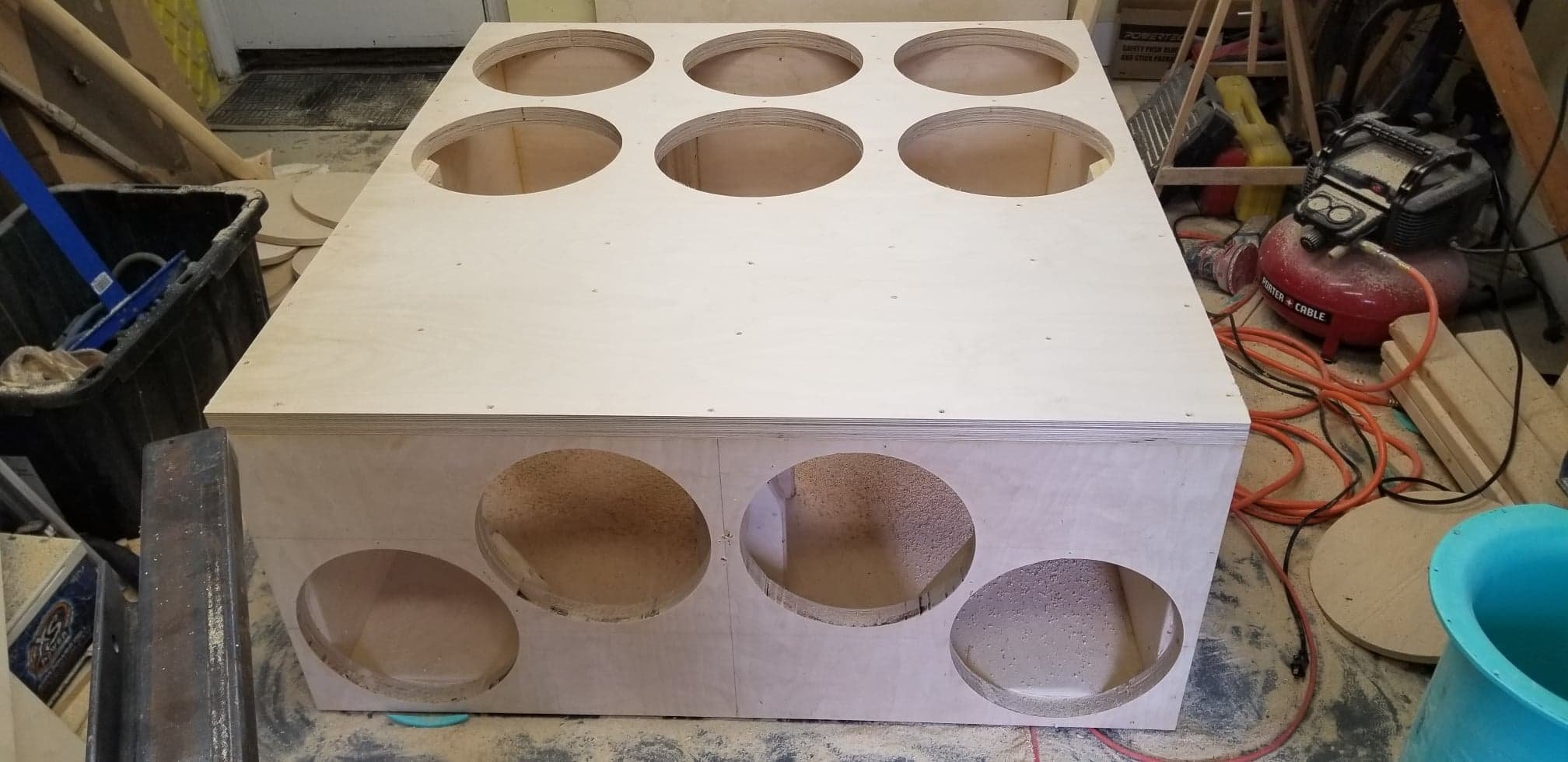

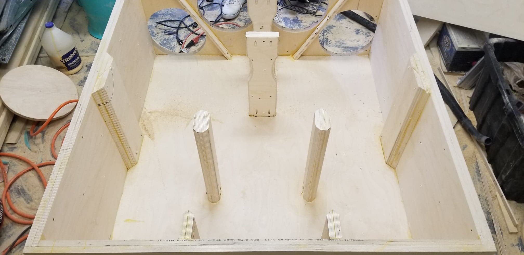

Aaaaaaand more box work!

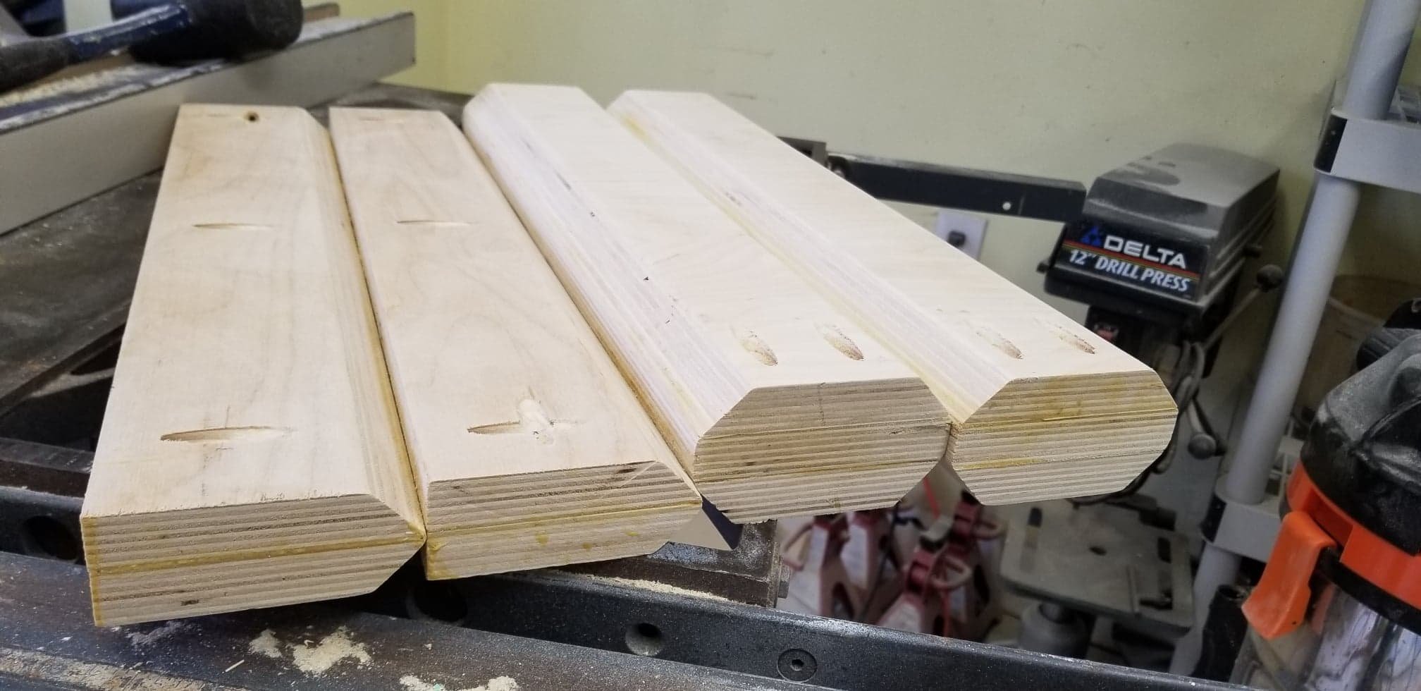

Lotsa bracing.
2044922553_89948536_1399412960229595_4999338921771925504_n(1).thumb.jpg.a42c5070762cf39cc9282392c5b7b60a.jpg

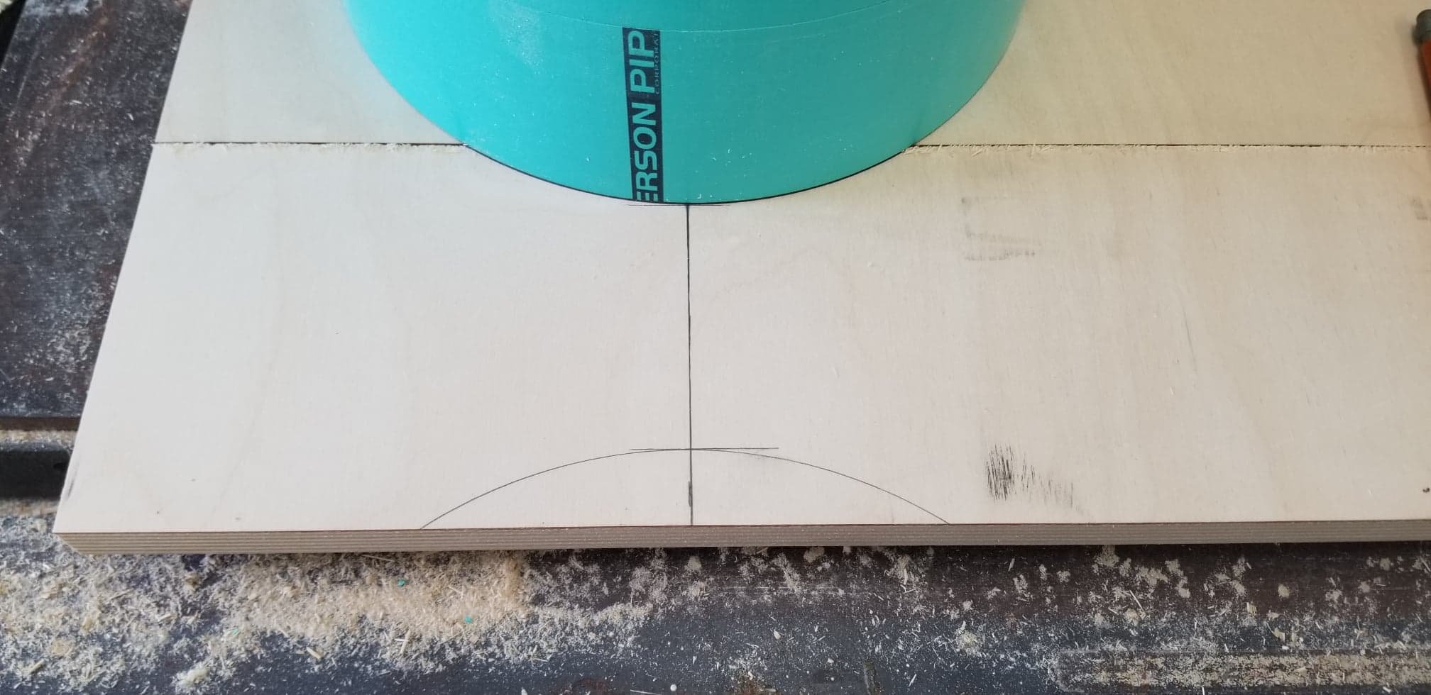

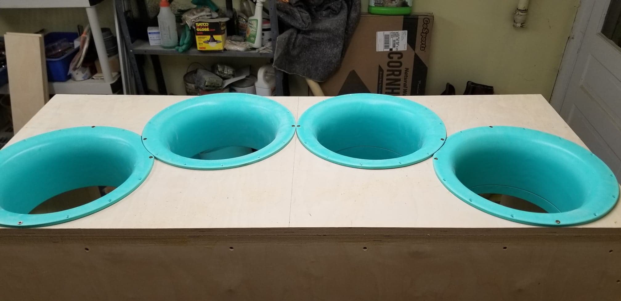

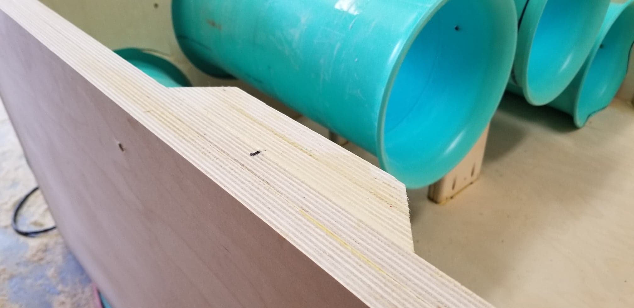

2 layers of baffle
89836711_1083939005305087_2147785609970712576_n.thumb.jpg.389742f90df9aaca3e7f90a3ea77b4af.jpg

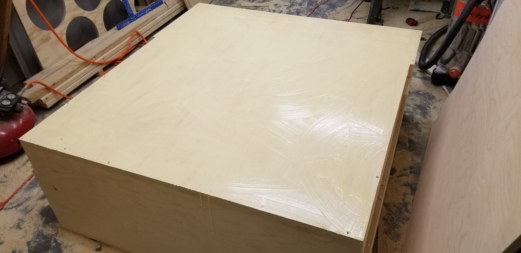

Applying glue for layer #3
89919160_520727325249367_5585507163452735488_n.thumb.jpg.be0096adad797113e4c2a583d4068faf.jpg
651189224_90269471_647399339137630_2542818259267223552_n(1).thumb.jpg.502e3c213ff3242217458b93e76375a4.jpg
89912116_2439686946343045_1259079738815676416_n.thumb.jpg.54acd48397646d5b449411d3d60119b8.jpg
89867971_3110392592363022_6352900605295460352_n.thumb.jpg.fd09d675efee7d204f7d26f22911b823.jpg

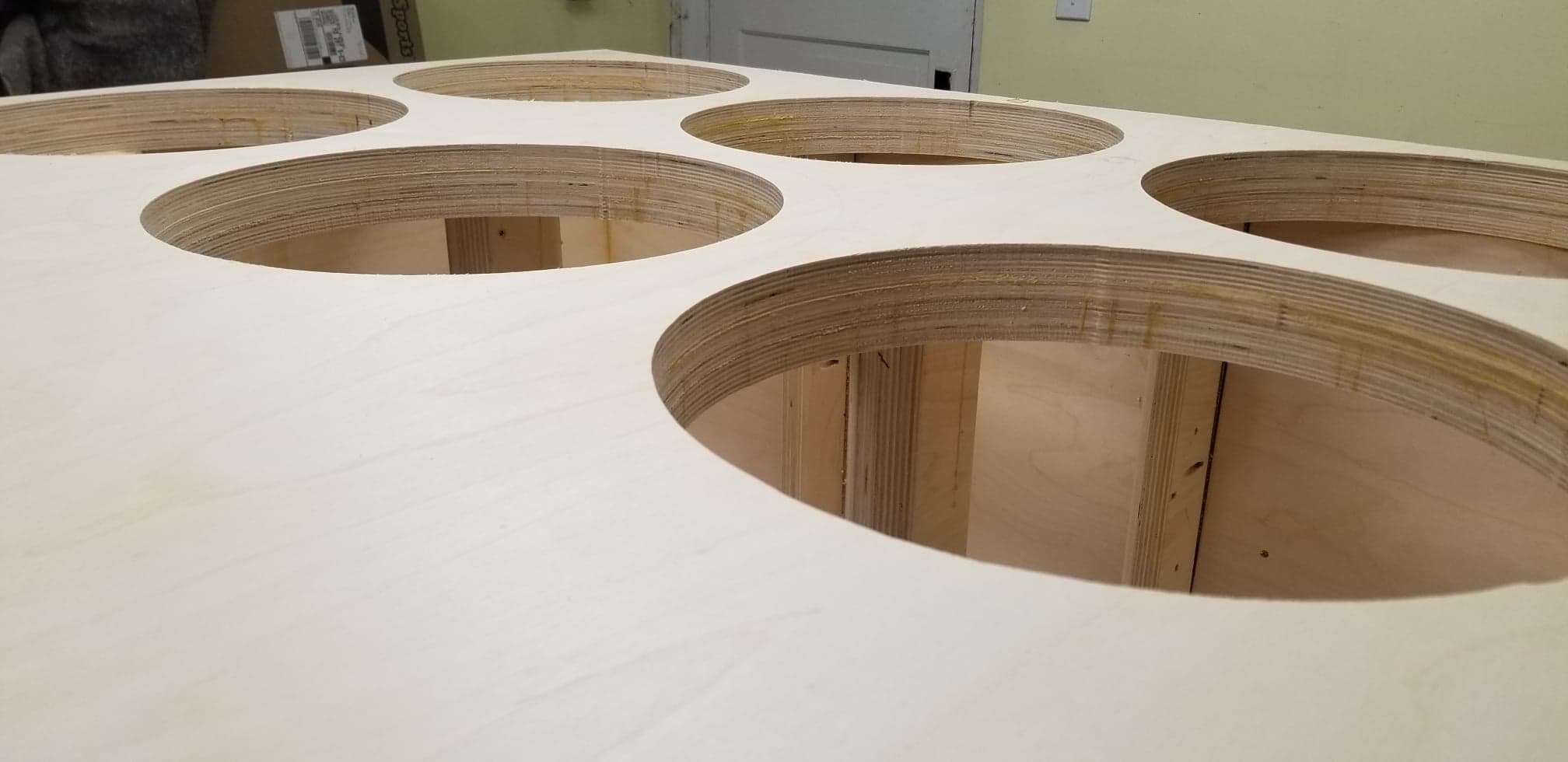

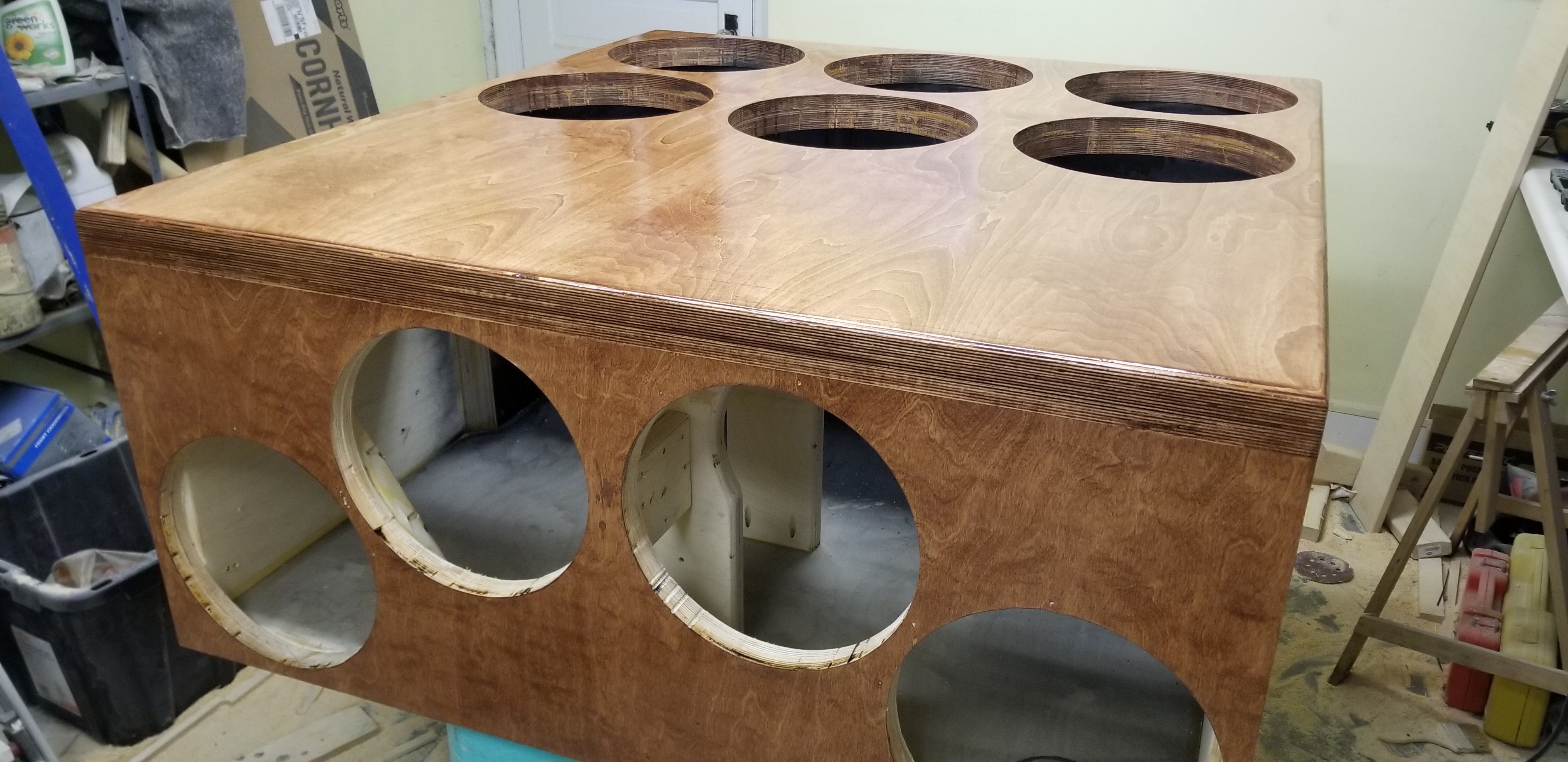

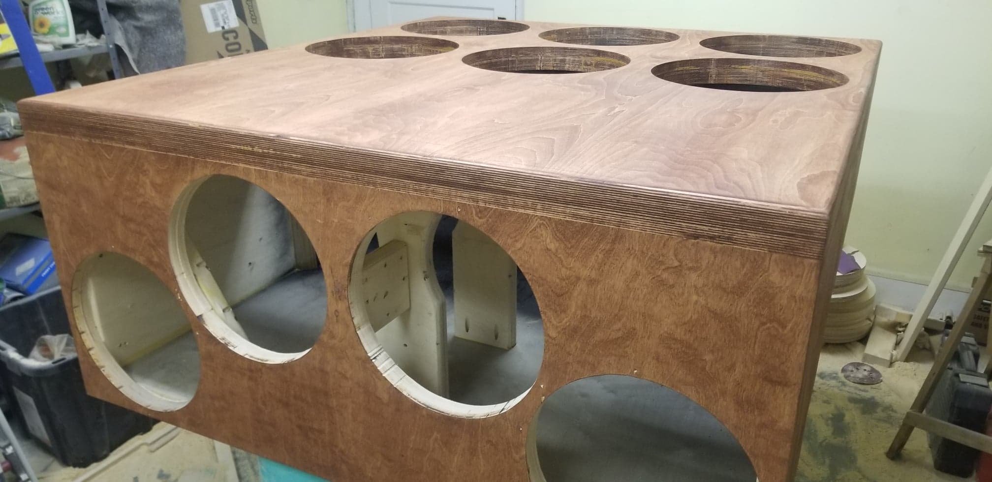

Last night, I:
- filled the couple screw holes I made.
- sanded with 80, 150, 220 grit paper.
- hit the top with a 3/8" roundover.
- sanded again.
- laid down a coat of minwax honey stain.
Tonight, I'll lay down a couple thick coats of clear.  I can't wait to see this color/grain really pop!

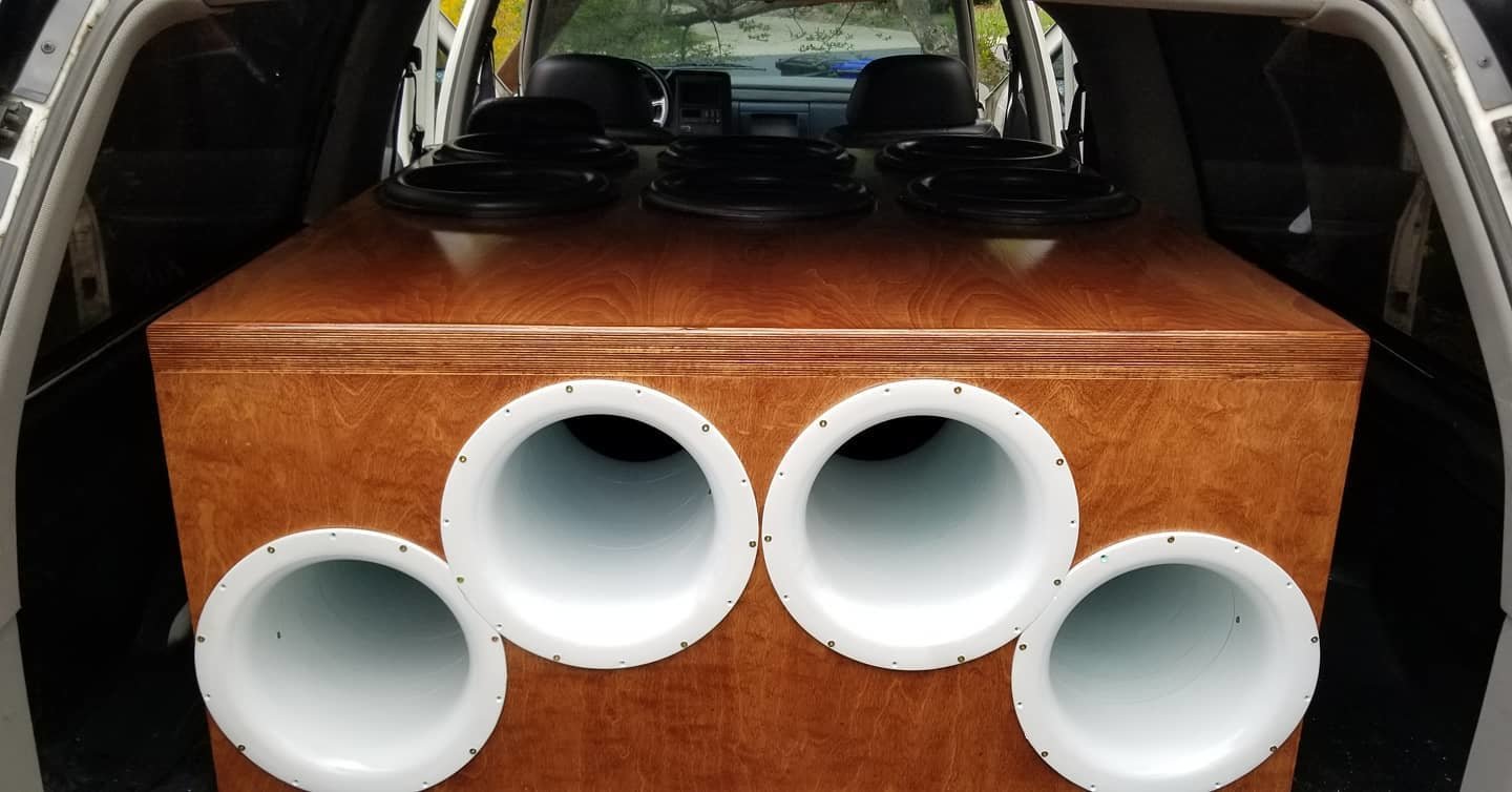

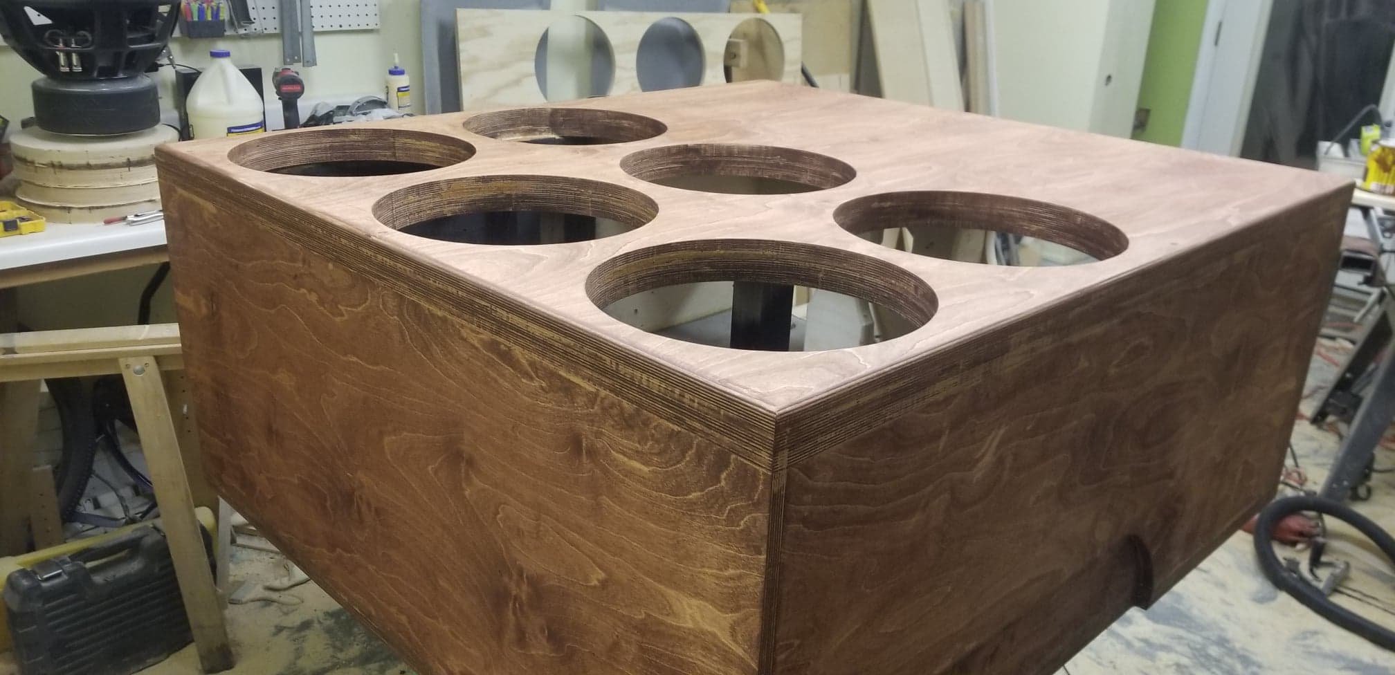

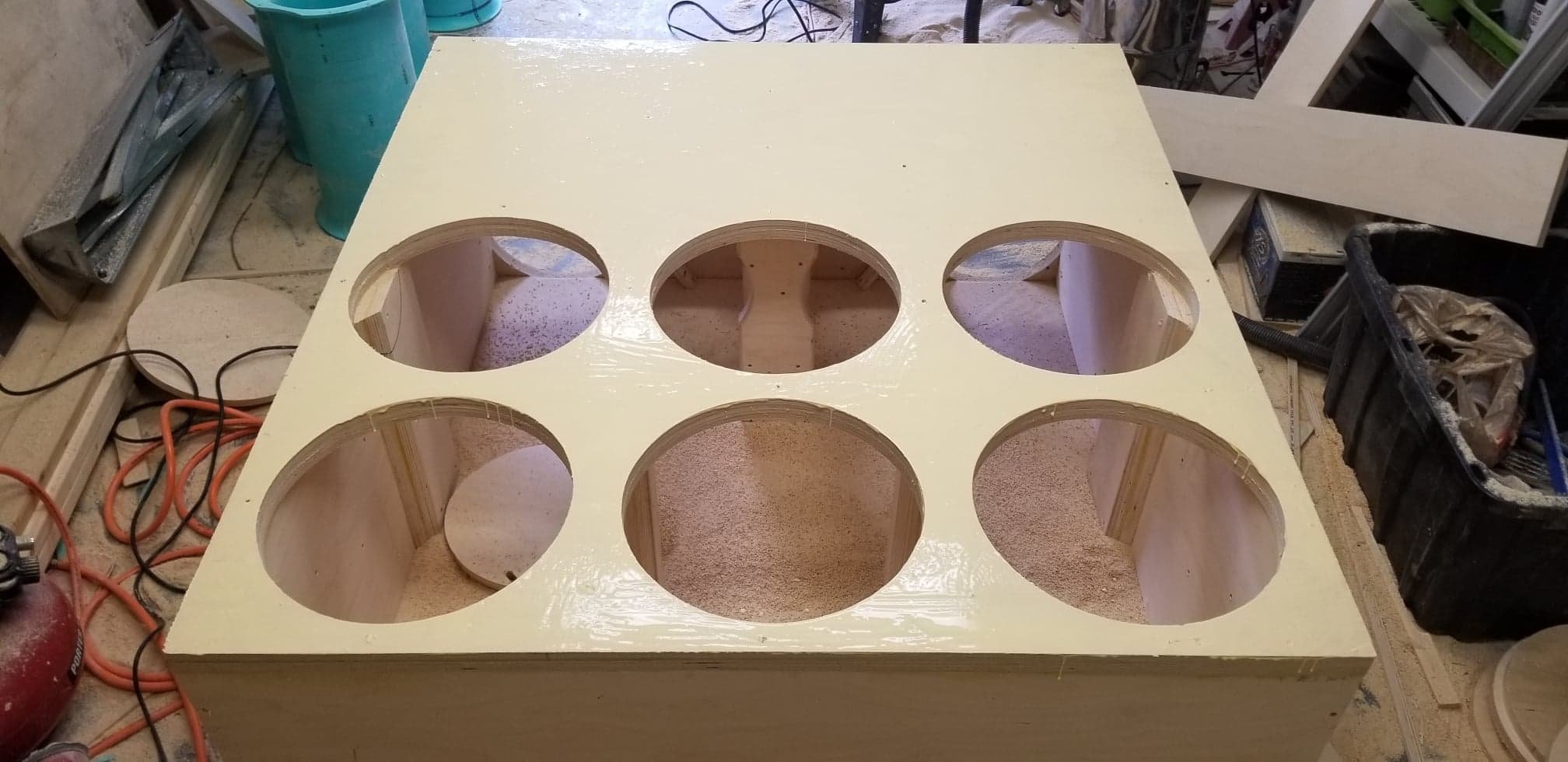

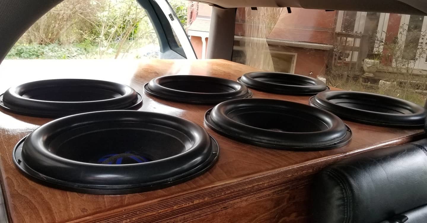

2 coats of poly later, this is the product!

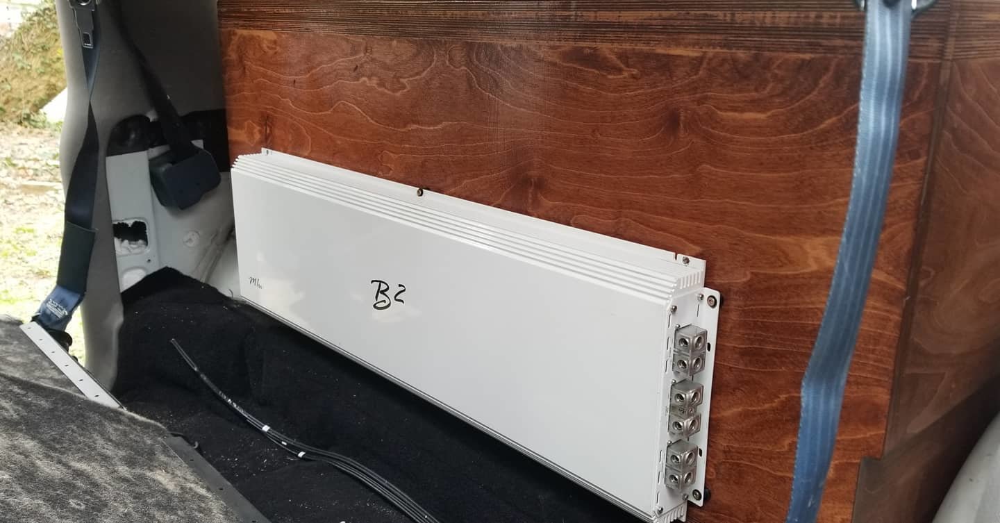

Also, I ran new RCAs in the truck yesterday.
1993 Suburban
6 Crossfire XT3 15s
Crossfire XS-16k
Crossfire mids & highs and amps
65ah Cmax bank
Iraggi 320a and Mechman 300a

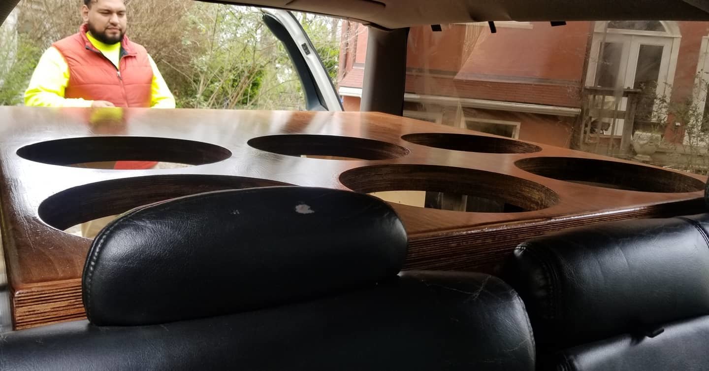

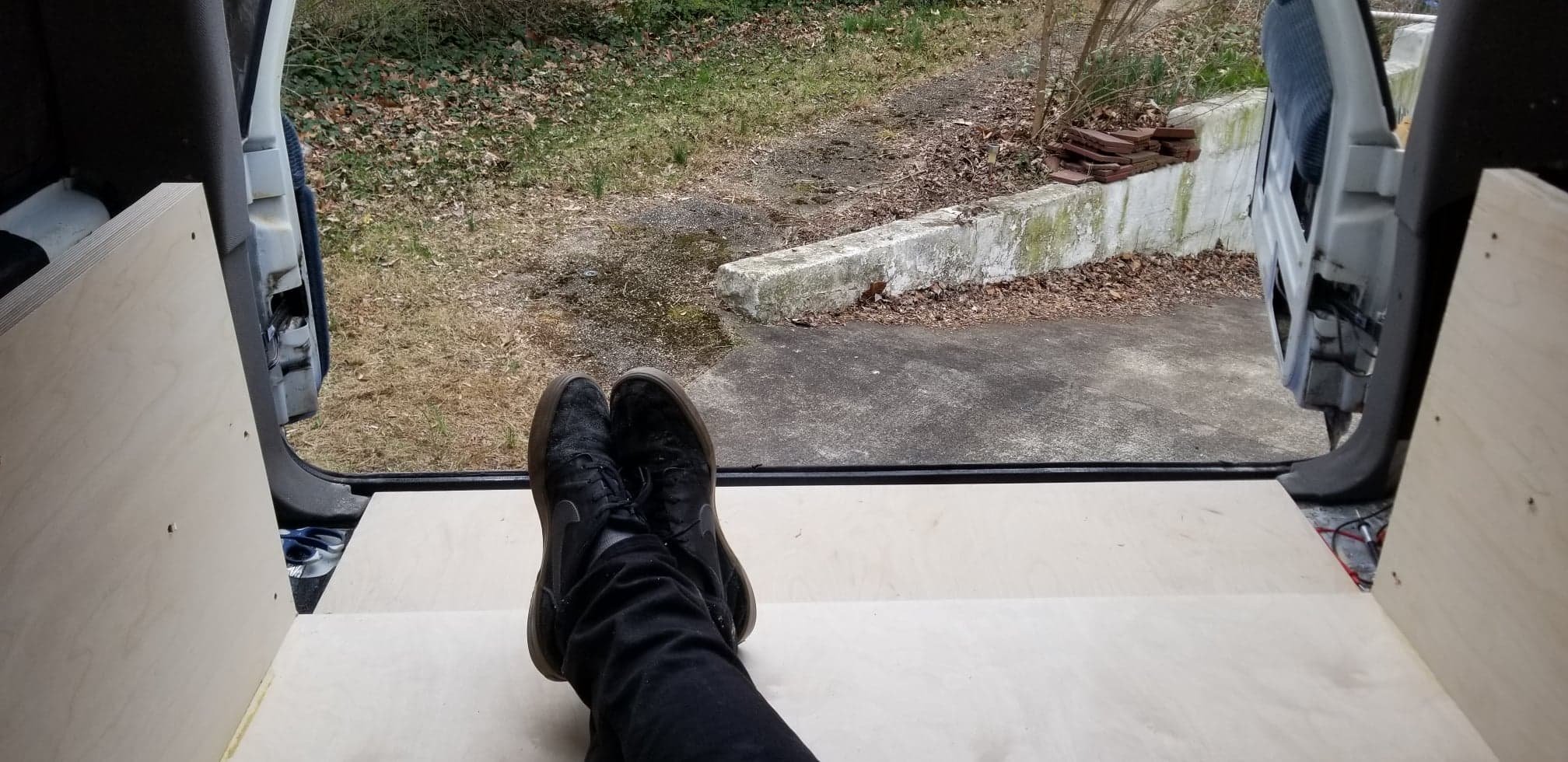

Got the box in last weekend!  The box alone weighed about 450 pounds.  It sucked.
90485297_2877572212328786_6642468193744977920_o.thumb.jpg.42a69f53cfd8d93ce435bfc4ed5044dd.jpg

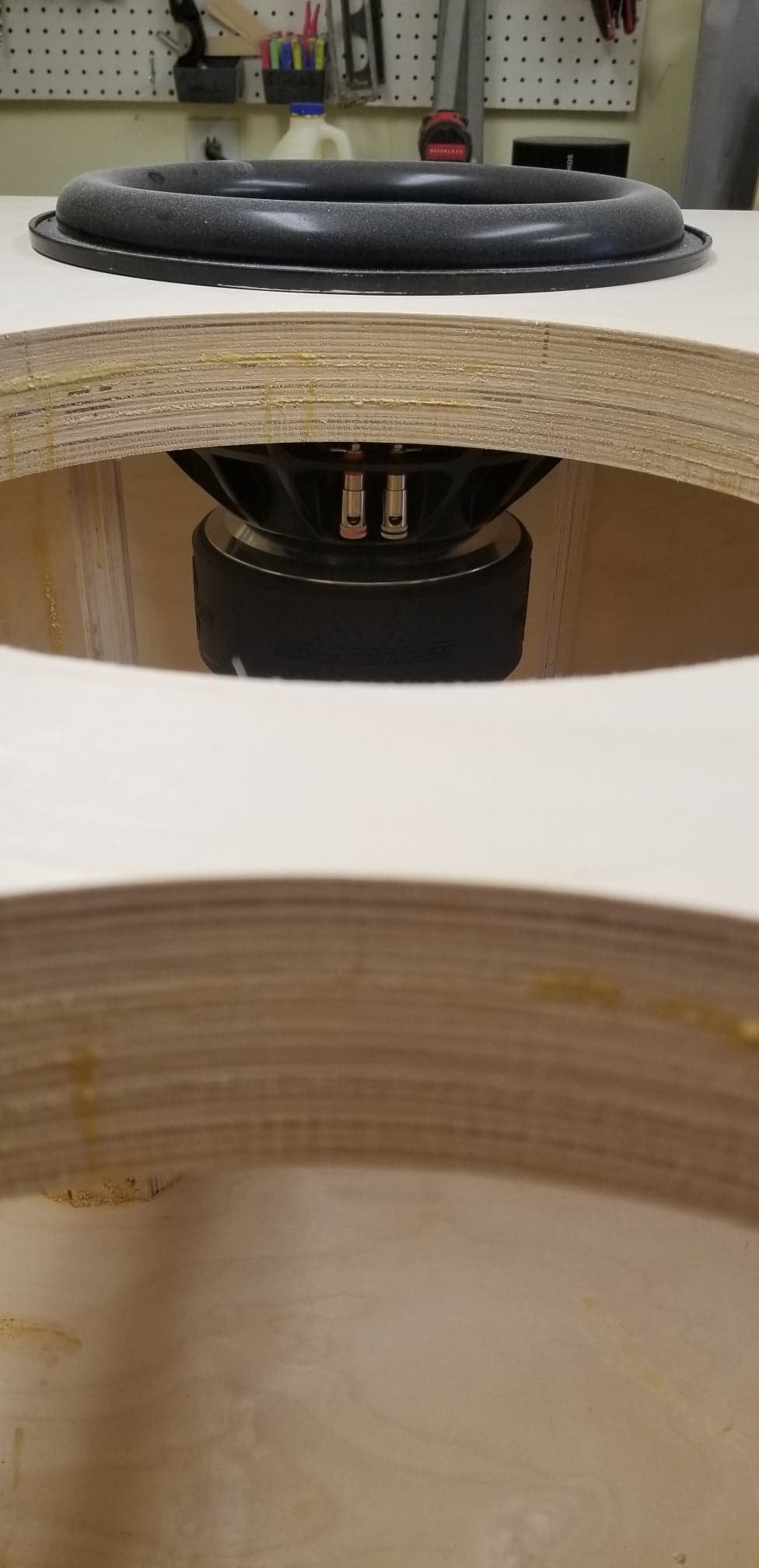

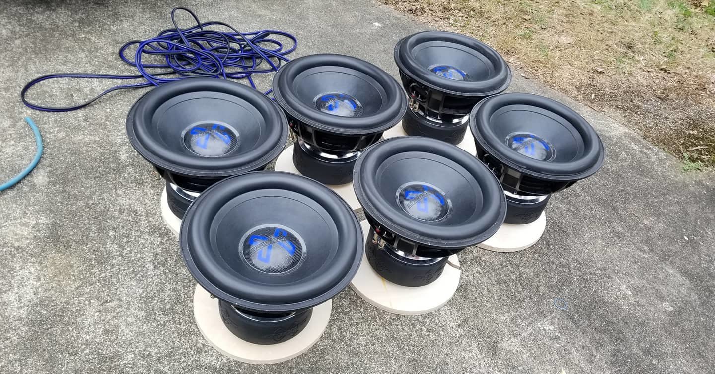

Mah babies.
90385763_2877572155662125_6607876462718484480_o.thumb.jpg.9374005a3e4d997a45a74163a92bfaed.jpg
90442463_2877571972328810_2385412157454942208_o.thumb.jpg.818abd35a260028a74f79e498c26f4f9.jpg
88136511_2877572098995464_3944600515580526592_o.thumb.jpg.8a4a619378440c4df400bb488d62bb3f.jpg
90392441_2877571925662148_608808294198280192_o.thumb.jpg.08b9c82706c53f4f5bcdfc679e675963.jpg

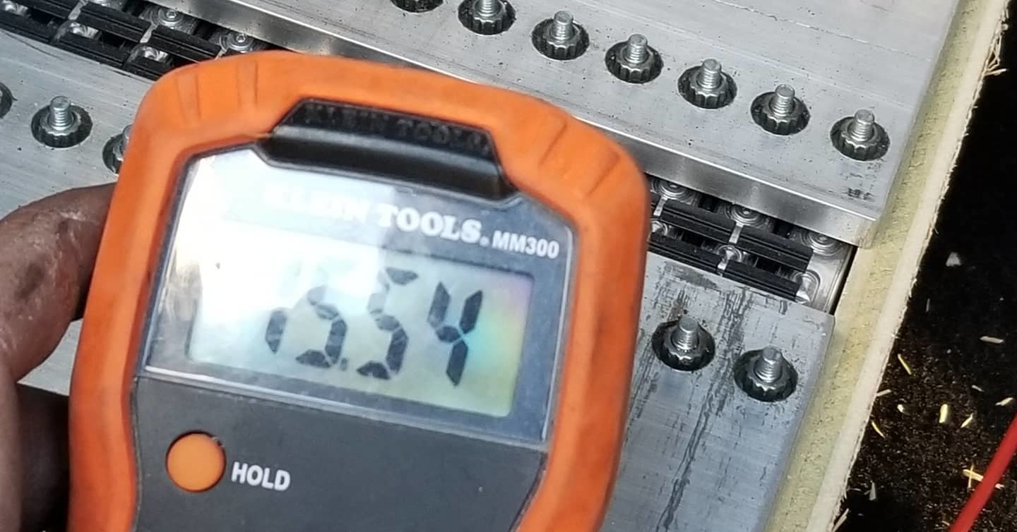

First rip, she busted out these numbers:
Legal (Sealed on dash): 155.6dB at 34hz
Door open on dash: 156.51dB at 36hz
Door open in kick: 157.05dB at 37hz
And then the M1u popped while the truck was sitting off as I pumped gas.  So, time to save for a Crossfire 16k!  After I do a lot more cabin treatment done and play with the ports, maybe we'll get a 160 out of her :)

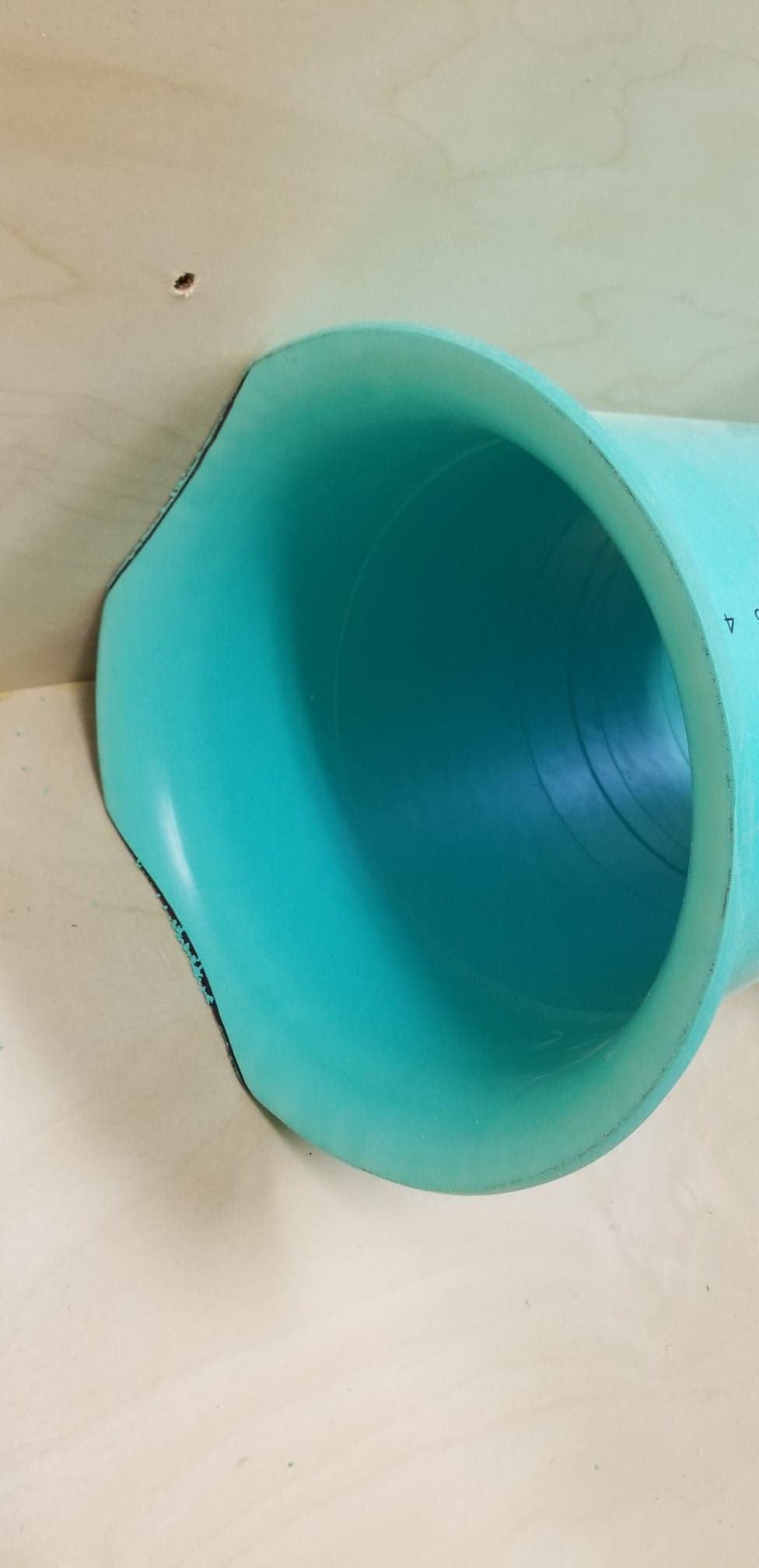

Just ordered a bunch of hardware for bolt terminals.  The subs are currently wired in series/parallel/parallel at a nominal load of .35 ohm, but I'd like to be able to wire the subs in parallel/series/parallel for a final impedance of .75 ohm for daily listening.  Running 6 subs gives some fun wiring options haha.  Basically, I'll wire the coils of each sub in parallel, then each group of 3 subs in series, then the 2 groups of 3 subs in parallel to get to that .75 ohm load.
