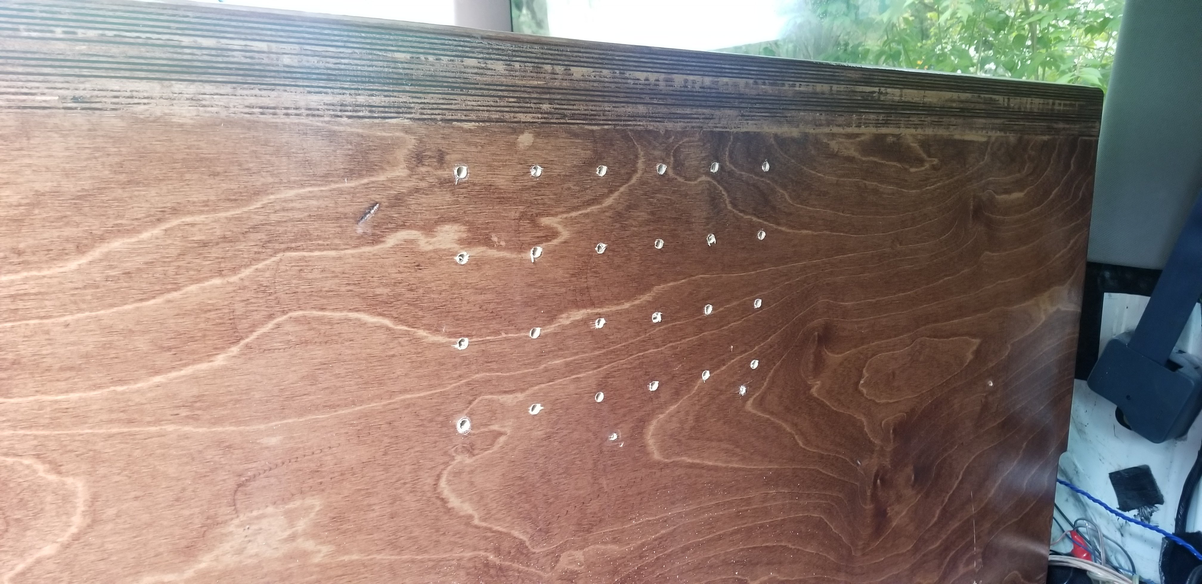

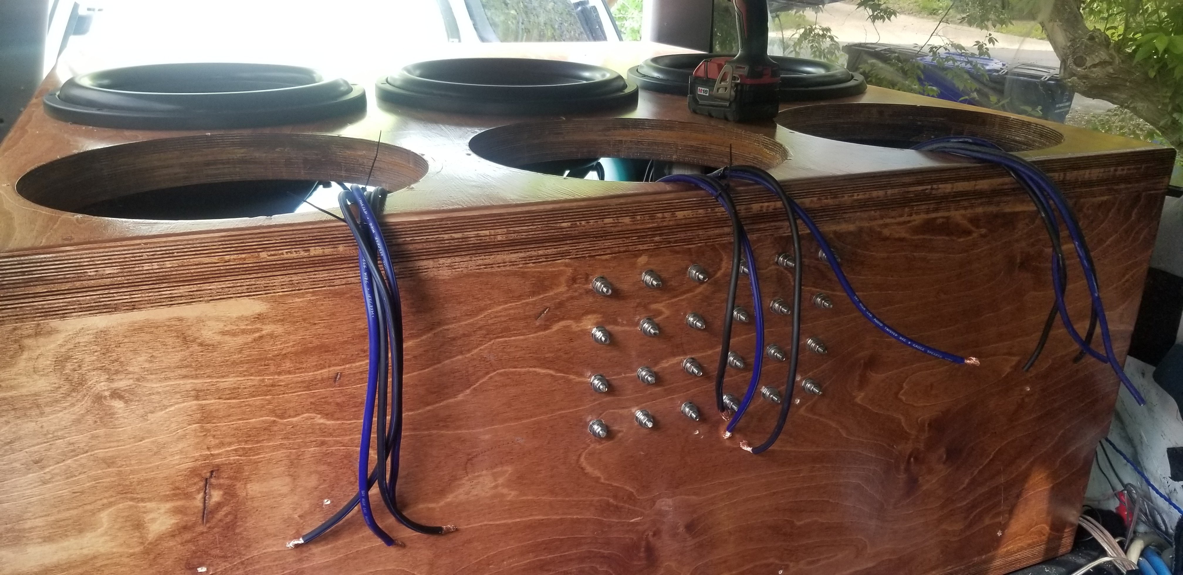

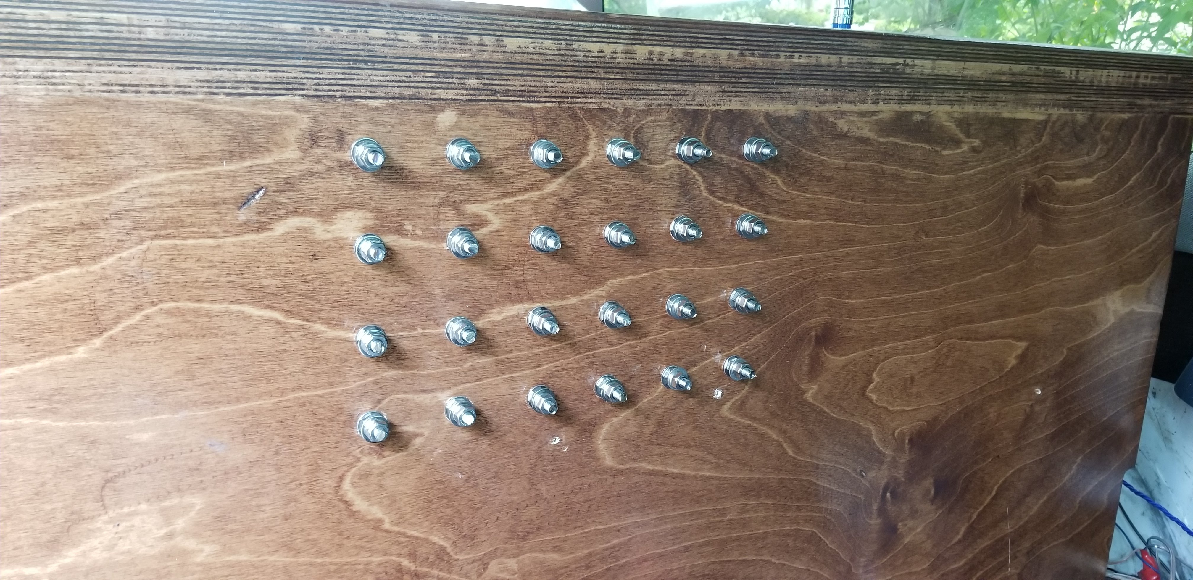

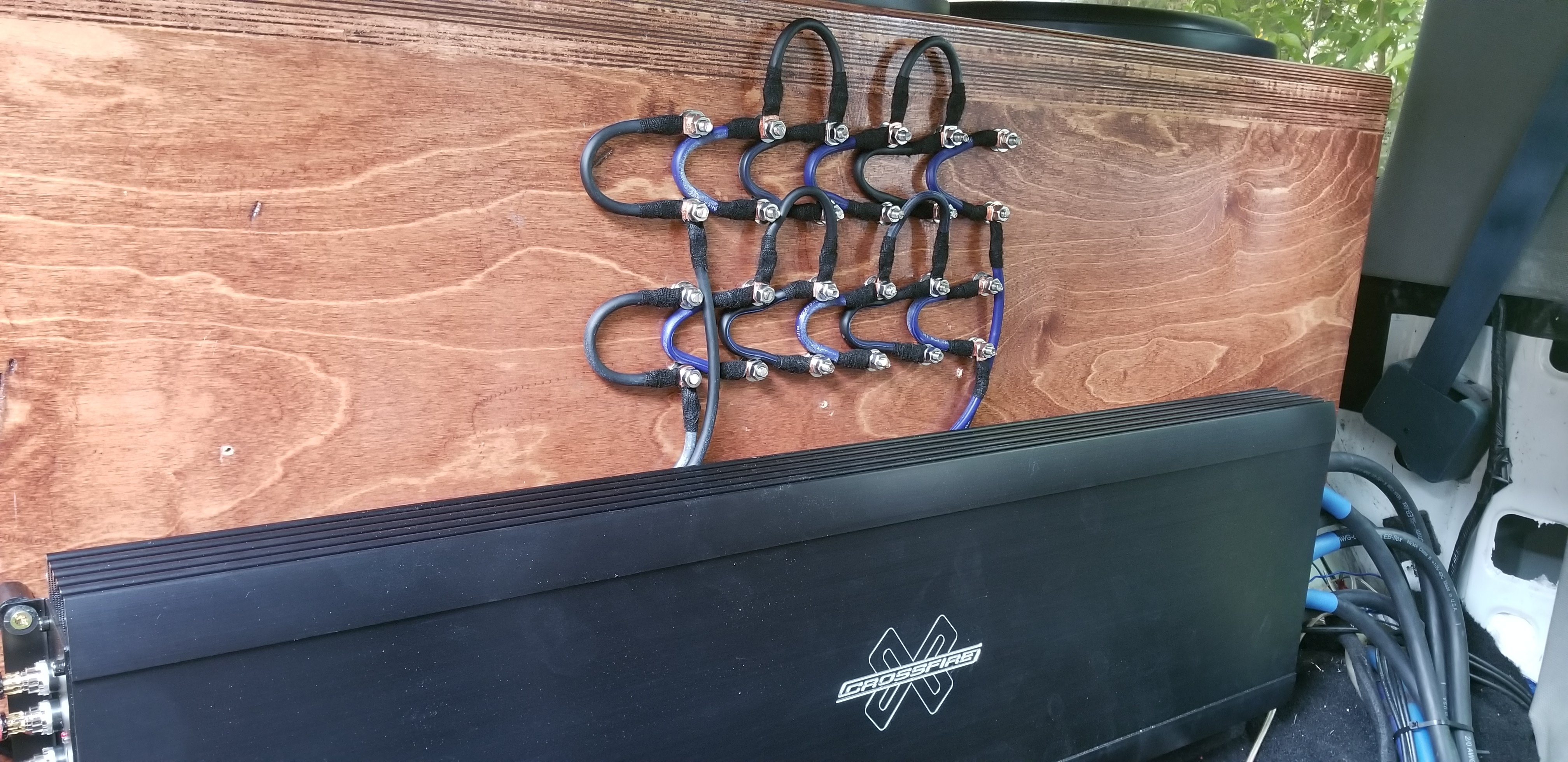

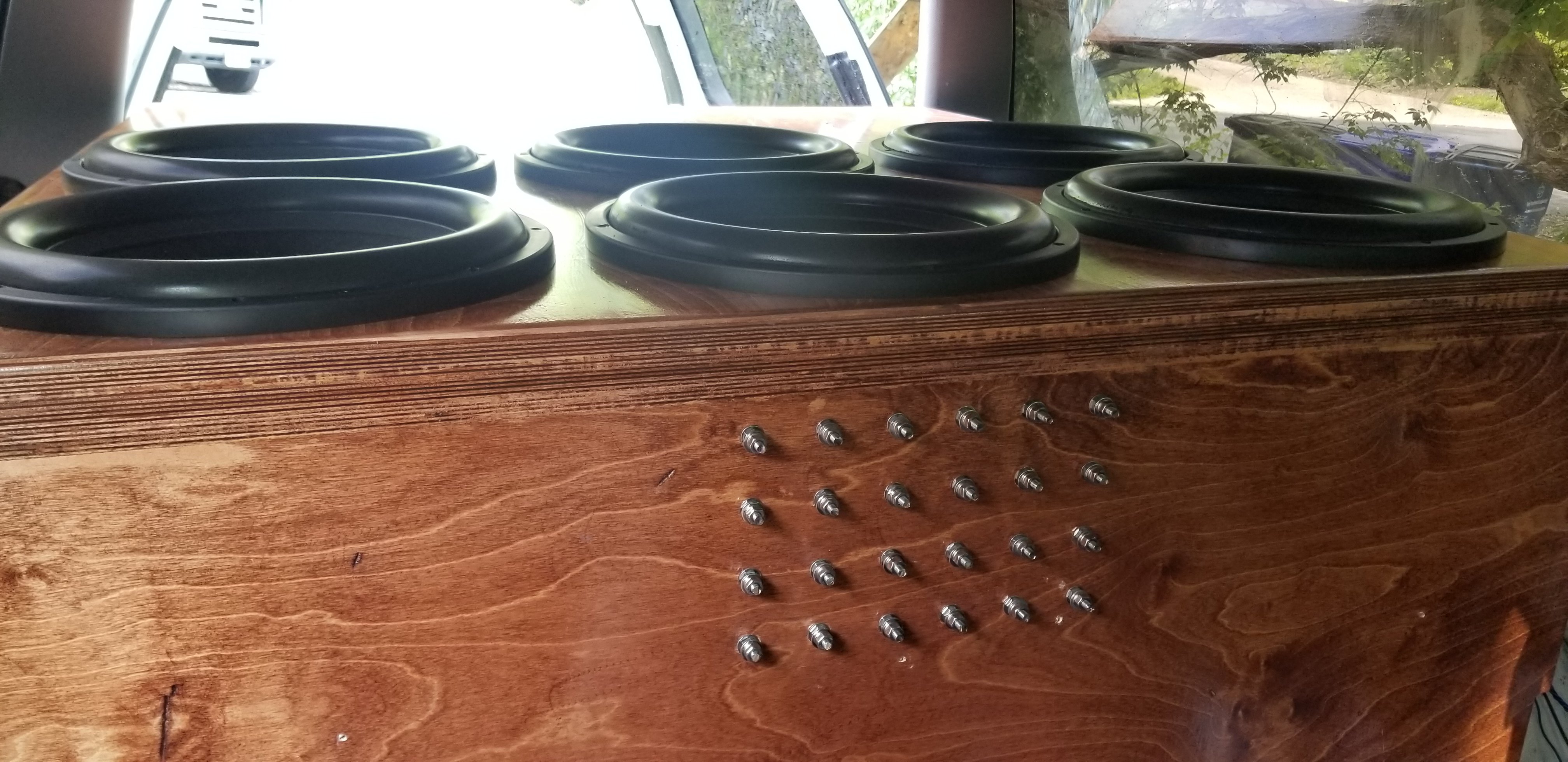

24 bolt terminals!

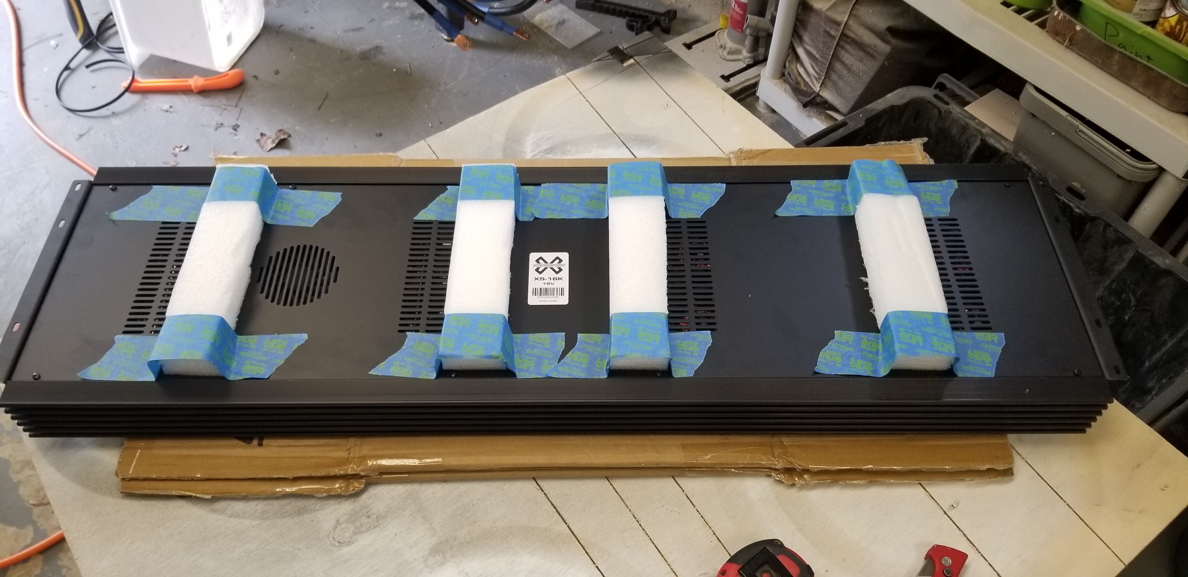

I decided to cut up some foam for a little extra support in the middle of the amp (since it's a million miles long).  I didn't want the middle flexing too bad.

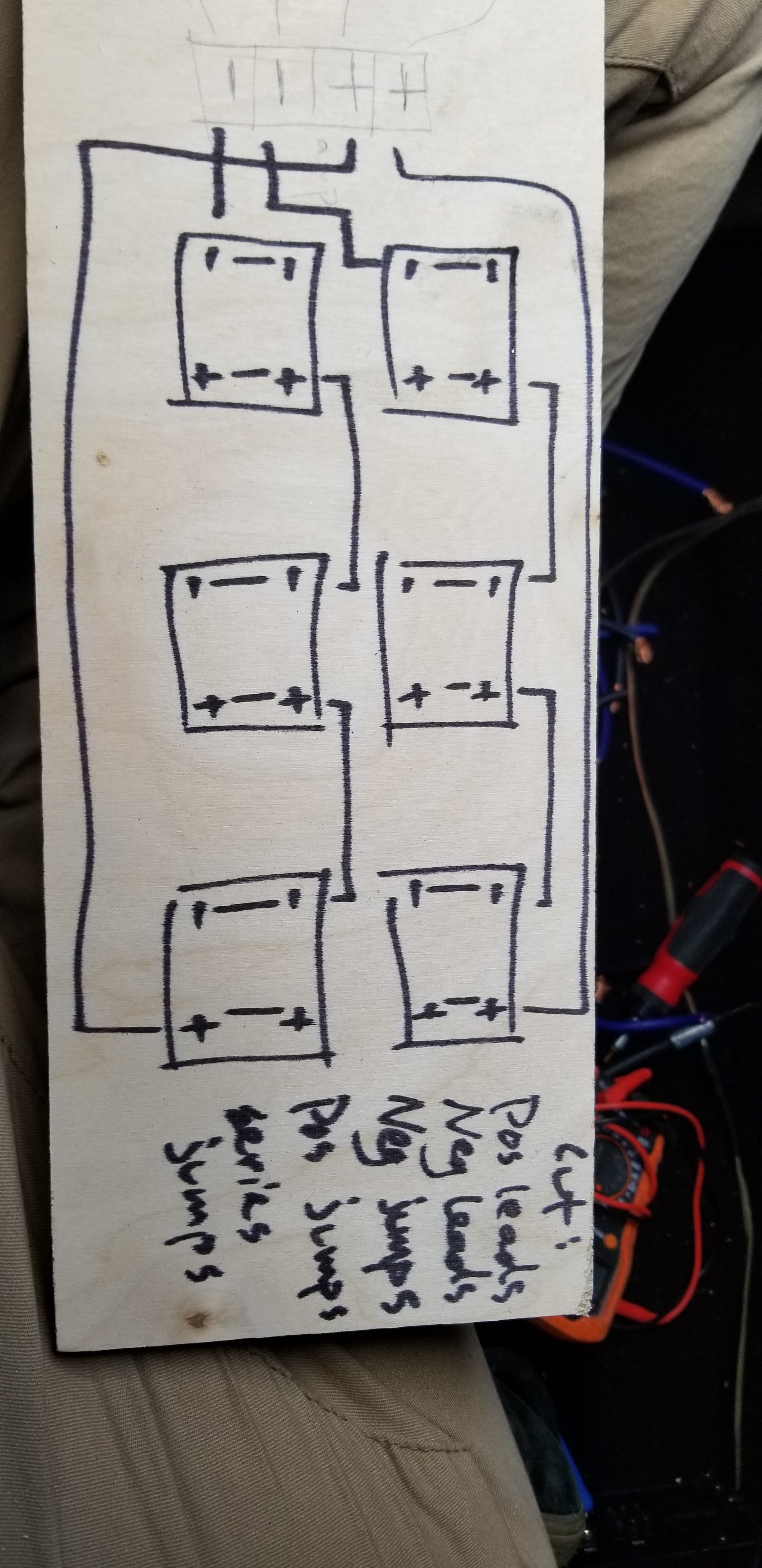

Super fancy wiring diagram

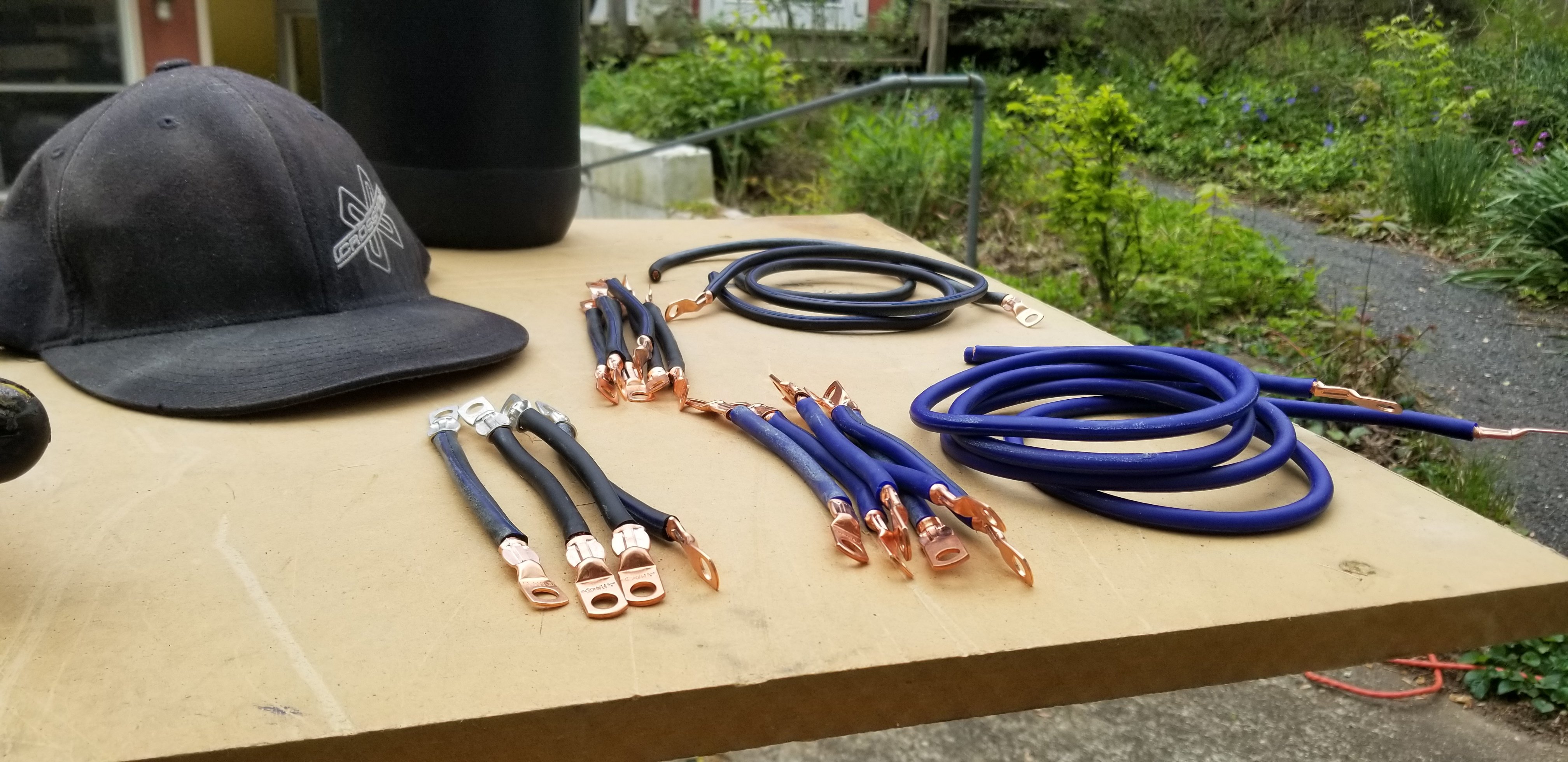

1,000,000 jumpers later:
