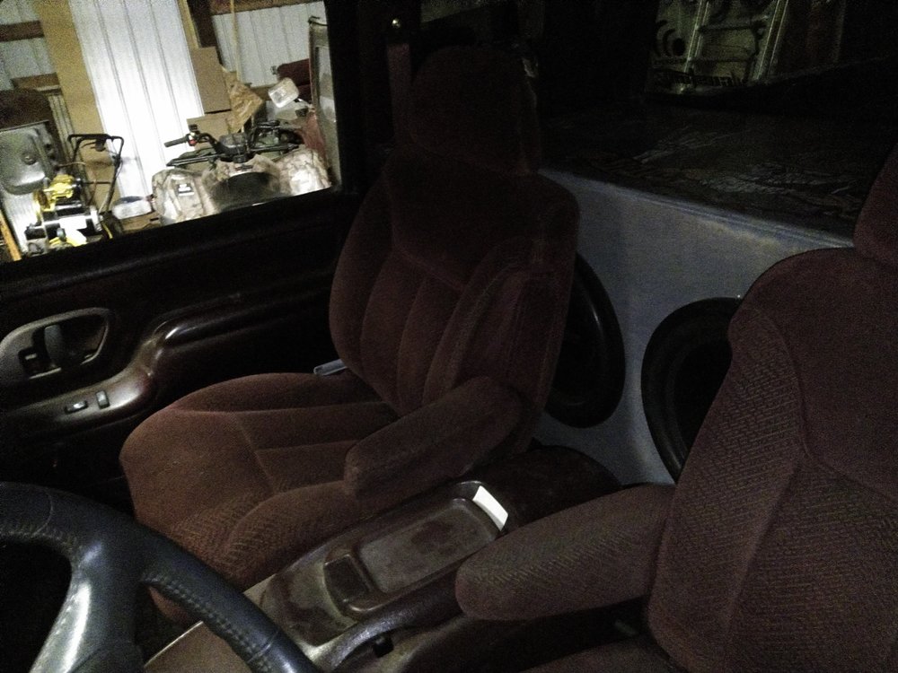

Appreciate it man, LONG time coming and ALOT of work, still ALOT to go lol.

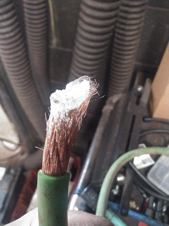

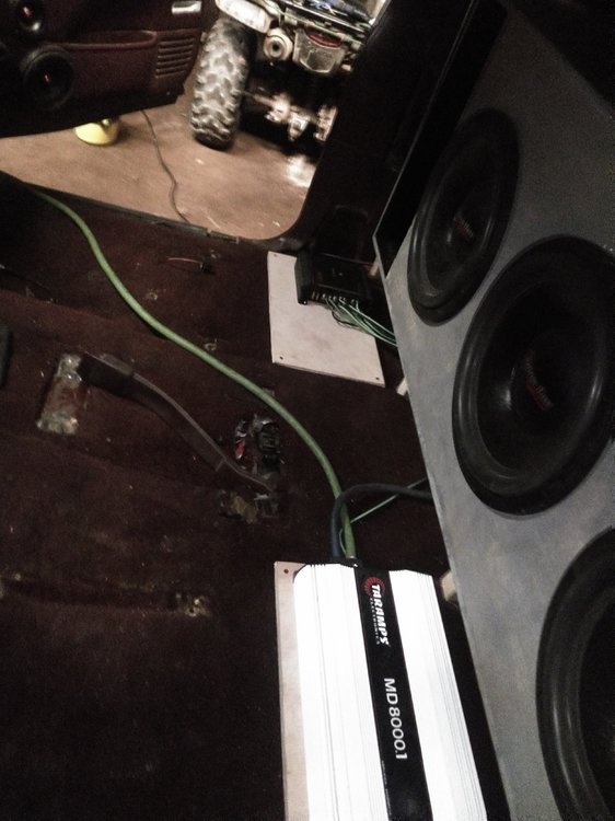

@bmwking I about wore my lil 1 gallon shop vac out, still gonna take it to the car wash and do it again. Still have to rebuild my dash , had it out to repair HVAC box and figured I'd run wiring deep behind everything before I put it back in. Got Amps mounted down ( temp mounts till I figure out what I wanna do), seats in, and center console in. You motivated me to get on it, I knew I was slackin , but u kinda called me on it , appreciate it bro!  Don't mind my janky ass power wire draped across the floor. It'll be gone soon , have sum cool wire holders I'm going to mount to inside of my frame and pop through the floor and then to distribution blocks and to amps, second run will go directly to the 8k when I get sum more cash to get another 35' and lugs. Wire is short now cause I was going back to work at lunch and all cut out, I checked fuse it was good, check remote relay, it was good, started checking power wire and found where the insulation got nicked and the UP salt/sand did it's work! Wire swoll up to about 4 times original size and there was about 8 strands actually still feeding power and the taramps cooked those. That is now a good reason to NEVER get cca wire! I have shca cca 14 gauge for mids and highs , that'll be replaced soon with ofc 14 gauge. Making progress tho and excited to get it finished. Have alot to do on my truck still too, have cab corners,inner/outer rockers to put in, new doors, cam, mpfi, and a 0411 ecm swap and a tune, have a rcx 4/6 lift on the way too, and gotta get my 35s on my other 20s, cause it looks stupid as all get up right now with 5.5" lift and stock sized tires!

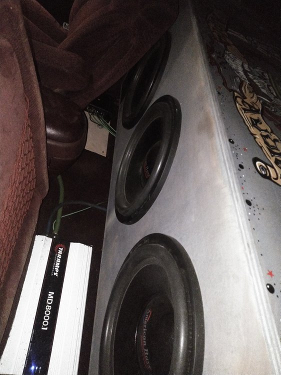

I built my box for my 8s with port on driver side and I tried port up and forward on both sides and it was the loudest (by ear atleast) with port on passenger facing forward, that's why I put this one on that side. And shit that box is in there so tight, it'll only come out in pieces, u actually put a bar jack between b pillars and stretched cab apart to get it in!
