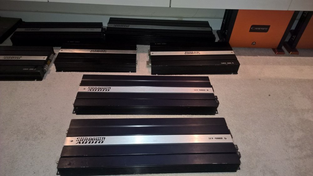

LoudForeign99 Posted March 3, 2020 Author Report Posted March 3, 2020 I finally solved the problem so far. One of the SA's is bad. If you move it back and forth with an ohm meter, there is a significant increase in a sweet spot within it where it must be grounding out or something. I replaced it with another one from a spare box and I am back to life! I will have to send the scv's out to be repaired, but I am fine using the saz-3500d for now. Mobridge is doing great. Sound quality is great also. Thanks for all of your suggestions though. For SparkyMedina, I had also stated in my previous post that I had replaced the raptors with a Maxwell Supercap bank. Also, fyi to everyone, you must understand that the Batteries in these cars are in the trunk by stock. And remember, I have put in 2 instead of 1. The runs even with this power cable are lie 3 feet. Very low resistance and loss with this kind of distance, therefore 1/0 Gauge is probably overkill given the distance. I also do have if fused on amps and have it fused between power management. I will find out what brand the ground and power cable is. I was looking at it tadoay and the power is actually far bigger than the ground. Possibly 0 gauge or something. I do have more of it so Maybe I will replace the ground with it. This is pretty big wire, It barely fits in the amp terminal without shaving some of the copper. The sheathing definitely doesn't fit in the plastic hole like the ground does. I like it when it does. I also do have twin input adapters someone was talking about. The actually came with my 5000d when I bought it from someone. I don't think I need them with these short runs but I will look into it. I have been pounding all day testing everything and have yet to have a light dim. I have turned on the dash voltage meter in the cluster temporarily and it is fluctuating between exactly 14.5 and 14.1. It has not gone below that and I have been slamming, lol. I did actually build a little temporary amp rack today to float the 3500 above the 200.4 and it seems to do the trick. I will keep my fingers crossed. I will continue to monitor the situation.
LoudForeign99 Posted March 3, 2020 Author Report Posted March 3, 2020 This is a shame! Damn toast! smh. Have to send to amp lab and explain this b.s.
LoudForeign99 Posted March 3, 2020 Author Report Posted March 3, 2020 Also, I did make a mistake in my info from the beginning, I can see that I said "stock 320A alternator" My fault. I should not have used the word "stock" nor when describing the converted battery box below the trunk floor. I apologize.
