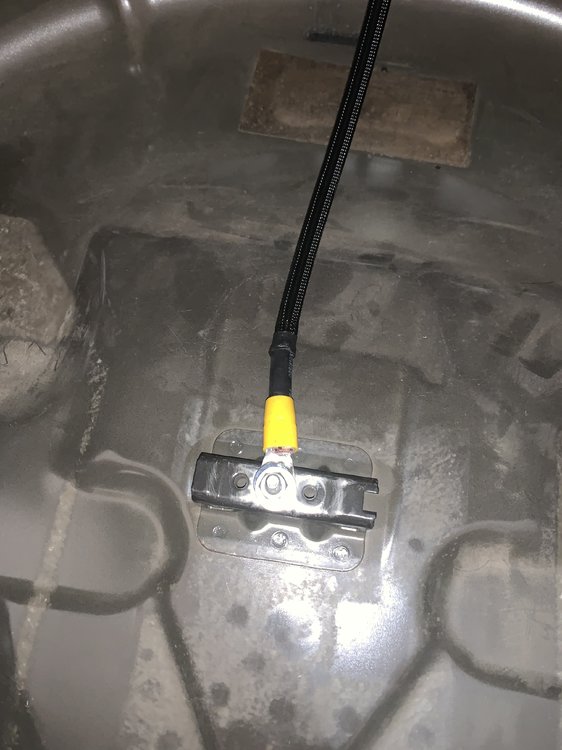

DokJ Posted April 5, 2020 Report Posted April 5, 2020 Recently upgraded everything in the car (except for the stock head unit). Have problem of constant high pitch tone through the tweeters (all 4 of them). The tone does not seem to change with engine rpm but it is absent when the engine is not running. Have moved the ground cable and power cable multiple times to try to solve issue - no success. Currently have the ground attached to the mount in the spare tire compartment. It's very hard to find a spot to run a ground wire!!! 2015 Mustang, Stock HU, JBL Club 4505 amp, JBL GX628x2 (rear), Focal ISS 165 doors and pillars (front), Kicker L7R 10" slotted port x1, wired with 4ga power and ground wire 14ga speaker wire - all terminals are terminated with wire ferrules or ring terminals and have heat shrink. Any suggestions please and thanks!

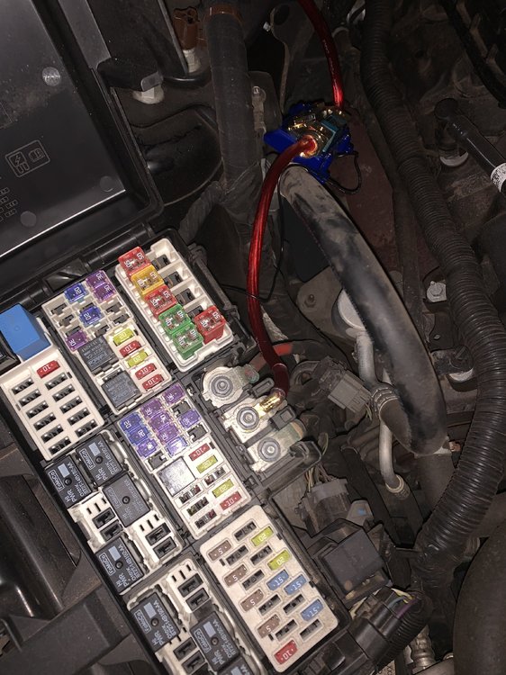

DokJ Posted April 5, 2020 Author Report Posted April 5, 2020 I have the power wire that goes to the amp (which is in the trunk) coming off of a 12v accessory in the main fuse block which is located right next to the battery (in the engine compartment) it then goes from there in through the firewall through the main boot (which is on the same side as the battery-behind the glove box area). It comes into the inside there and then I have it running behind the dash/console area then down the driver's side outer edge of the floorboard back to the amp. The only place the power wire comes close to anything else is where it crosses behind the dash area because that's where the head unit is. I have all the speaker wires running from the head unit down the passenger side back to the amp. I will check the connections at the battery again just to make sure. I've attached a picture of the location of where the power wire is in the engine compartment. Thanks for responding

bcbrassard Posted April 6, 2020 Report Posted April 6, 2020 Grounds need to be to bare metal I like to take the lug that I'm using the ground with and take a gold marker black marker and Trace out the lug and then I like The Grind All That Metal the plug is going to have contact with both it on to that spot and then take some clear coat paint and clear it so that it doesn't rust and corrosion cause issues down the road
AaronT Posted April 6, 2020 Report Posted April 6, 2020 I want to mention. That is a lot of exposed bare metal from that fuse holder just sitting there in close proximity of grounding surfaces
bcbrassard Posted April 6, 2020 Report Posted April 6, 2020 I can see the picture better now that i am on my laptop. Run power from battery not factory fused distribution block, i am pretty sure it's why with the engine not running your system has no issue's. The electrical system on the car can introduce noise to a aftermarket system. And yes your fuse block should always be mounted somewhere solid under the hood near the battery. Never flopping around without a cover on it. Make these changes and update.

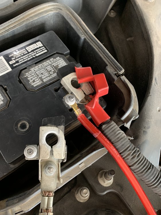

DokJ Posted April 13, 2020 Author Report Posted April 13, 2020 OK moved the power wire to the battery. Still have the noise. Here's a pic of the ground and the newly moved power wire. The reason I don't have the wires and fuse holder, etc mounted is because I'm still testing things and was waiting to do all of that until I got everything running right.
Joshdashef Posted April 13, 2020 Report Posted April 13, 2020 1 hour ago, DokJ said: OK moved the power wire to the battery. Still have the noise. Here's a pic of the ground and the newly moved power wire. The reason I don't have the wires and fuse holder, etc mounted is because I'm still testing things and was waiting to do all of that until I got everything running right. If you have a multi meter test that ground connection to see if it has a high resistance. If it does find a better ground, avoiding seat belt bolts. SMD Tool Map (2024): https://www.stevemeadedesigns.com/board/topic/226545-smd-tool-map-2024/ Great Box Bracing Examples: https://www.stevemeadedesigns.com/board/topic/202148-best-way-to-brace-a-box/?do=findComment&comment=3055002
