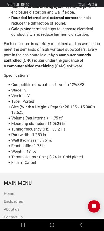

I'll start off with what I got and in what
-2000 toyota tundra access cab.
-DC audio lvl 5 12in.
-Sonix enclosure Stage 3 ported for JL Audio 12W3V3 × 1.
-deaf bonce aak-4000.1d
- pioneer avh-x4800bs
I know I know the enclosure isn't ment for my DC lvl 5. I was inpatient as my subwoofer was a few days away from showing up on my doorstep and came across the enclosure really cheap on Facebook market so I figured I'd try it.
Got everything button up and tuned my amp with SMD dd1 and cc1, radio volume maxes out at 40 but I set and tuned it to volume 30 ( tweeters too loud for me even past 25 )
So the problem I'm having is it hit good and low around volume 20 but when I'm turning it up it almost seems like it gets louder but not as much bass if that makes sense.

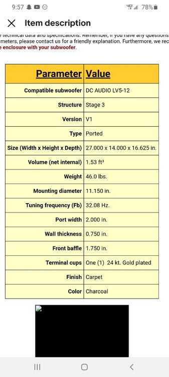

Here the specs on both boxes, the one I bought and the one they sell on ebay for my dc audio, I'm guessing it might have something to do with the port?
If anything i'll have to save up for custom box.
