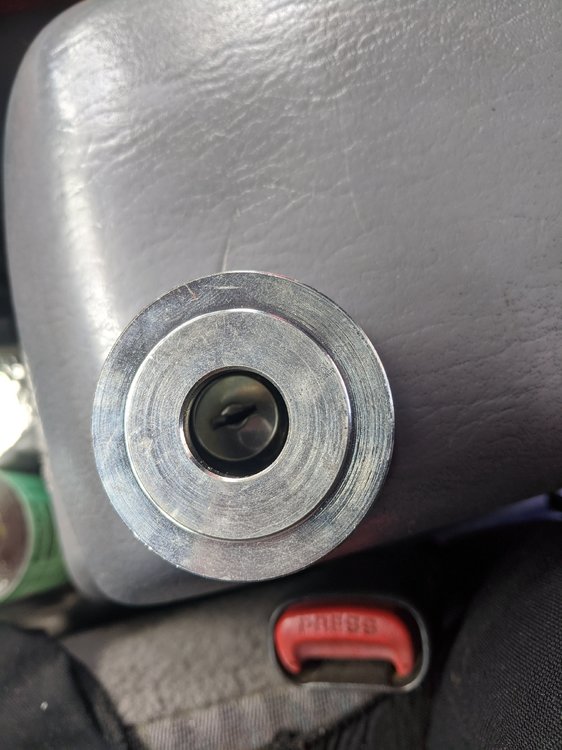

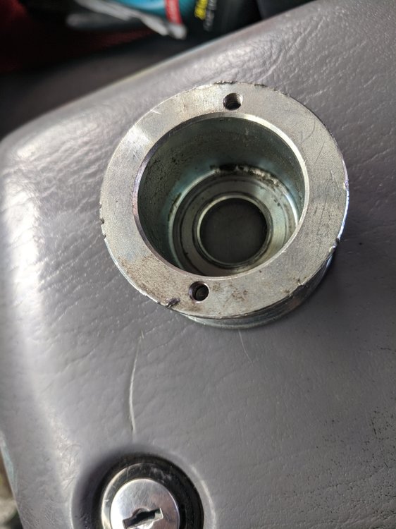

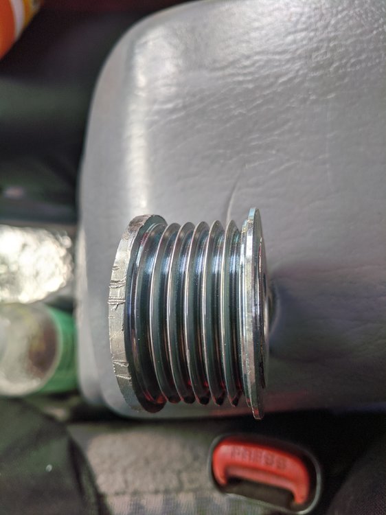

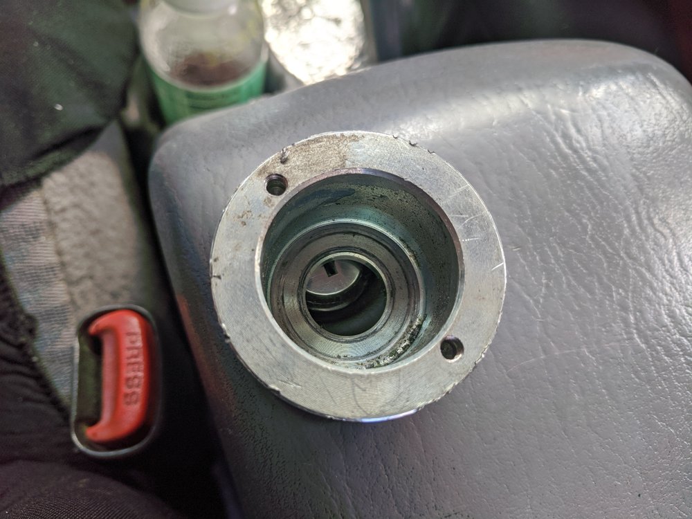

Here's pictures of the pulley that came on the Singer alternator

There’s not that much belt wrap on that alternator. Put the pulley that came with that alternator back on and get a belt that 1/2” smaller than the sock belt. Go to another mechanic. Your mechanic might be getting high during the rough times and making errors lol!
:guido:
If you can find a belt 3/4” smaller then go with that but if you can’t then a belt 1/2” smaller will work just fine because if there’s any slack that can cause slip, the tensioner will make up for the slack. Make sure you understand the difference between effective length and outer circumference. If you can, it’s best to go by effective length. Some belts only have outer circumference size listed. So figure out both lengths on your stock belt and go from there.
:guido:
Looking at autozone I found that the stock serpentine belt for my vehicle with A/C is 91" so with 3/4" less I would need 90.25" I am not sure if they make a belt that size or where I would begin looking. Could someone throw out a brand that I could rely on?

go to rockauto.com look up the factory belt for your car see how many millimeters long it is then go to your local auto parts store like O'Reilly's and ask for a belt that's 12-18mm shorter.
this is what I did in the kit O'Reilly's grab me every option that was under my belt size brought them to the front counter and I was able to look and see which one I wanted buy a Gates belt
If you can’t find an effective length 3/4” smaller then go 1/2” smaller or somewhere in between. It’s ok. I kept calling different auto parts stores and told them I needed a belt within x” and x” until I found what I needed. Try to get as close to the 1/2”-3/4” difference that you can. The tensioner in your pulley system will make up for a little slack if there’s any.
:guido:
I ended up getting a 1/2 smaller effective length belt. Need to wait for my friend to bring back my alternator to reinstall it, long story. I hope the belt works. Not sure what to do if it does not.
