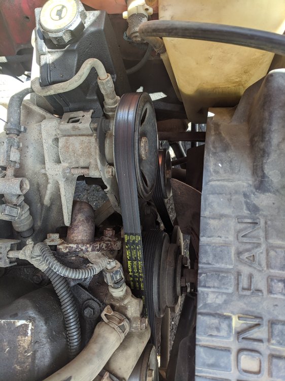

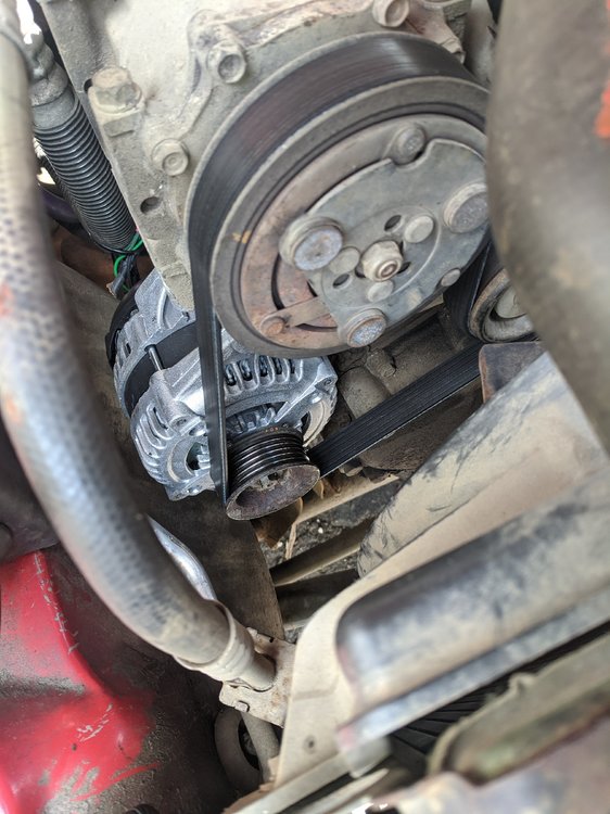

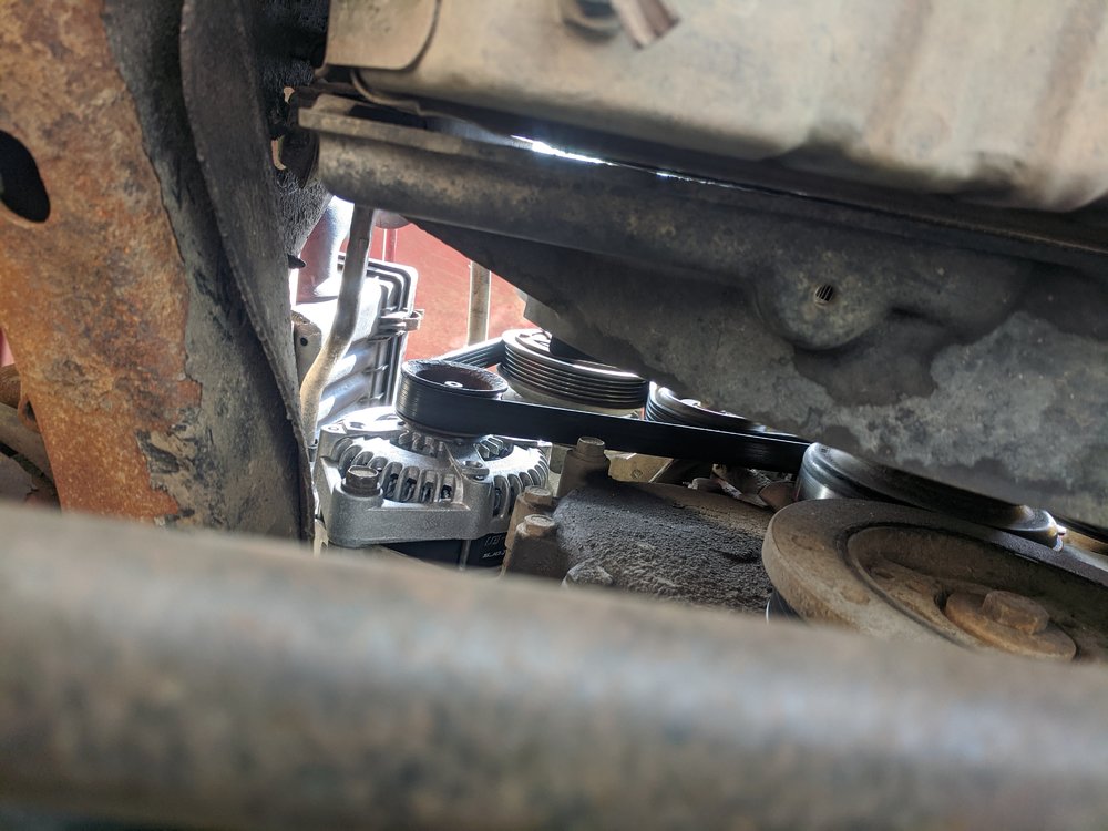

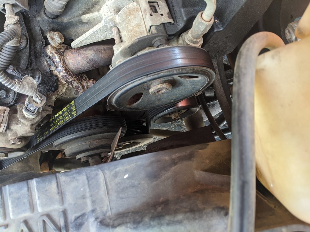

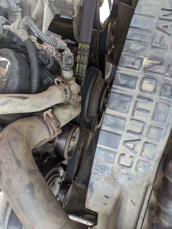

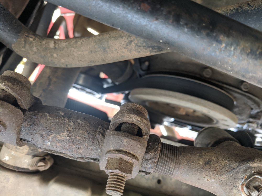

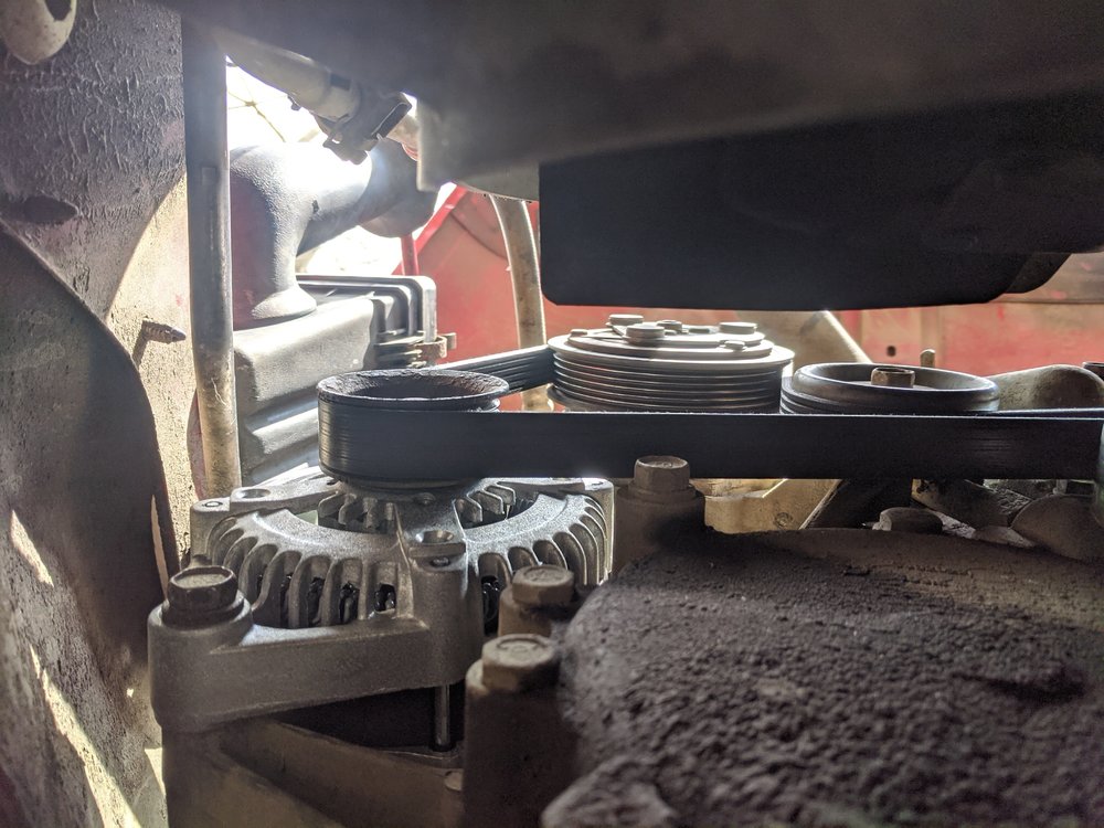

1point21gigawatts Posted April 16, 2020 Report Posted April 16, 2020 Take a picture of your alternator under your hood and it’s pulley and the belt wrapped around it. Take multiple pictures from different angels and then post the pics so I can get a better idea of your set up. “How can we help you?” “And don’t forget to tell them that the customer isn’t always right.”

CommonSyns Posted April 16, 2020 Author Report Posted April 16, 2020 Here are the pictures that I could get of my alternator system. I am not sure if this would help. Skar Audio SDR 10" x2 (Sealed Box) Skar Audio 1500.1D (1 Ohm) x1 Skar Audio TX525c (Front with dash tweeter) x1 Kenwood Excelon KFC-X173 (Rear Coax) x1 JL Audio 360.4 (Mids & Highs Amp) x1 DEH80-PRS XS Power d3400 Singer Alternator 275A 98 Jeep TJ 4.0 5 Speed
