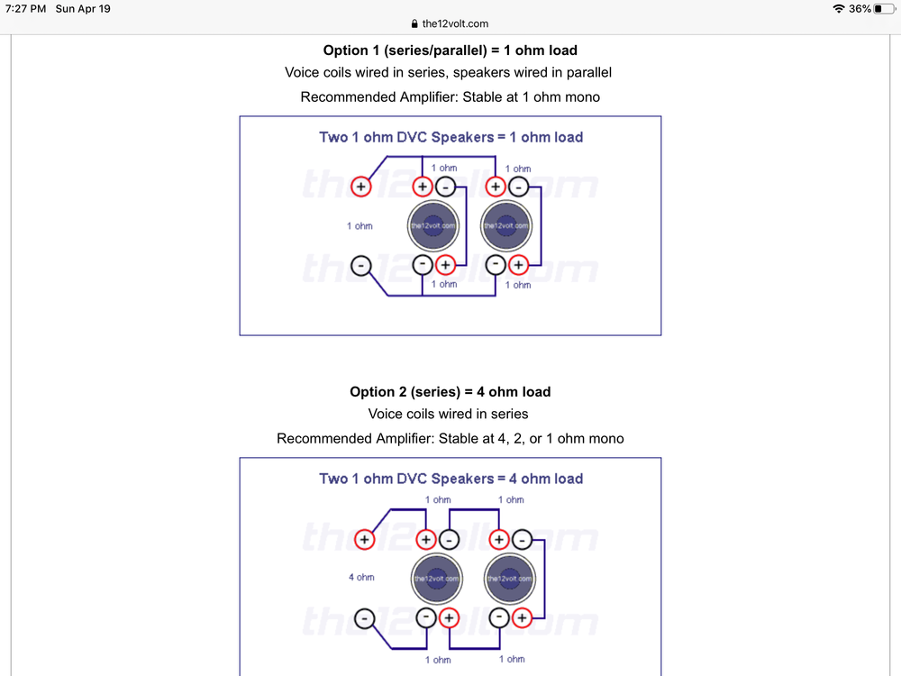

I'm looking to buy two subs. They only come with either 2 ohm DVC or 1 ohm DVC configuration. My amp is a 1 ohm mono amp. How do I wire two of these subs to this amp with a 1 ohm final Impedance?
The dual 1 ohm subs can be wired to 1ohm as long as you get 2 of them
Thanks dude, I looked all over for that diagram lol
