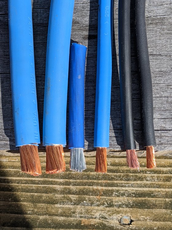

SHCA is not bad stuff. You just have to know what you're going to get when you buy it. You pretty much have to stick with their stuff to ensure it all works together. I say "all" but I mean their terminals to work with their wire. The SMD fuse block won't be a problem because you're just sliding the terminal over the posts of the SMD. Another reason to know what you're getting is to know if you have room to run it. If you order 2/0 and it comes the size of 4/0 you might have a lot more difficulty running it than you anticipated.
If you're just looking for the cheapest 2/0 check out wireandsupply.com and look at their 2/0 welding wire. I ordered several 1 foot pieces a while back so I could see the sizes. I used their 4 gauge in my son's car, and that's where I'm going to first from now on. If you were looking for 8 gauge, their prices are no better than SHCA or Knukonceptz, but once you get to 4 gauge and bigger they are a lot cheaper.
Here's a picture I took a while back of the welding wire OFC samples I got along with Knukonceptz 4 gauge and SHCA 8 gauge.
From left to right, welding wire (ww) 2/0, ww 1/0, Knukonceptz 4 gauge, ww 4 gauge, SHCA 8 gauge, and ww 8 gauge.
The Knukonceptz is tinned. It's not CCA.
I also took measurements of the diameter of each wire with the calipers if anyone is interested. Just let me know.

There 2/0 lugs fit there 2/0 wire just fine. Don’t know what the problem is, you got more then you paid for.
Only bad thing about SHCA wire is the sleeve likes to move.
