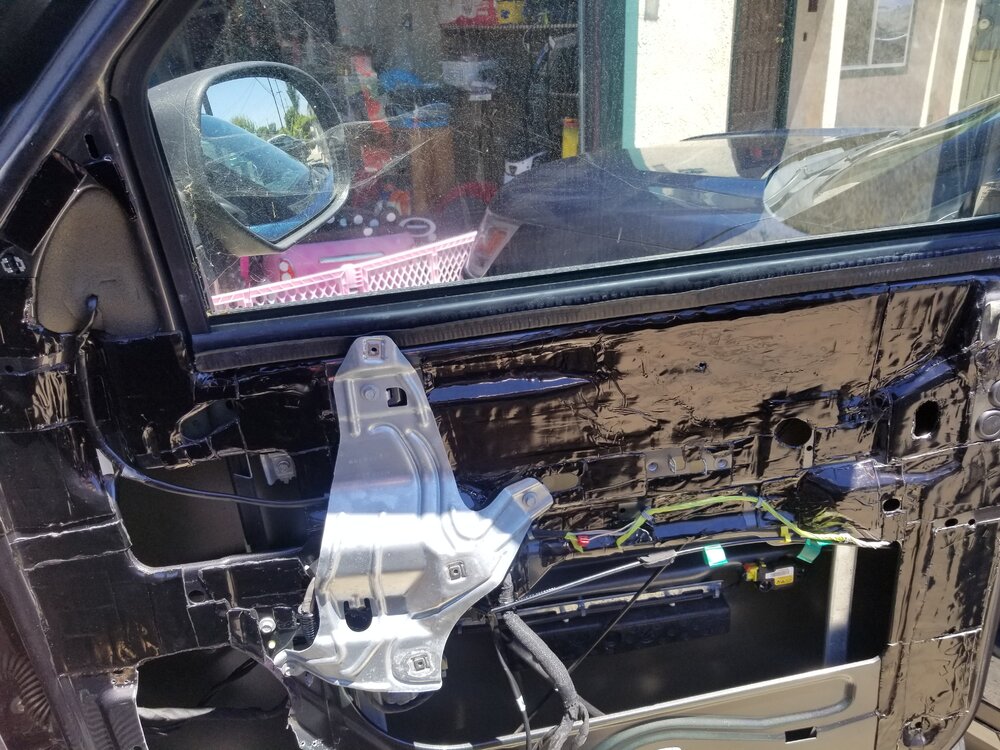

This is how slow this build is going....I just finished sounds deadening a single door lol. Took me almost a month🤣. I didn't do the whole door because I don't know if anything needs to be cut for my door pods. And yes, I went to the Ray Charles school of applying sound deadening lol
Ha! Ray Charles school of sound deadening!
