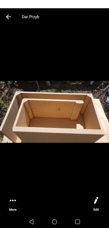

Nah man. This enclosure was designed by me and a builder buddy of mine. I used torres and also my builder tweaked it more with winisd i believe. Its not prefab. Its custom. Its 2 cubes after sub, port, double baffle and bracing displacements. It sounds decent. But i think i can tweak it more to adjust the sound to hit a wider band and focus more on the 40 50 60hz u know where most music has its basslines and also to get more spl/output. Ill try your bigger box suggestion and see what happens
This is my current box. One thing that worries me now since triticum told me this bit of info yesterday. The distance between the port wall and the box side wall should be at least 2x the width of the port. So for this box that would be 6.50 inches. This is less than that..
This box is maybe 4 inches... I guess that will mess with the sound in some way. I think he said it messes with the frequency? I forgot
The distance between the enclosures side wall and the port should be at least the same size as the width of the port, not two times bigger. You read wrong dude. He said that if the port is not at least two times the width of the port away from the side wall the it could affect the tuning a little bit. Minimal.
No, he didn't read it wrong.  I did say it should be two times the width of the port so as not to affect the tuning frequency.  It has to be at least one port width away to keep from obstructing the airflow.
Think about it this way.  If the end of the port is exactly one port width away, it will extend the effective length of the port.  You can use this to your advantage sometimes to get a longer port.  You need to plan for it though.

Anything less than two port widths away has a good chance of affecting the tuning frequency.  Generally this isn't a huge deal, but just something to keep in mind.   Anything less than one port width away will likely impede airflow and at that point it will negatively affect output.
"Anything LESS than 2 port widths away has a good chance at affecting tuning frequency." Mine is 1 or just a touch above 1 port width away. Hence, its less than 2 port widths away hence its affecting tuning frequency by making the frequency actually lower than what i thought it was. I thought i was tuned to 34 but im probably really tuned to 31 or 32 mmmaybe even 30
Im lucky its not less than 1 port width away..came close..damn close. I will remember that my next boxes clear at least 2x the port width between side wall and port wall entry point to keep tuning on point.
