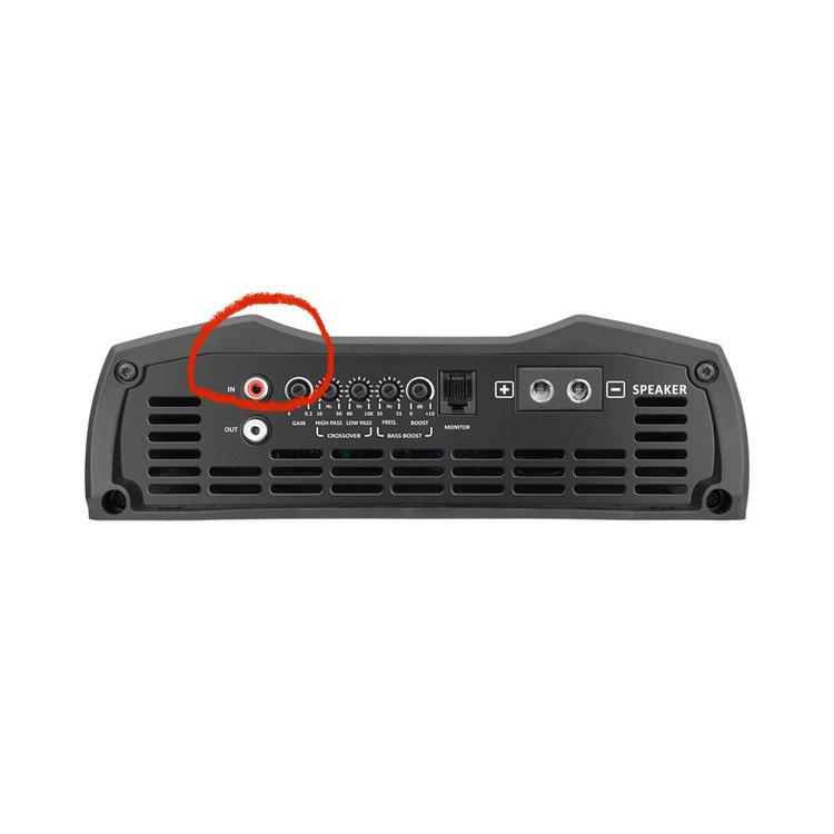

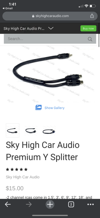

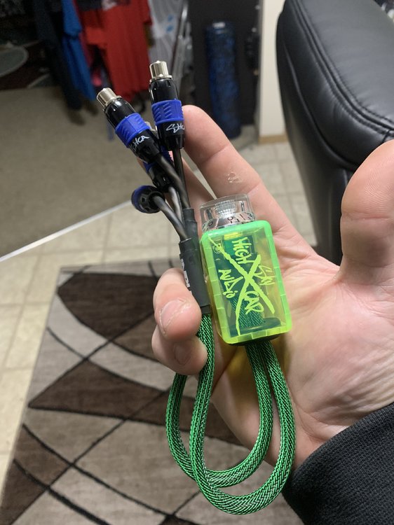

Spazy808 Posted June 14, 2020 Report Posted June 14, 2020 So I bought the taramps smart 3 and didn’t know till just yesterday that the two rcas on the amp are labeled as “red” input and “white” output. So my question is can I run a Y splitter from my bass knob to the red input and be fine. I attached pics of what ima be using. Or do I just plug in the rcas like normal. I’ve never seen a amp with just one input.

Joshdashef Posted June 14, 2020 Report Posted June 14, 2020 That amp is a monoblock amp, so it has only one channel. You really only need one RCA to get signal to it, but you can just run a pair of RCAs to it and use a y splitter (2 female into 1 male) to plug into that red input on the amp. Do not plug in both rcas into the input and output. SMD Tool Map (2024): https://www.stevemeadedesigns.com/board/topic/226545-smd-tool-map-2024/ Great Box Bracing Examples: https://www.stevemeadedesigns.com/board/topic/202148-best-way-to-brace-a-box/?do=findComment&comment=3055002

Spazy808 Posted June 14, 2020 Author Report Posted June 14, 2020 Okay good so I didn’t order that y splitter for nothing then thank you guys
