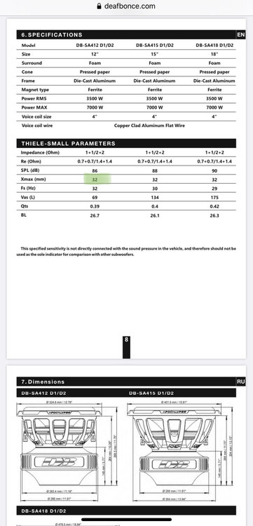

Savard just put 40mm overall. Regular companies don’t list overall subwoofer movement. They just list xmax. I have subwoofers that are over 100 pounds and can handle a shit ton of rms. It says the xmax of my subwoofers is 32mm which is almost 1.3 inches. Do you honestly think a big ass super strong subwoofer only moves a little more than a half inch up and a little more than a half inch down. Fugh no. It moves 32mm in one direction. Xmax. Savard is the only company I’ve ever seen that lists overall subwoofer movement which I’m gonna say this again, IT CONFUSES NOOBS.

It certainly does....but you just proved my point. SOME companies give peak to peak and some linear. Im really not entirely sure why we are arguing 🤷🏼‍♂️
Just like we are often left to wonder if the Xmax was derived by Thiele, DUMAX or Klippel models.
