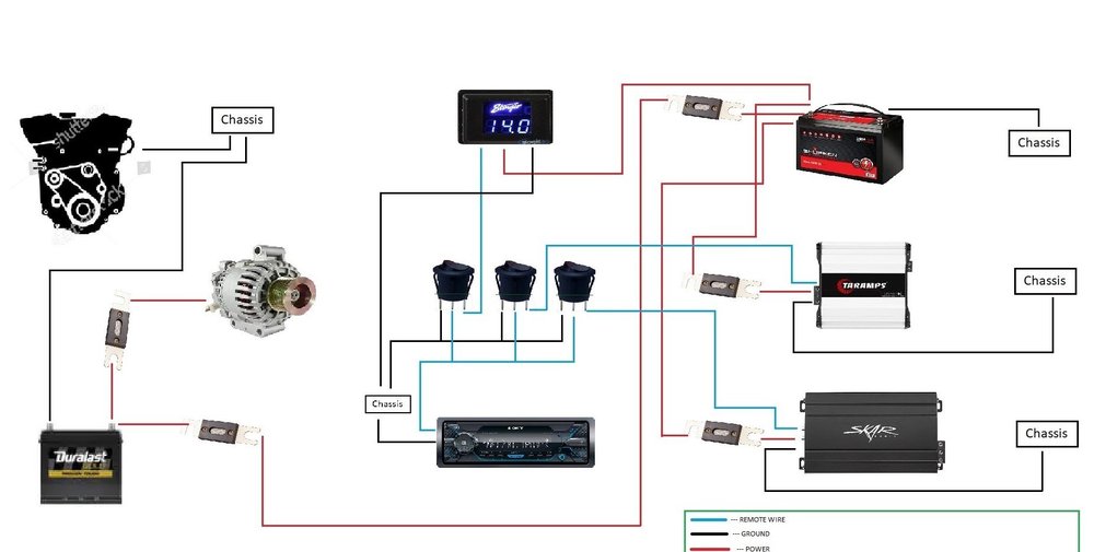

need a double check
I'm just looking for a a double check on my wire diagram and make sure i have it right . I like to visualize my setup so i don't fuck up.
Reason for toggles is to have control over what i want on at any given time especially for long ass drives.
All fuses except skar amp are 300amp
Alt is a 270 from js
Agm is 120ah
Hood batt is wet cell, upgrade later
Big 3 is done all SHCA OFC 1/0
Looks good , I put switches on my sub amp too for when I’m listening to baseball or sports radio
There is one
:guido:
thanks dude yea not everything i listen to needs 3k bass lol.
