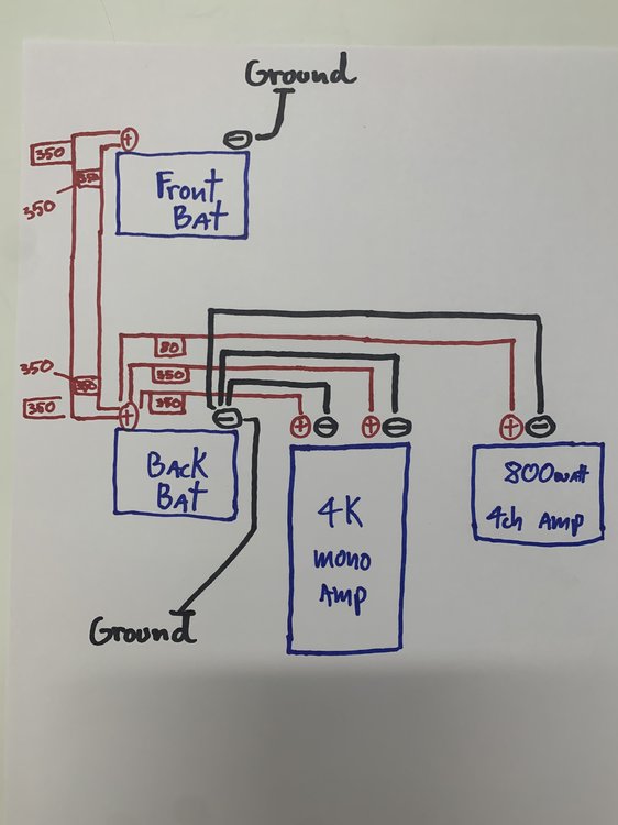

here is a QUICK sketch of my planned wiring. Should i run 2 grounds from the back battery to the frame or is 1 fine? And im planning on 2 runs of 1/0 between both batteries, should those runs have a 350a fuse? Let me know what you guys think. Thank you in advance
Looks good. But it would be better to ground the amps to the chassis or frame instead of the battery. That would be better for a more stable voltage. Better grounds.

I would run one of those front positive runs from Alternator to rear battery. Other then that looks good. Not everyone does it but to me it makes sense front Alt gets Alt to battery so why not rear.
It splits the current which helps the voltage stabilize. So separating the runs like that would separate the circuit and cause the current to not split correctly. It seems smarter to do what you are talking about but it is not as efficient.
