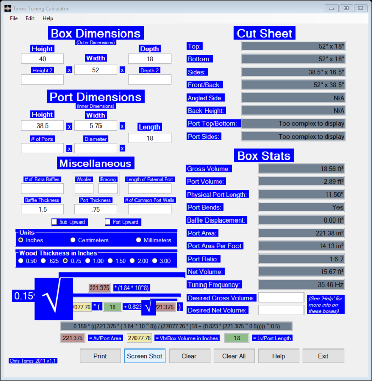

building a new box for 4 skar zvx 15 subs in extended cab truck so im pressed for space, subs will be facing foward with port on driver side, but i need help with the port
box will be 40H X 52W x 18deep, i want port to be full height, 38.5 but how wide and long is what i need help with, i attached a screenshot of current situation, hows it look? take it easy on me im learning. lol

27 minutes ago, T2Raw4U said:
anyone?
I know the Torres calculator is a popular one, but I'm not sure how to read it. I usually just do all of this with a piece of scratch paper and my calculator.
I used this one earlier today (so I could post pictures for him) and it worked very well. You might check this one out....
https://subbox.pro/en/design/?bt=2&bw=1016&bh=457.2&bv=203.9&mt=19&fp=1&sq=2&ss=15&cd=354.3&md=219.7&sv=3.4&so=-76.2&sd=20&sb=75&sn=EVL&pt=4&pq=1&rf=31&pd=271.98&pw=2&pa=580.68&pp=100
Looking good at fist glance, I personally would tune a tad lower.
Around 30-32 I've found to be the sweet spot on my most successfull daily all-round boxes.
