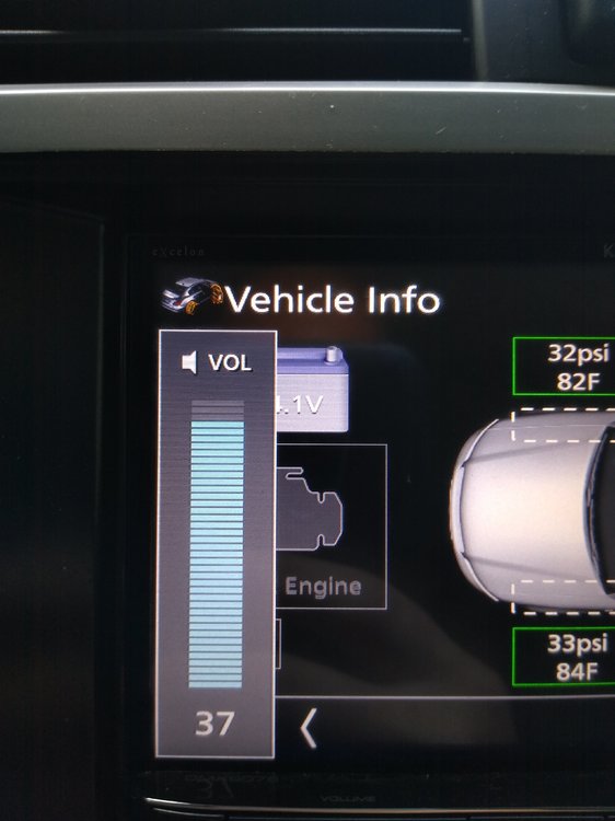

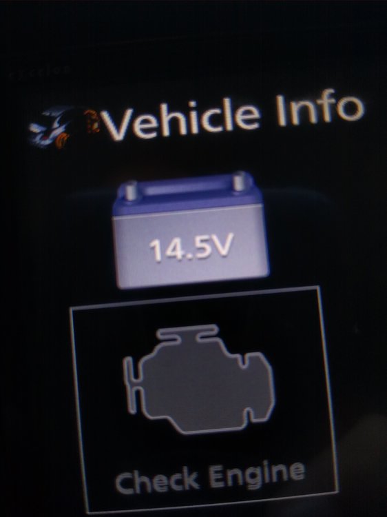

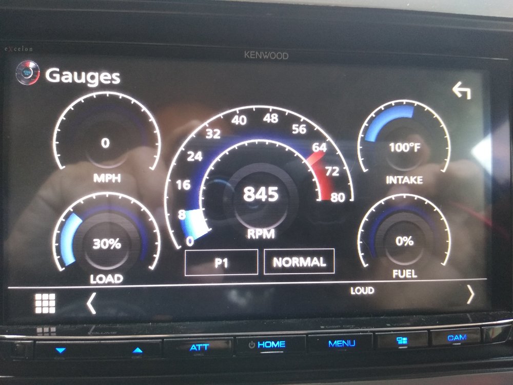

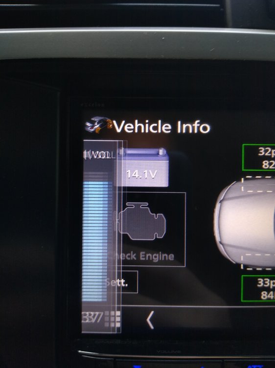

First picture is my real output of my alternator, tested at varied RPMs.
Then my lowest idle RPM.
Then my voltage, this was after towards the end of a 45 second 40hz sine wave, also showing volume is up all the way to right before clipping. This is at idle. Sitting at home right now. It's currently 87 degrees.
Last my voltage with the system's volume turned down to zero.
250 amp alternator, sundown 2k amp at 1 ohm, regular stock panasonic lead acid battery with only 65ah.
