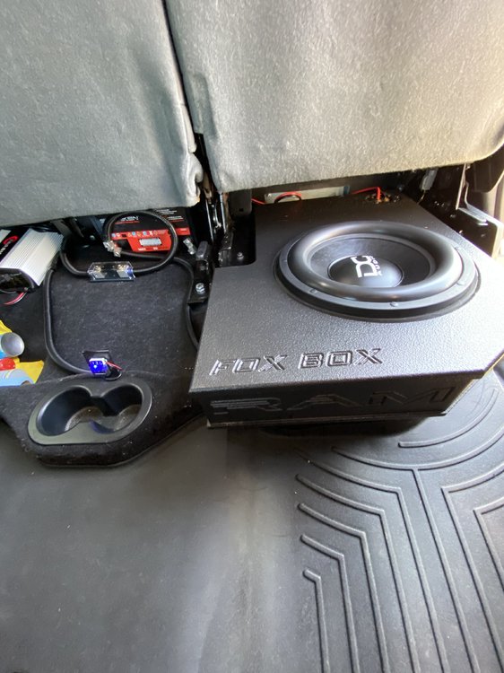

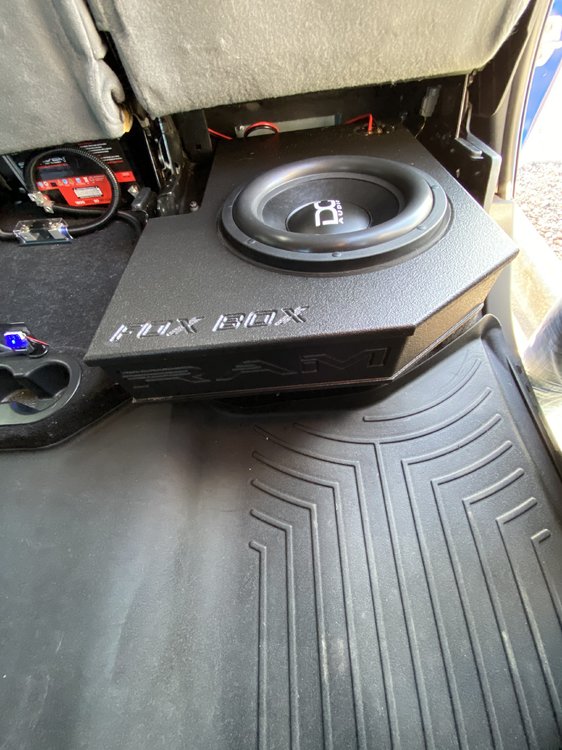

Just a ‘16 ram with a dc 12!

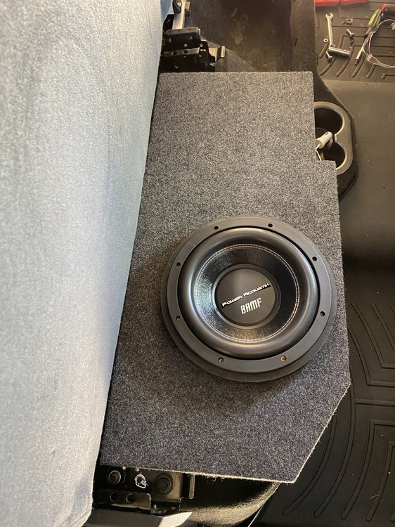

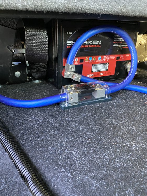

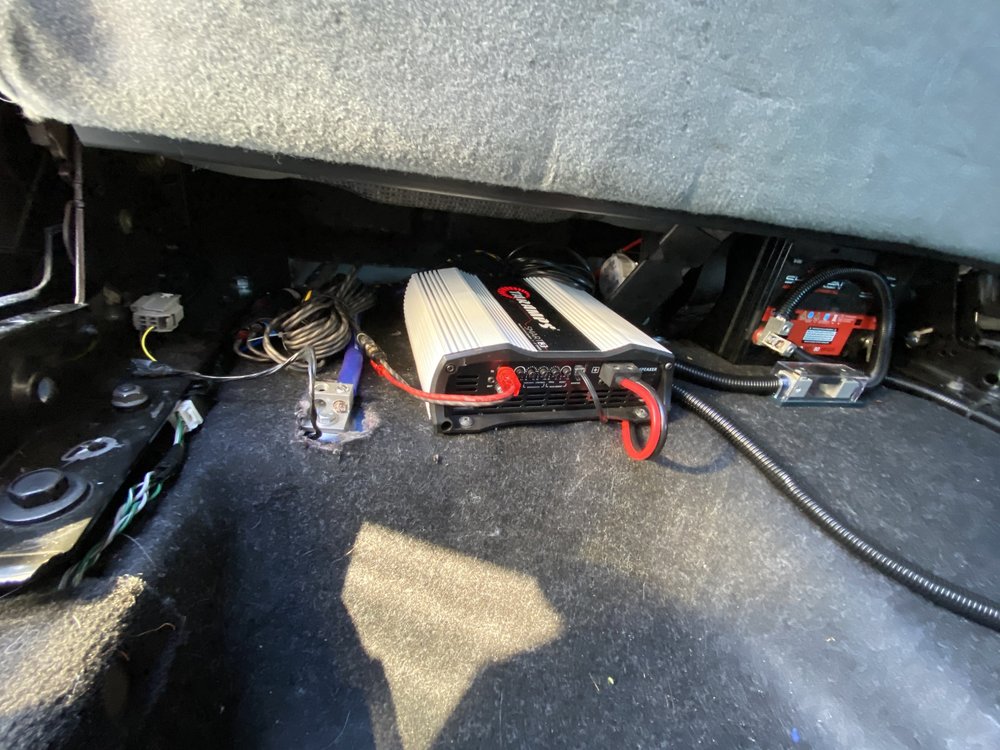

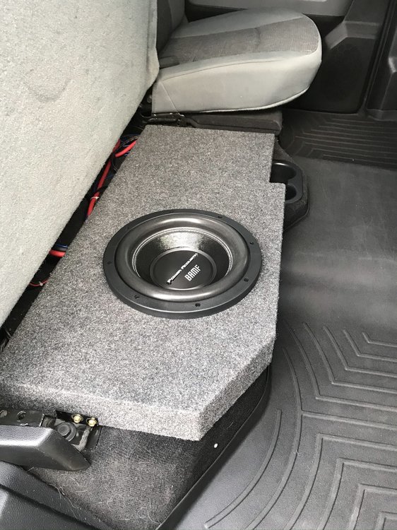

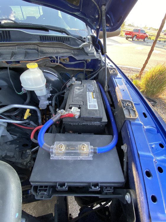

Started out with a soundoffaudio passenger side box and a Power Acoustik 10”.... couldn’t pass up the deal on this fox acoustics  driver side sealed 12” box! Upgraded + alt to batt +, battery - to body, fuse box + to battery +. There is also a ground below the box, which bolts straight though to the frame, due to my switching sides back and forth with installs lol. So the install now- stinger 1/0 OFC, taramps smart 3, which is a beast! Aux shuriken battery, fox acoustics sealed .95cf box, net audio pac LOC which plugs into the stock subwoofer plug, and a lvl 2 dc 12”, has a 3/4” raiser ring in anticipation for lvl 4, while I wait another 7 days for the lvl 4 with custom dust cap!! My first system I’ve ever installed myself.

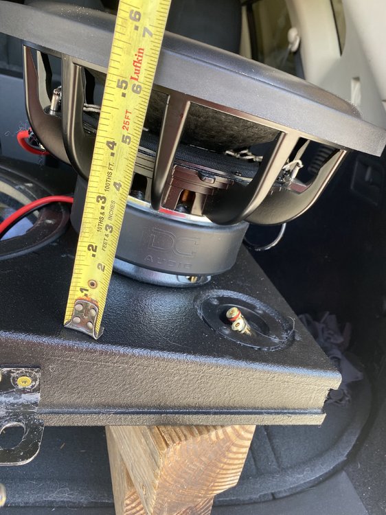

Whatever the diameter of that pole vent on the bottom of the magnet of that subwoofer you are getting, it has to be AT LEAST that far from the wall it’s facing. So make sure that spacer is thick enough. The mounting depth of that subwoofer you are getting is 6.75” and the pole vent appears to have a diameter of about 1.5”-2”. So do some measuring when you get that subwoofer and then make sure it’s done correctly because if it’s too close then the subwoofer won’t have enough breathing room and not be that loud and get hot while doing so and eventually give out even on rms less than rated.

Copy! Something I think I understand but makes absolute sense. The box without spacer allows for 7” depth. Spacer is 3/4” with another layer of a foam sealer which I’d say is maybe 1/4”. With that considering, would pulling the poly fill from directly underneath the driver be a good idea?
Take the poly fill out of that enclosure and never put it back in and add another .75” spacer to equal a total of 1.5” if the pole vent is 1.5” in diameter. But if the pole vent has a diameter of 2” then you would have to use 3 .75” spacers.

Copy. Will pull out the poly fill! And will verify the vents, one of the lead builders at the shop I use knows rusty @ DC personally so he should be of much help  As are you! Thanks

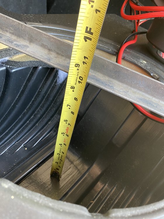

As the box sits, I have just over 10” of mounting depth not counting compression of foam as sub gets tightened down. Sub lip to bottom of driver is 6-1/8”. Pole vent in driver is 1-1/2” on this level 2. I hope that’s sufficient!
