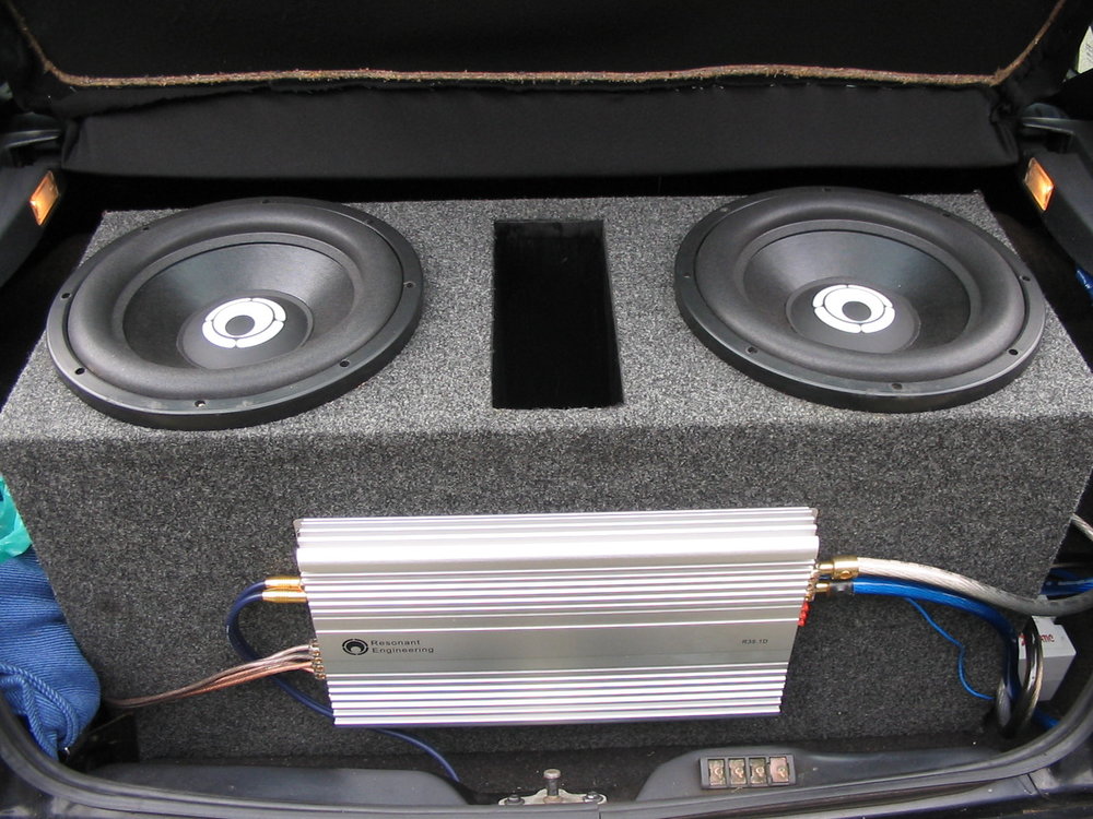

Now i also have a mk3 ford fiesta and the bass is exactly as i like it goes deep and loud. It used 2 x 12inch reaudio se12 subs on the re35.1d amp also from resonant engineering.
I will get some pics up of it. But it uses all the boot space since its a ported box of 4.8 cubes.
I guess im trying to replicate the sound on a smaller scale so it doesnt eat up the boot space since i use the celica for the shopping run. Sometimes use fiesta for shopping but have to use the back seats. Wasnt a issue back in the days but now with kids its a problem.
here is a photo attached. so i guess what im trying to do is replicate this sort of sound but in 1cuft space. its been 18 years since i got the reaudio setup so wondering if technology has advanced enough since then for me to achieve my goals.
Honestly, I would buy another subwoofer with a higher rms handling and then put it in a custom built ported enclosure and then buy another amp in the future. But if you can only pick buying a ported subwoofer enclosure or that alpine subwoofer then I would definitely pick buying a ported subwoofer enclosure. Because that small sealed enclosure would never replicate the same sound in a smaller scale as that other setup. But a ported enclosure would, more or less.

Are you sure that you can’t put a 1.5 cubic foot enclosure or a 1.75 cubic foot enclosure? Because to come close to replicating the the other vehicles sound you would have to install a ported enclosure on a 12 inch subwoofer. Because an 8 inch subwoofer or 10 inch subwoofer won’t sound as deep as a 12 inch subwoofer or 15 inch subwoofer. Make your wife go shopping or store groceries smarter with a bigger enclosure. It’s possible.
