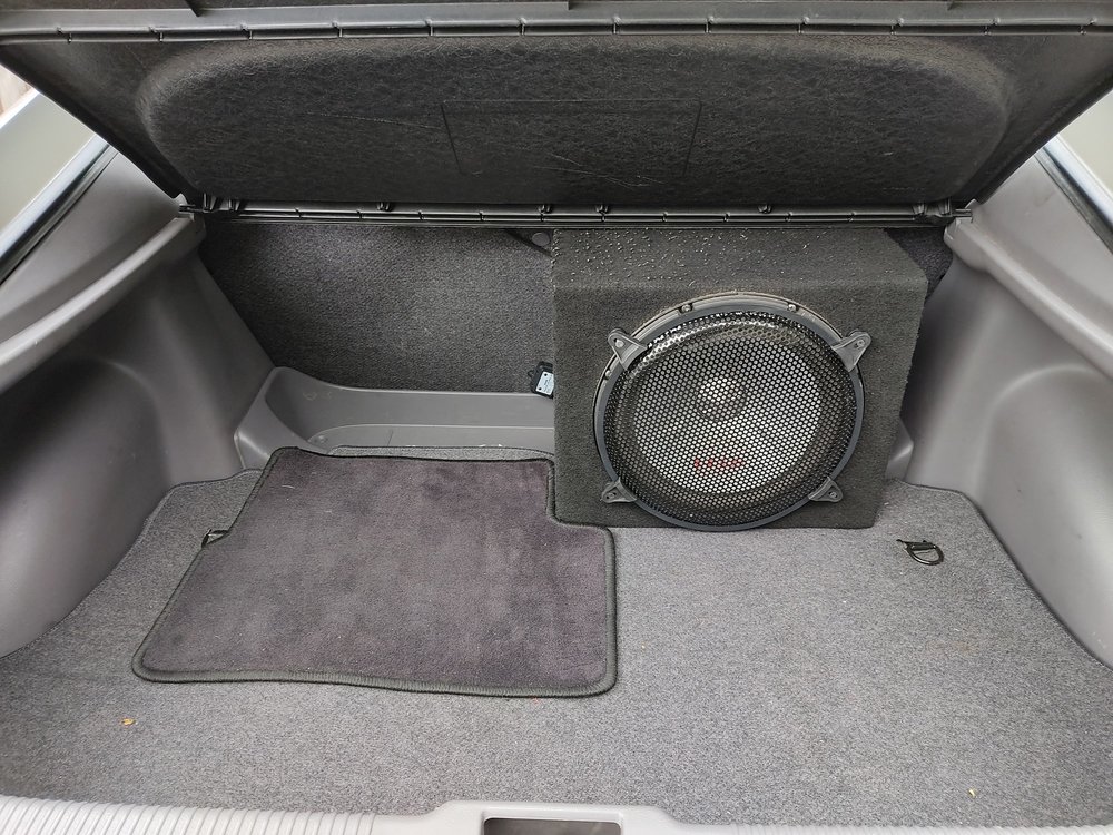

slybu Posted August 19, 2020 Author Report Posted August 19, 2020 Wow didnt think there would be such a difference in a small sealed box. Iv attached a pic of my setup. Iv got a pioneer 12 inch tsw-304c sub in 1cuft sealed box. I have a grill over the sub now. Amp is alpine mrv-t707 so 240w rms Any recommendations for subs that will fit in the box and sound better? As in deeper etc?
1point21gigawatts Posted August 20, 2020 Report Posted August 20, 2020 I can tell you a subwoofer that would sound better in that enclosure but for a deeper sounding bass response, the enclosure has to be bigger. Smaller the enclosure, the bass response is quicker, which generates a tighter and punchier bass response. Bigger the enclosure, the bass response is slower, which generates a deeper bass response. This is because the smaller a subwoofer enclosure is, in reason, not like crazy small, the better control the subwoofer has. Think of it like this, a breeze moves easier, better and quicker through a small area but kind of lingers and dissipates slowly in a big area. A good sounding. A subwoofer enclosure is far more important than the subwoofer itself. A subwoofer enclosure is the second most important thing in reference to a car audio system. The most important thing in reference to a car audio system is the vehicle’s electrical setup that feeds the car audio system. “How can we help you?” “And don’t forget to tell them that the customer isn’t always right.”
1point21gigawatts Posted August 20, 2020 Report Posted August 20, 2020 So basically what I’m saying is, the most optimal way to change the sound of your car audio system when you are just looking to change one piece of your car audio system, is to change the subwoofer enclosure. Changing the subwoofer on the same amp won’t make a huge difference. Noticeable depending on the subwoofer swap, but not huge. But changing the enclosure to a size or enclosure type completely different would make a huge difference in the sound of your car audio system. “How can we help you?” “And don’t forget to tell them that the customer isn’t always right.”

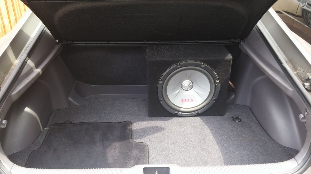

slybu Posted August 20, 2020 Author Report Posted August 20, 2020 i dont want to give up any more boot space but wondering what would difference be if kept same box size but switched to a 800w rms sub and amp combo? would it be just louder? also updated pic with the grill on the sub:

1point21gigawatts Posted August 20, 2020 Report Posted August 20, 2020 5 hours ago, slybu said: i dont want to give up any more boot space but wondering what would difference be if kept same box size but switched to a 800w rms sub and amp combo? would it be just louder? also updated pic with the grill on the sub: What kind of budget are you trying to stay around? “How can we help you?” “And don’t forget to tell them that the customer isn’t always right.”
slybu Posted August 20, 2020 Author Report Posted August 20, 2020 Cheap really. Around 160 british pounds. Iv seen an alpine 12 type r sub in that price point. Sundown audio lcs 12 seems very good value but not sure how these will sound compared to what i have at the moment.
1point21gigawatts Posted August 21, 2020 Report Posted August 21, 2020 160 pounds isn’t enough for a 800 rms amp and another subwoofer. But alpine type R’s are super good subwoofers but for it to sound totally different and better than what you have now is to buy a bigger amp. https://www.skaraudio.com/collections/rp-car-audio-amplifiers/products/rp-800-1d-car-amplifier# 1 ohm stable amp, so the subwoofer has to be dual 2 ohms. An alpine type r would pair nicely with that amp, don’t worry about matching the specs. After impedance rise that subwoofer won’t actually see 800 rms. It would see less. So don’t worry about if the subwoofer could handle that amp because it could handle an amp even bigger. For sure. https://www.crutchfield.com/p_500RW12D2/Alpine-R-W12D2.html “How can we help you?” “And don’t forget to tell them that the customer isn’t always right.”
