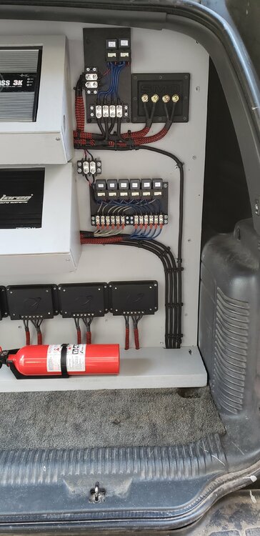

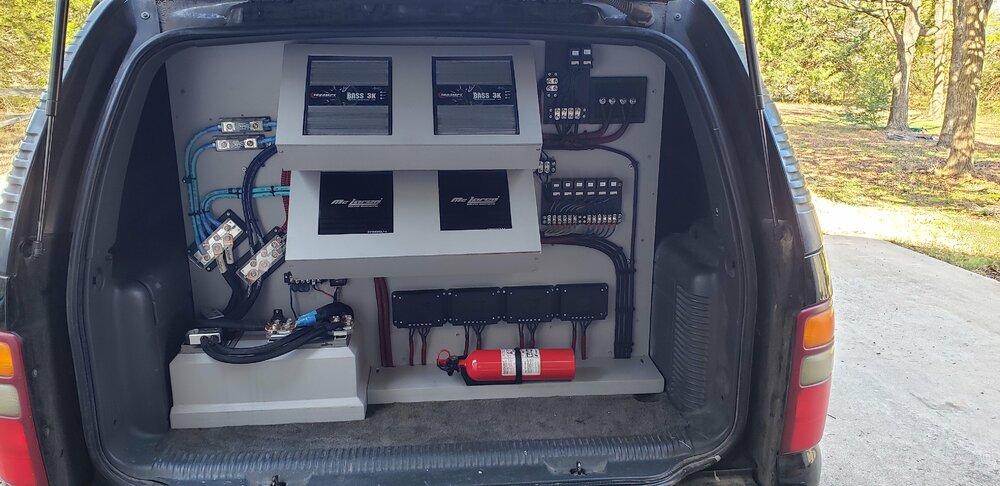

dog24fret Posted February 11, 2022 Author Report Posted February 11, 2022 Some updates on the system finally. Just too much crazy to explain. So crazy it sounds like a movie. Such is life I guess. With the help of many people plus Tony D'Amore and Tony Candela of CE electric. I have been able to eliminate almost all turn off sounds. Hardly noticeable even turning the key off before the stereo. Ended up using 8 spdt 50/30 relays for all speakers and subs. They get warm at full tilt but have not tripped once. Being done afterwards it still looks pretty decent to me. Cowboy Escort GrAnny ThUmper The Burp

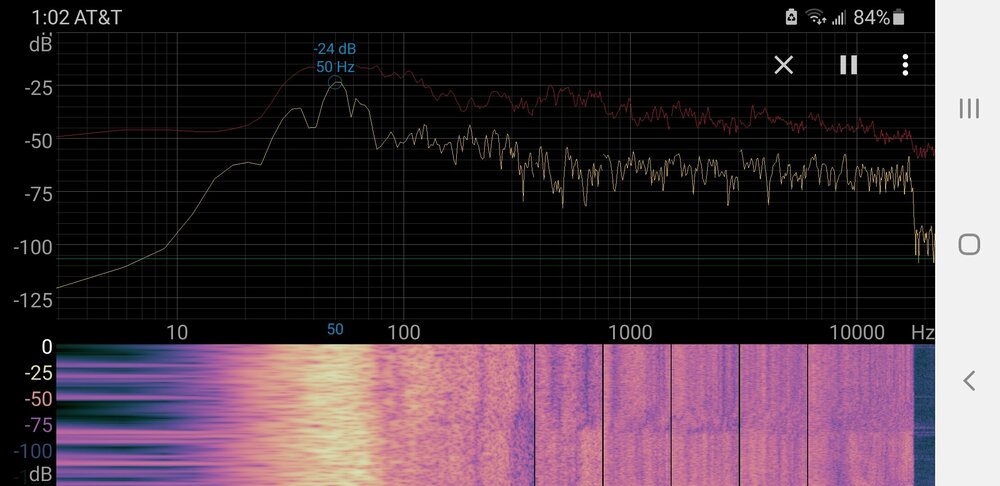

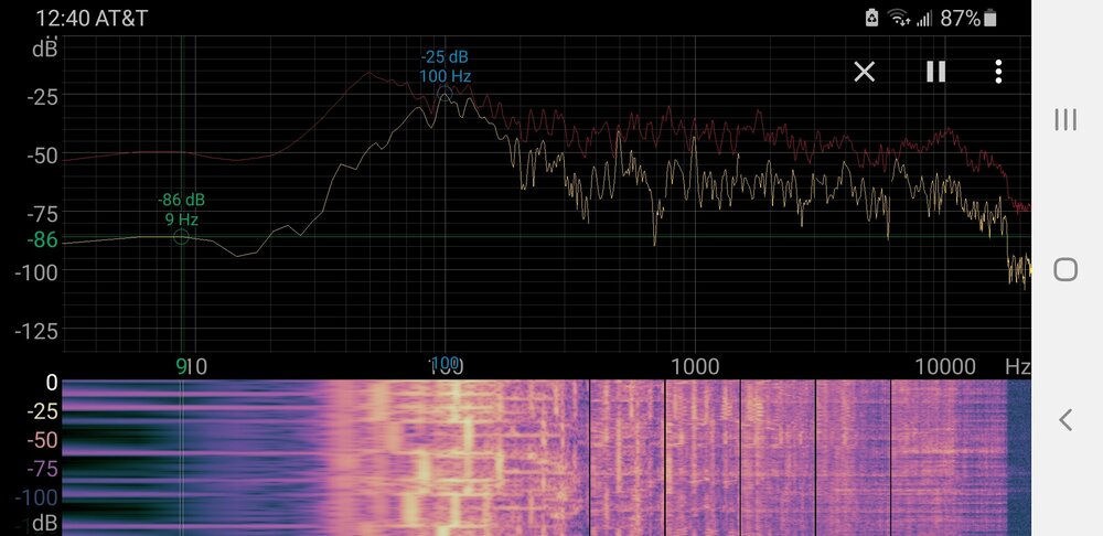

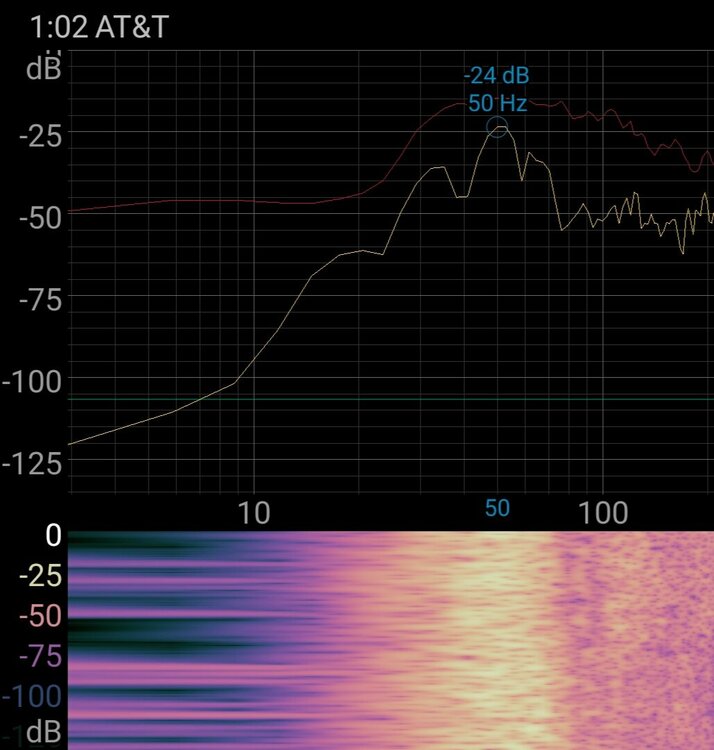

dog24fret Posted February 11, 2022 Author Report Posted February 11, 2022 It isn't the greatest thing to use possibly. I use this to keep up with live sound settings in church. I tried it in the burb. I used decent volume to test this with pink noise. I set the volume to 20 out of 32. The yellow is before and red is after. The first one is no eq settings yet. The second is afterwards and boy did it make a huge difference wow. The third one shows the bass responce which to me is pretty smooth. It rolls off at 33hz but I think it will do better if I play music with lower than 34. My bass mechanic from the 80's only goes to 35 with test tones. I need to double check my filters on the amps also. Any tips would be greatly appreciated. This is all new to me tuning this way. I can say you can in person hear the full orchestra and even the taps of the conductors stick. Cowboy Escort GrAnny ThUmper The Burp

Dafaseles Posted February 11, 2022 Report Posted February 11, 2022 1 hour ago, dog24fret said: Some updates on the system finally. Just too much crazy to explain. So crazy it sounds like a movie. Such is life I guess. With the help of many people plus Tony D'Amore and Tony Candela of CE electric. I have been able to eliminate almost all turn off sounds. Hardly noticeable even turning the key off before the stereo. Ended up using 8 spdt 50/30 relays for all speakers and subs. They get warm at full tilt but have not tripped once. Being done afterwards it still looks pretty decent to me. My amp rack won't be a clean, but I hope I can get close to how clean your wiring is! I love be some wire porn! I had a terrible time with my Tahoe's transmission and rear end. Finally I had to sell it because it was costing so much. 99 Tahoe police edition. I miss that truck though. 2011 Chevy Silverado under construction My build log here. Check it out!
dog24fret Posted February 11, 2022 Author Report Posted February 11, 2022 13 hours ago, Dafaseles said: My amp rack won't be a clean, but I hope I can get close to how clean your wiring is! I love be some wire porn! I had a terrible time with my Tahoe's transmission and rear end. Finally I had to sell it because it was costing so much. 99 Tahoe police edition. I miss that truck though. I bet yours will turn out fine. When I have to move everything. I'm gonna try to leave the wiring as is. Just redo it from the relays and blocks to the new spot wherever that will be for the amps. That sucks to hear. I'm finding out that these seem to have issues with the trans a lot. Not something I want to think about. I don't want to get rid of it. It is paid for lol Cowboy Escort GrAnny ThUmper The Burp
