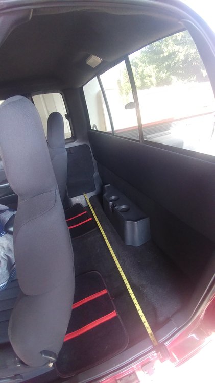

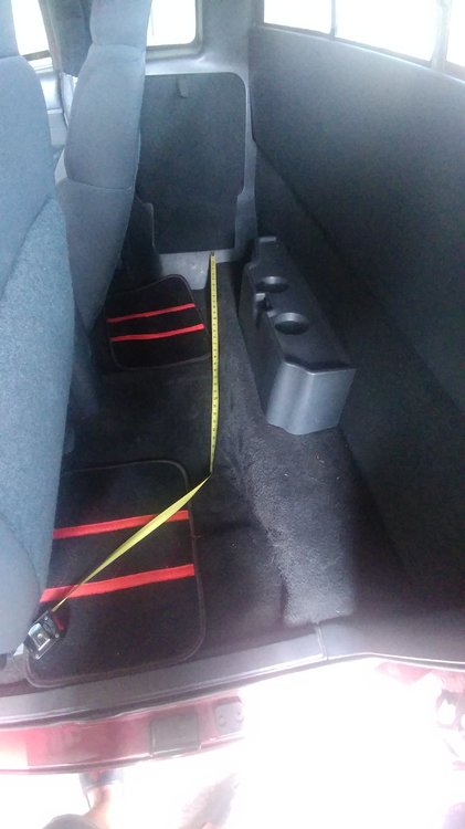

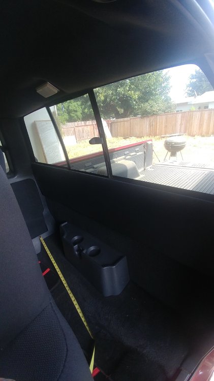

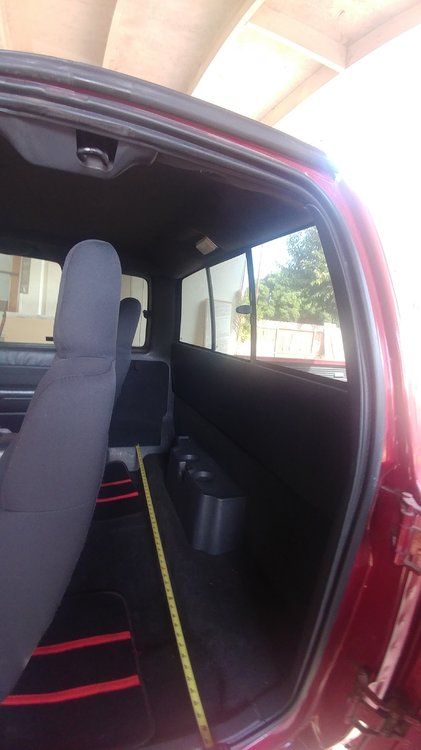

jessdabest77 Posted October 25, 2020 Author Report Posted October 25, 2020 Ok so this is the space available. I have the driver seat placed where I can drive. I measured 50.5" Wide x 24" Height x 16.5" Depth. If you need more information let me know.
CFD Posted October 26, 2020 Report Posted October 26, 2020 50 inches wide, 24 inches tall, 16.5 inches deep. Braced with 2x2's and 2x4's. Double baffle. 6.6 cu. ft. after basket displacement, ~32Hz tuned, 4Wx21.75H inch port, 26.5 inches long. Subwoofers up passenger side, port forward driver side. 11.5 inches of mounting depth before hitting the bracing. LMK if you are sure of your measurements and it'll fit, if you want it I'll make some cut sheets and stuff.
jessdabest77 Posted October 26, 2020 Author Report Posted October 26, 2020 Interesting, first time I've seen this design. It's been mostly sub's and port up or sub's forward port up. If I did sub's up I can go 17" Depth and 25" Height. I would like to play really loud and low. I do not compete so not worried about numbers I just want to play music and feel the bass.
CFD Posted October 27, 2020 Report Posted October 27, 2020 I think subs up, one on each side of the cab, port in the middle going forward or up would both be cool. I'd do whatever you like though. Getting that little bit extra air space in the box would be good for getting those lows to come out. This box I made is a bit on the lower end of the recommended for those subs (3-5 cu. ft. each from what I saw.) This box starts rolling off pretty hard under 30Hz but that's still really low. The port on this one would be firing into the back of your seat too, which might be nice for a back massage but might not be great for SPL. Not sure how much room between the seat and the port there would be and if it would breathe well. What exactly constrains you on height? Just don't want it to cover the window?
jessdabest77 Posted October 27, 2020 Author Report Posted October 27, 2020 I can do 17" Depth x 25" Height x 50.5" Wide. Hopefully that helps thanks.
