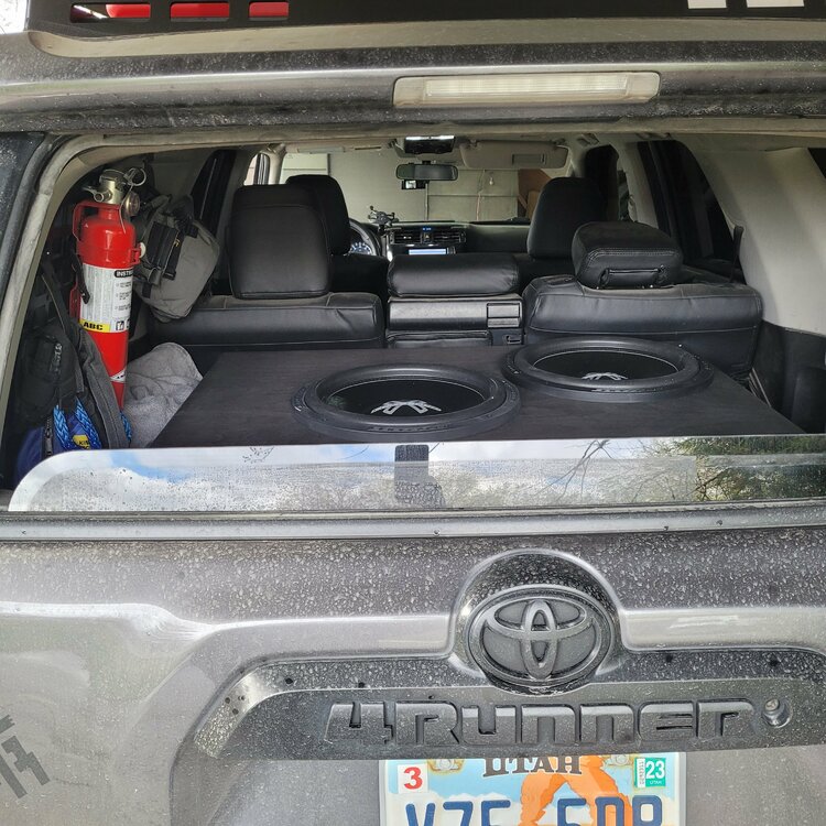

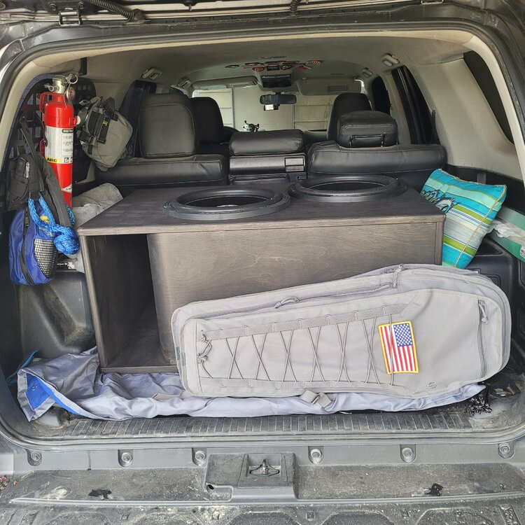

Dafaseles Posted April 14, 2022 Report Posted April 14, 2022 4 hours ago, Kyblack76 said: I know the build threads are all but dead anymore (which is a bummer, man i use to LOVE to look through all of them back in the day) But, meh,... im bored at work. Finally bit the bullet, and ordered some subs. These are the lowest tier drivers, I've ordered in years. That said, they are quite nice, especially for the low low cost. Well see. Gately box is supposed to be here tomorrow. EDIT - these will be ran on my Damore 1k. Time will tell if i get his new 1.5k, or, another 1k, to go along with the other. Well see, and again, this wont ever see any lanes. Im done and over that shit. Just a OK, meh daily driven system. So far, i adore the Satori mids, and have them and the hertz in the dash set up really well, using ROOM EQ Wizard, and a Mic and REQ software. Im really happy with the output of the front gear, as well as the low end im getting just from the Satori's. Really happy. But, it needs some low end bad, and im curing that now. Which size gately box are you going to use for them? 2011 Chevy Silverado under construction My build log here. Check it out!
Kyblack76 Posted April 14, 2022 Author Report Posted April 14, 2022 45 minutes ago, Dafaseles said: Which size gately box are you going to use for them? If i reallu had the choice, id have done the 8 cube one. I am going to run the 7 cube one. (Space hurt me) I feel theyll still perform well..tuned low, good port area. Id do a larger or largest box if i could, and use space over power for low end extension. But, i think 3.5 per will be good to great for meow. SMD SUPER SELLER The Burban Build Blazer Build sold Acura trunk build sold

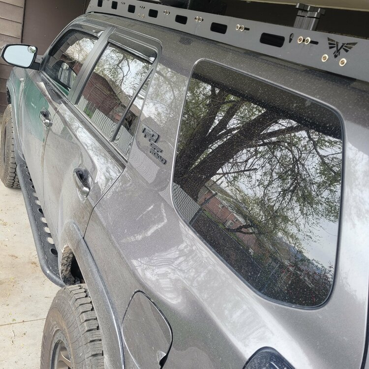

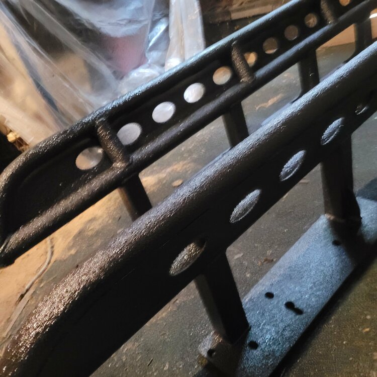

Kyblack76 Posted April 22, 2022 Author Report Posted April 22, 2022 Yerp... Playing.... also getting the RSG rocksliders raptor lined, and on. Going to Moab for the weekend. SMD SUPER SELLER The Burban Build Blazer Build sold Acura trunk build sold

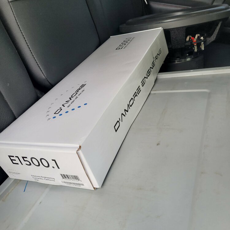

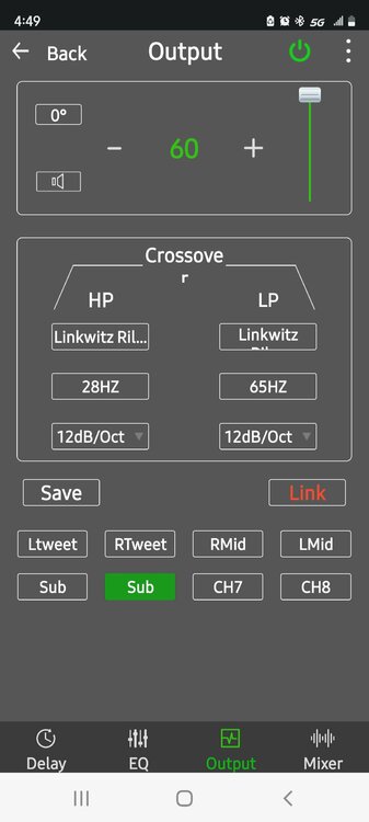

Kyblack76 Posted April 28, 2022 Author Report Posted April 28, 2022 Raptor lined my RSG rock sliders, and got them on, got the Damore 1500.1, (i traded a good dude my 1000.1 and 350.2) and got it hooked up (.5 nominal). These lil C5's get down. Play low-ish. (Those that know me, know what i think "low" is) Not bad at all. Voltage does dip here and there, so, im making a lil power, but, nothing in the least that concerns me. After working all morning on the pile, we jumped in it, and drove down to Moab. If you have never been, its beautiful. It looks like God used his finger, and made amazing formations on the earth. I use to go to Moab at least twice a year, in my 20's. Every Easter Jeep Safari for 7 years straight. Then went on a long hiatus. While this trip was fun, Moab has changed. And changed a lot. And, not in a good way. I wont be going back any time soon. Cheers. SMD SUPER SELLER The Burban Build Blazer Build sold Acura trunk build sold
