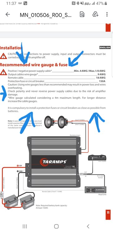

Hey I was wondering about the fuse rating on these smart 3s... Do I need a 150 amp fuse or a 300 amp fuse? Would you happen to know? I'm asking you bcuz you're who suggested this amp to me lol
Fuse for the wire rating, not necessarily any amp you’re running. I have always run a 300 on my 1/0 ofc wire, and try to use smd fuse blocks and smd fuses, since they’re pretty decent quality. Can find them on eBay
@JakeWisn't wrong, I would just do it differently.
If the amplifier was internally fused, I would do it like him (and I've seen it done a million times like that and never have an issue), but since it's not, the manufacturer recommends a 150a fuse. If anything goes wrong with the amp, Taramps can't say shit because you did everything the way it says to in the instructions. That's my mode of thinking
