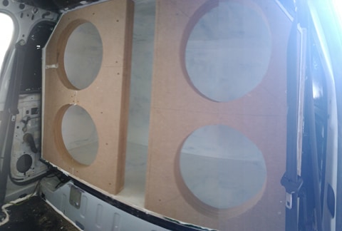

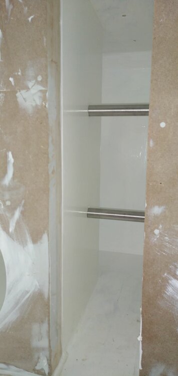

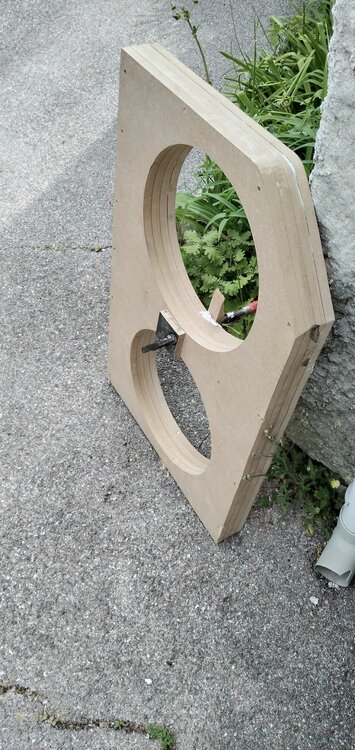

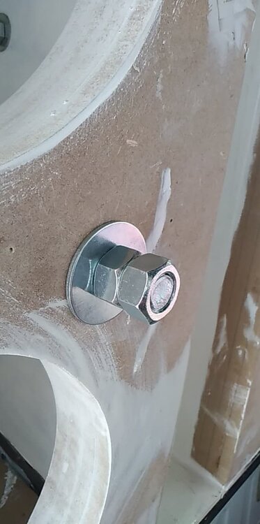

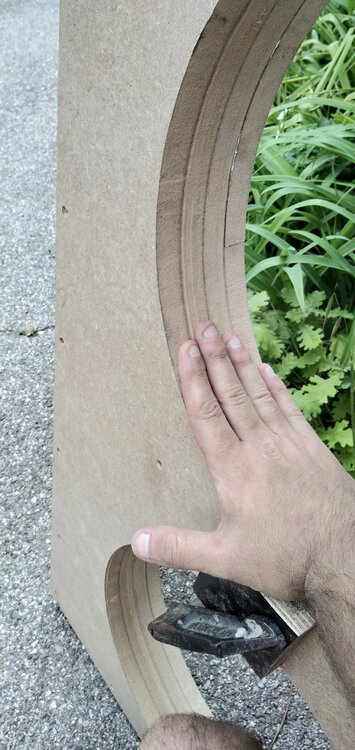

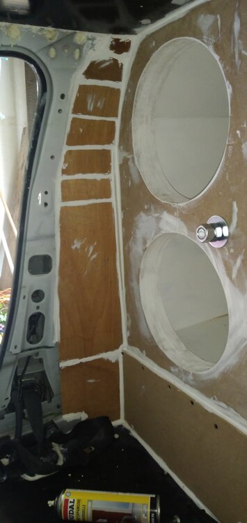

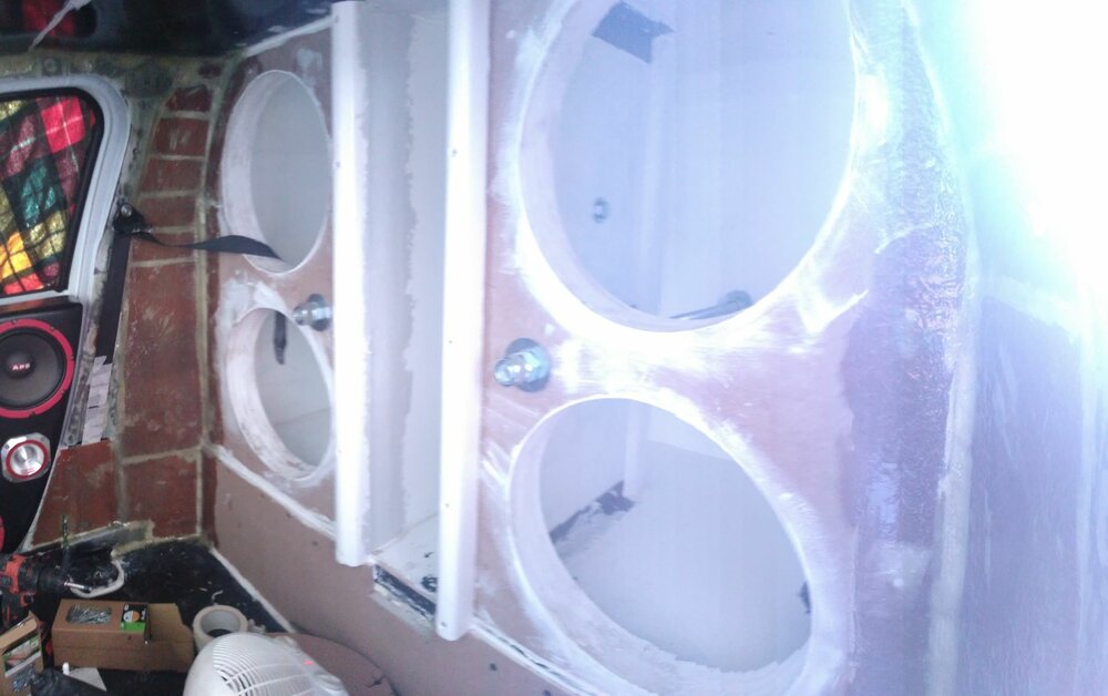

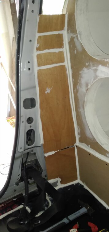

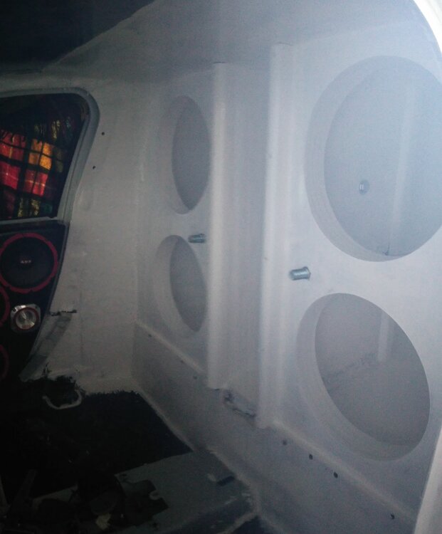

Next part, front baffle with quad layer (72mm total), then I made the port and the bracing (Side to port with M20 shaft, Front to back with M24 shaft, inside port with 2 x 30mm diameter Inox bars I made ( M16 screw through the port boards).
94399944_971075943290314_5768331160895619072_n.jpg94078299_286343959240931_2108967682664562688_n.thumb.jpg.4727290309384fe01cb5dc1250ba115e.jpg
94436057_1340864179447214_1901492862160207872_n.jpg.6970d1a643aa7cc55a1978a265c37eb1.jpg95669173_327041794935236_3144195482654343168_n.jpg

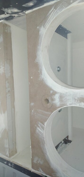

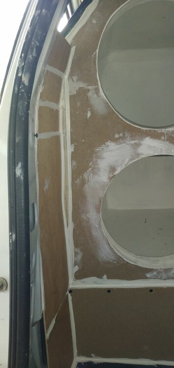

I ended with the small wood boards to seal the wall on the sides, with another board on the bottom to seal also.
I added a....can't remember how you tell that in english.... that kind of wood piece to make the port longer on the outside, in order to reduce turbulences between subs and port exit.
I also woodened the floor at the same time, idk if I already mentioned it.
Some layers of fiber glass later (to reinforce the seal on the side, and on the OEM metal parts betweet the top and the doors of the car), and after some painting, the first iteration of the box is ready.

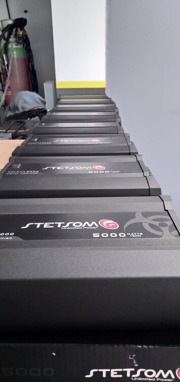

Time to move back, amps have showed up, they are.... far beyond what I expected 🤓
Not many people have done 1 amp per coil in a demo car in France, idk what people are afraid of, what's your opinion about that guys ?

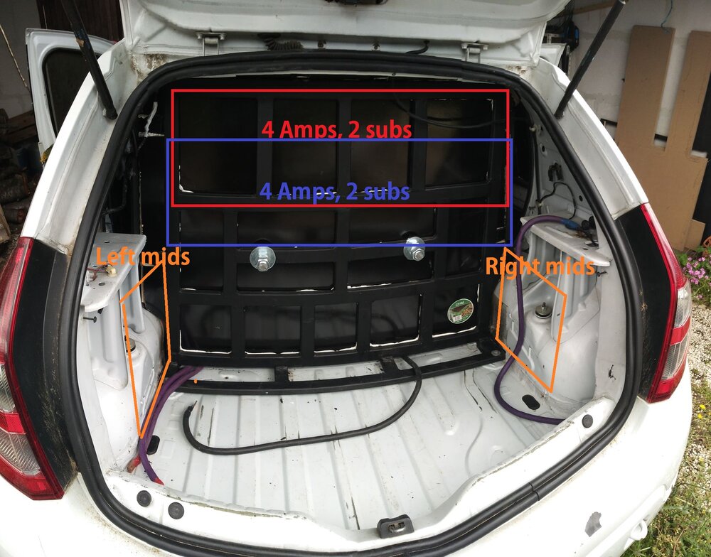

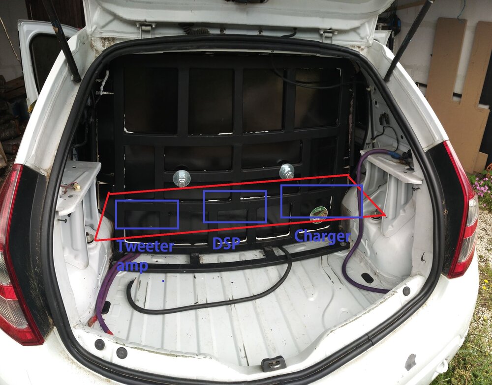

Here's the trunk, and the design I wanted for the amp + misc rack.
I wanted all the amps for the subs (8 amps) looking great, so I went for 2 racks of 4 amps.
I would have loved to add a third rack for the 2 amps for the mids, but I didn't have enought space so I put those 2 amps on the side, near the wheels.
Last, I put a kind of table at the very back of the trunk, to add an amp for tweeters, my DSP and my charger.
