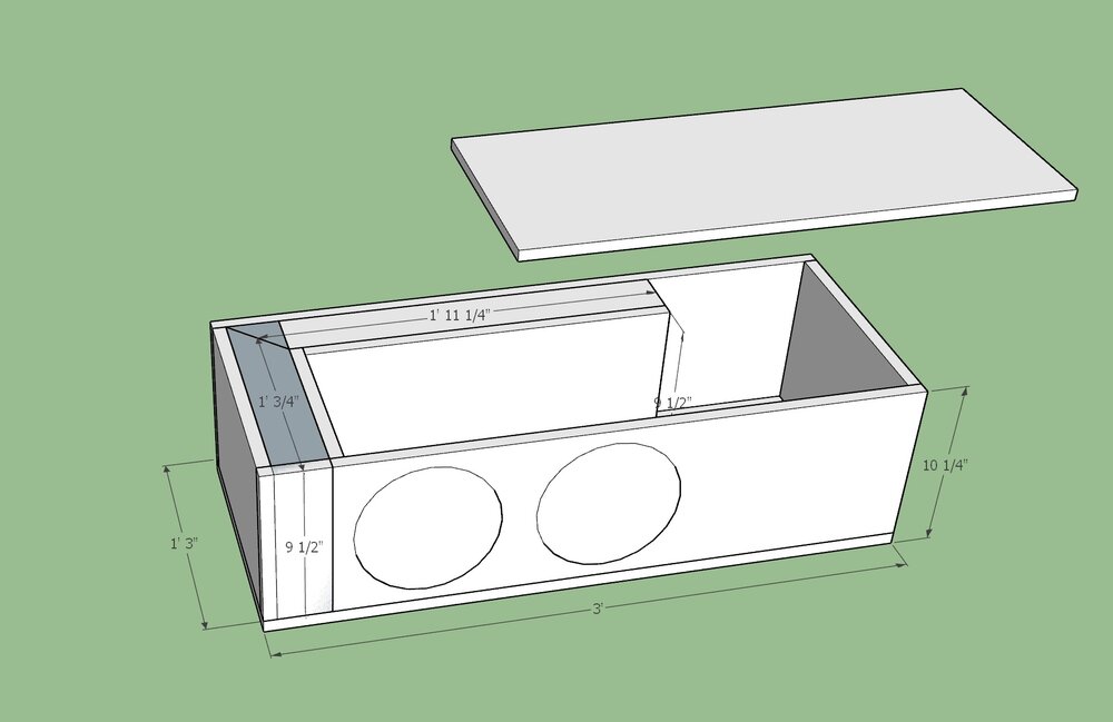

Anyhoo, all that aside, life has finally settled down enough where I can think about doing a build in the Mini.  I won 2 DC M3 8s when I won SOTM way back when (actually with a build from our 1st Mini, mine officially makes our 4th).  And I was using one as my computer sub and one just stayed in it's packaging this whole time.  Well now It's time to use em!
So I have a Smart 3k, all the appropriate electrical to support it (180amp alt, 48ah headway lithium, 2/0 ofc, etc).  Obv I don't want to throw 3k rms at 2 800 watt subs, so I'm thinking with a conservative, clean tune I should be around 1500 rms to them.
I've been doing some research and found that they love being in 0.95cu ft enclosures, tuned low so that's where I want to be.

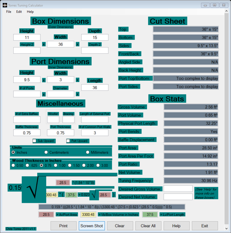

I've been farting around with torres and Triticums port calculator and think I have a decent design, but I'd like the resident box pros to weigh in and see if I'm on the right path or still a dumbass.
My max dimensions are 36" W x 15" D x 17" H
I've attached my 2nd draft with subs and port back, my first iteration had subs back port up, but I'm not sure how that'd sound in a hatchback.
So thanks in advance and glad to be back!

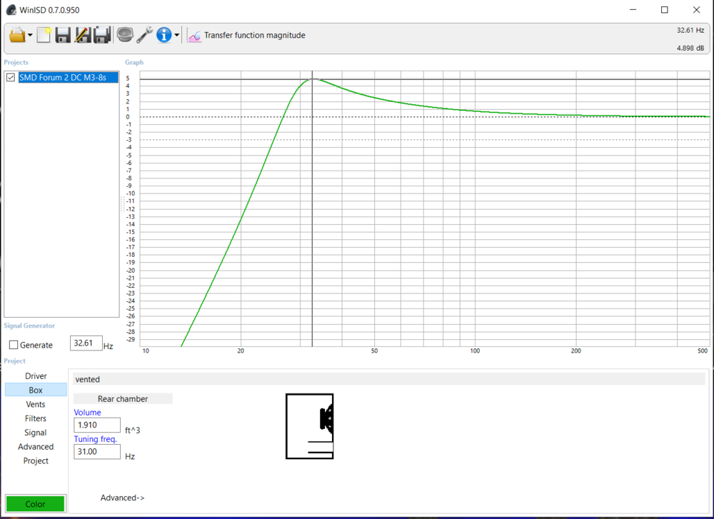

Hey bmwking,
I modeled your box up in WinISD and have a couple of thoughts.  I set the box volume to 1.91 ft^3 with a tuning frequency of 31Hz and an input wattage of 1200w (80% of your 1500w tuning target).  All of these model statistics are for the enclosure sitting on a bench, inside your Mini will of course measure a lot different (and hard to say how).  That said:
The box is REALLY peaky/loud between around ~29Hz and ~45Hz with the highest peak between 32-33Hz reaching +5db.  I normally try to stay at or under +3db for my highest peak.  That doesn't mean you have to, but at +5 the box is more in the max SPL style than SQ/daily driver and it might sound funny for daily driver listening.  Again, in the car it will have a totally different dynamic and it's possible that peak is a lot more mellow across a wider frequency band.  The f3 for the box is almost 25Hz exactly:

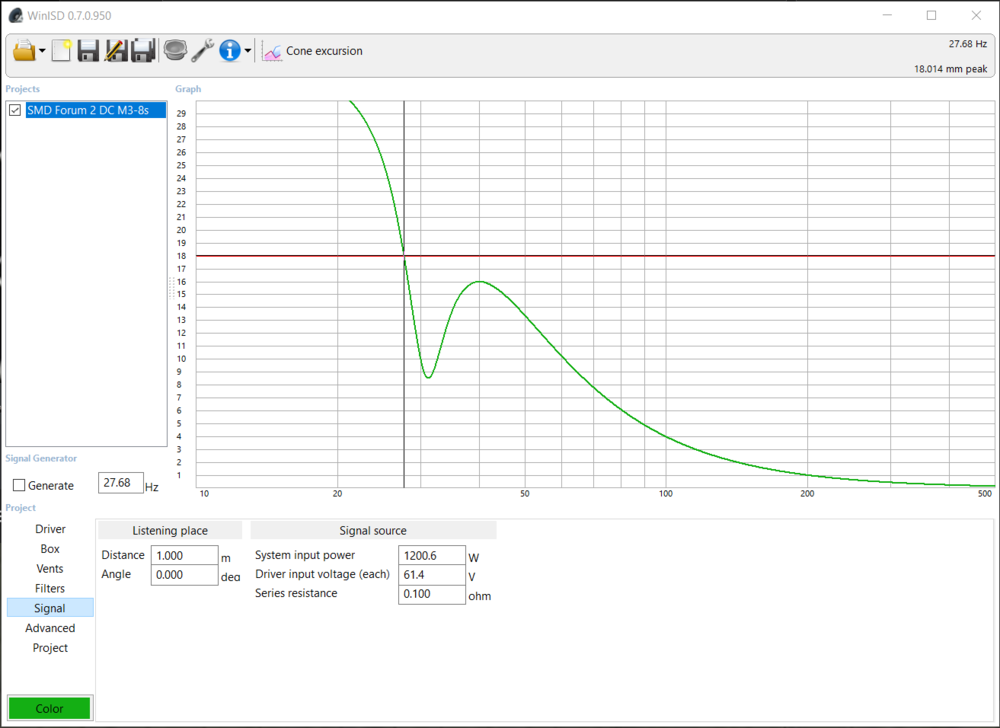

Taking a look at cone excursion, you start to run into the danger zone between 27-28Hz so you would want to set your infrasonic/subsonic filter above that (probably just set it at 30Hz assuming a 24db/octave crossover slope):

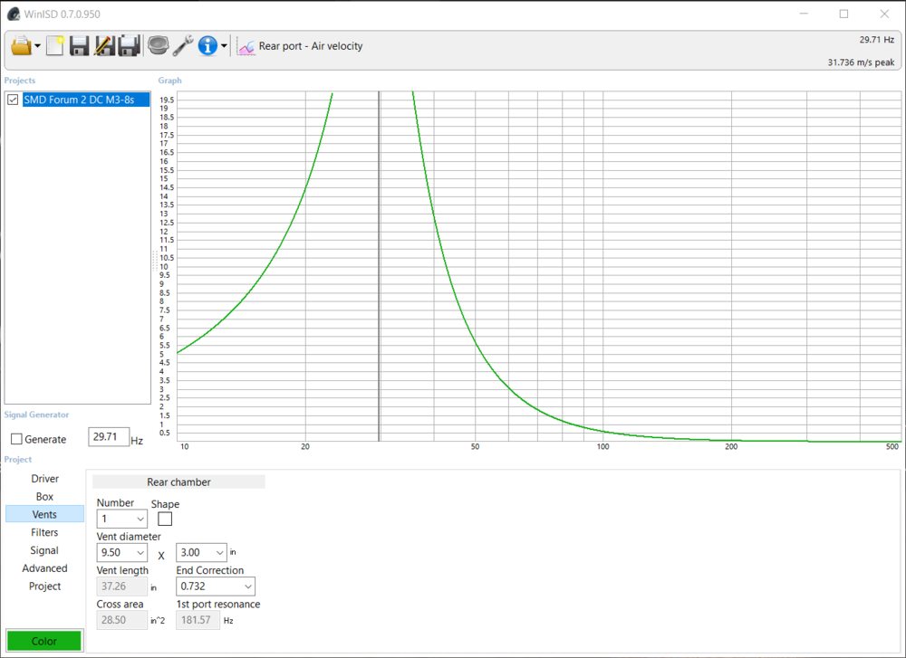

I didn't see the port width in your diagram above, but playing around it looks like 3" width was close to your calculations.  At 9.5" high and 3" wide with a 31Hz tuning frequency it clocks in at just over 37 1/4" long.  The biggest "problem" I see with this box design is that the port air velocity peaks at almost 32 meters/second (at around 30Hz).  The "best practice" is to try and keep it under 16-18 meters/second.  Much over that and the port will be very noisy, causing "port chuffing".  Chuffing isn't as big a concern when the box is in a trunk, but in your Mini it could easily be audible.  You can get around that to an extent with a flared port, but that would mean kerfing the port wall(s) for a slotted port or switching over to a flared round port that would then need elbows to get the full length:
Hopefully this helps some.  If you want, I can try to play around with the modeling to get the port air velocity down and/or lower/even out the frequency output peaks.
