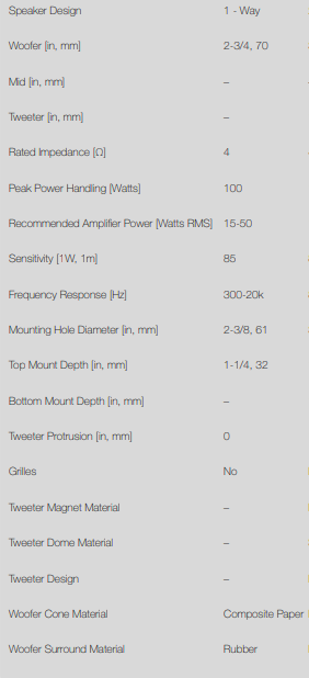

Zori.L83 Posted June 5, 2021 Author Report Posted June 5, 2021 On 6/2/2021 at 1:24 PM, nauc said: did you set your amp gains right? heres how. the test tones are at the very bottom.... https://jlaudio.zendesk.com/hc/en-us/articles/204374120-Amplifier-Level-Setting-Guide Yeah the B2's right now are the best they are gonna get. The kicker KS did not work out so I'm in the process of returning them. I have a quick question. My factory dash speakers are not there anymore leaving a spot open for adding a 2-3/4in speaker in there. I'm thinking of getting a small 2-channel amp to power them. Something like a 30-50 watt per channel type of deal. If i was to add another mids and highs amp along with my current 4 channel, how would I get RCA signal to it from my headunit? My 4 channel now has a "preamp" output for the RCA's. Do I use that?
Arthur79 Posted June 5, 2021 Report Posted June 5, 2021 11 hours ago, Zori.L83 said: Yeah the B2's right now are the best they are gonna get. The kicker KS did not work out so I'm in the process of returning them. I have a quick question. My factory dash speakers are not there anymore leaving a spot open for adding a 2-3/4in speaker in there. I'm thinking of getting a small 2-channel amp to power them. Something like a 30-50 watt per channel type of deal. If i was to add another mids and highs amp along with my current 4 channel, how would I get RCA signal to it from my headunit? My 4 channel now has a "preamp" output for the RCA's. Do I use that? Yes! Most modern amplifiers have a set of "preamp" outputs, that is passing the signal from the RCA inputs of the amplifier so you can add additional amplifiers. You just need to run a pair of RCAs from the output side of your 4-channel to the RCA inputs of the 2 channel amp and you will have signal. You will still need to set the crossovers on the 2-channel amp. If you have a 2-3/4 inch factory location, you could likely fit a compression horn tweeter in that spot. Horns can definitely get loud....
Zori.L83 Posted June 5, 2021 Author Report Posted June 5, 2021 1 hour ago, Arthur79 said: Yes! Most modern amplifiers have a set of "preamp" outputs, that is passing the signal from the RCA inputs of the amplifier so you can add additional amplifiers. You just need to run a pair of RCAs from the output side of your 4-channel to the RCA inputs of the 2 channel amp and you will have signal. You will still need to set the crossovers on the 2-channel amp. If you have a 2-3/4 inch factory location, you could likely fit a compression horn tweeter in that spot. Horns can definitely get loud.... Perfect! I just needed that confirmation from the pros before I did anything. As for the tweeter, I have a 2015 Silverado so the mounting depth in that area is the biggest issue with these trucks. I dont want to cut anything out or modify. Apparently the Kicker KS also has the 3-way option that comes with a midrange driver. The KS I got was just the 2-way and it didnt come with that but that midrange driver is the perfect direct fit in the dash. Thats one of my options but I want to do something like a Super Tweeter instead of that. My goal for the dash is to hear more of the melodies and lyrics of a song. What speaker and amp combo would you recommend? Sorry if this is a dumb question. Im relatively new to car audio lol. These are the specs for the Kicker KS Midrange
Dafaseles Posted June 5, 2021 Report Posted June 5, 2021 So, I you're going to go with 3 different size drivers (6.5", 3", and a tweeter) either get a 3 way setup with a passive crossover, or you're going to want to go fully active. If you have the 6.5's and the 3's crossed over at the same points, and playing the same notes, you're going to have blending issues (random peaks and valleys in your frequency response) and cancellation issues (when the speakers are out of phase and the sound waves are sort of fighting each other). So keep that in mind. What exactly are you looking for in your sound? More of the super high frequencies a tweeter plays? More of the lyrics and voice a 6.5" usually plays? Or just louder all around? 2011 Chevy Silverado under construction My build log here. Check it out!
Zori.L83 Posted June 6, 2021 Author Report Posted June 6, 2021 17 hours ago, Dafaseles said: So, I you're going to go with 3 different size drivers (6.5", 3", and a tweeter) either get a 3 way setup with a passive crossover, or you're going to want to go fully active. If you have the 6.5's and the 3's crossed over at the same points, and playing the same notes, you're going to have blending issues (random peaks and valleys in your frequency response) and cancellation issues (when the speakers are out of phase and the sound waves are sort of fighting each other). So keep that in mind. What exactly are you looking for in your sound? More of the super high frequencies a tweeter plays? More of the lyrics and voice a 6.5" usually plays? Or just louder all around? Well im looking to make the mids and highs louder because the bass takes over those and my subs are 2k watts which are rookie numbers compared to you guys lol. If I double up on speakers I have to modify or fab some things up which Im trying to avoid. If I was to add some mids in that and hook it up to another amp will the blending be really bad? Technically, those mids are gonna be ran active, im pretty sure with some tuning on the new amp it can sound decent.
