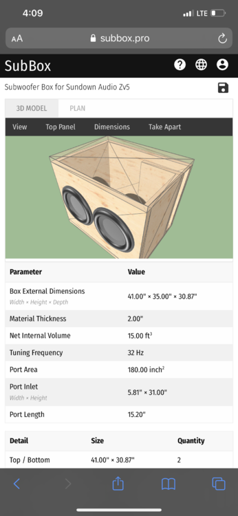

How does this design look? Only thing I want to change is have the port on the front panel with the subs going along the top of the box. That’s all the space I have to work with unless I want to make the box go deeper into the trunk but the height would taper off dramatically and I don’t know how that would effect everything.
